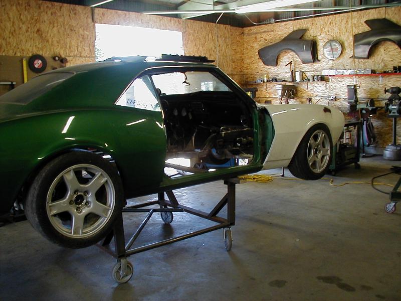

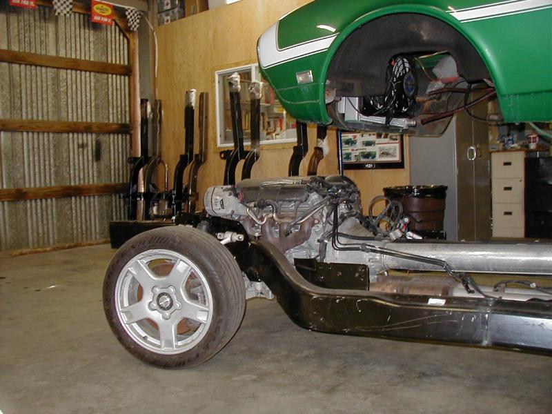

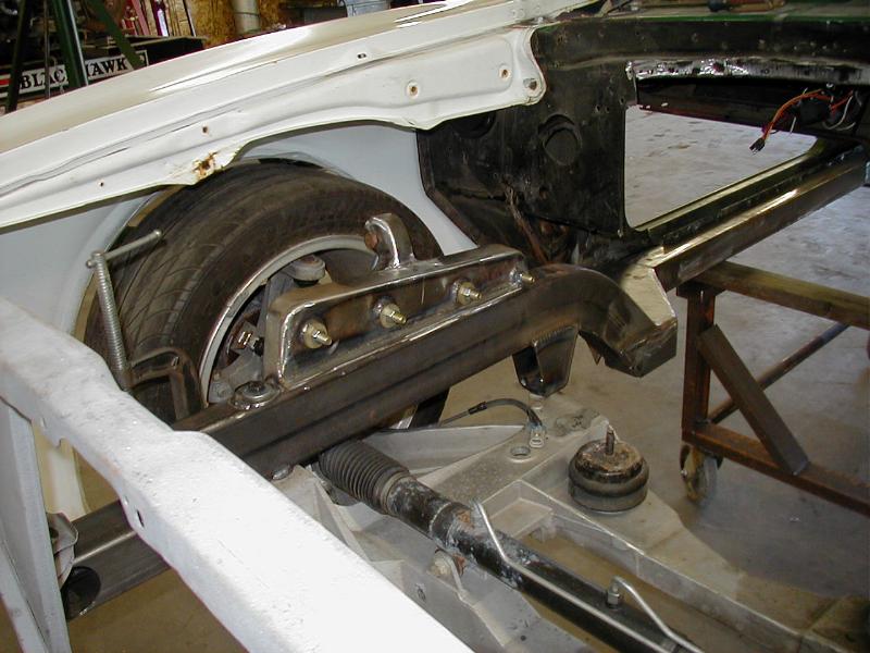

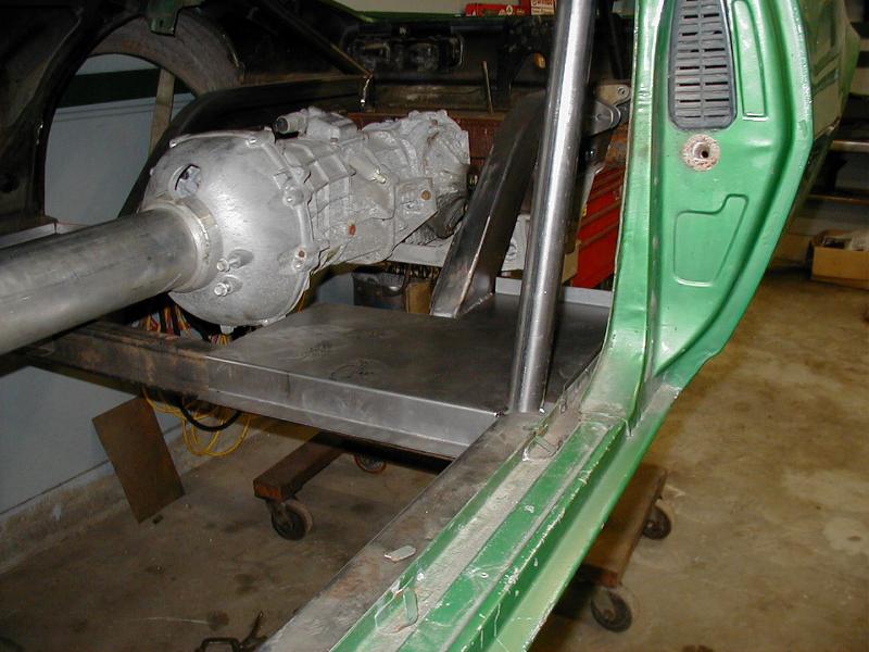

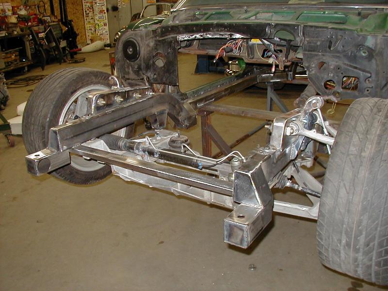

Frame: Custom built by Wayne Due full framed 68 Camaro chassis with
97 front Corvette suspension, and 97 C5 Trans axle IRS out back.
Suspension: (front) 1997 Corvette upper and lower A-arms and
spindles. Coil over shocks, and 1� sway bar. (rear) 97 Corvette IRS
with upper and lower A-arms, coil over shocks, hubs, and differential.
Steering: 97 Corvette power steering Rack and Pinion
Brakes: Front- Baer 14� 2pc rotor, slotted/cross drilled,
Alcon 6 piston monoblock caliper on 1997 C5 corvette hub, ABS sensor,
Rear- Baer 13.5� 2pc rotor, slotted/ cross drilled, Alcon 4 piston
monoblock caliper on 1997 C5 Corvette hub, ABS sensor, Pedal assembly-
Tilton floor mount dual master cylinder and clutch assembly with
adjustable front to rear Z-bar, Assists- 1997 C5 Corvette factory
ABS, Hydraulics- Tilton 1� master cylinders (x2)
Exhaust: Custom built 1-5/8� primary tube headers to twin
turbochargers, to a 3� down pipe exiting in front of rear tires, on side,
located in custom rocker panel extension.

Transmission: 97 T56 Corvette transaxle with after market
differential using a 3.73 gear
