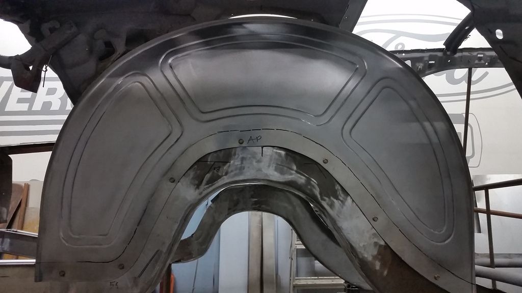

Like I told, been doing a lot of this. But had a long pause.
Now been doing more. Here is some of the latest.
Wheel tub wall to my "Project Plan Bee"
3 step and half of the round edge. Other half is in tub side. Seam in the middle of the radius.
Sing to my friends HD.
Birthday presents
Just need to practice and repeat.
I will start posting about my Plan bee when I got more done.
For those who are interested, search "project_plan_bee" at Instagram
