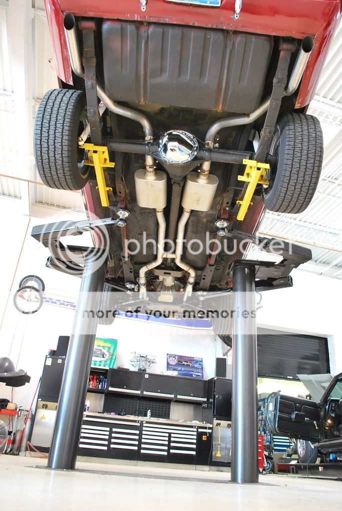

Here is a 69 Camaro that we started a few months back for a local customer. He brought in a driver quality car and wanted to really take it to the next level. Unhappy with the ride, the power, the interior, or exterior, the plan was for a complete overhaul to bring the car up to today's standards. Not a full blown track car, but something that he could drive across country comfortably and still be in contention at local auto-X events.
Still in the planning phase on a lot of things, but here are the basics to get started.
Roadster Shop Fast Track Chassis System
14" Wilwoods
D/A Afco coilovers
550-600 HP LS3
T-56 Magnum trans
18's and 20's
Several subtle body mods
All black with matte black and red accents
Original car
