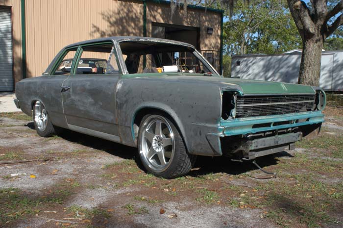

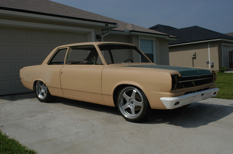

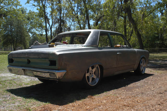

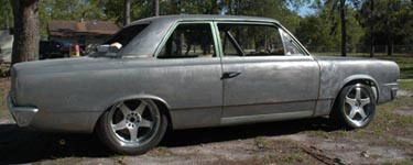

1969 AMC RAMBLER AMERICAN 2DR SEDAN
Wheels TBD, sizes:  18x8.5 and 18x9.5
Tires, Front - 255/35/18 Rear - 275/40/18

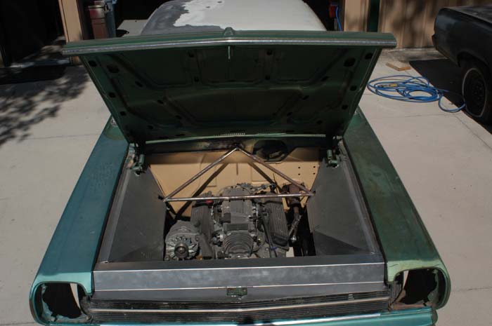

Engine - LS1
Trans - 4L60E
Cooling - Walker Dual Fan kit, Aluminum radiator w/ dual 1 1/4 tubes, Trans cooler

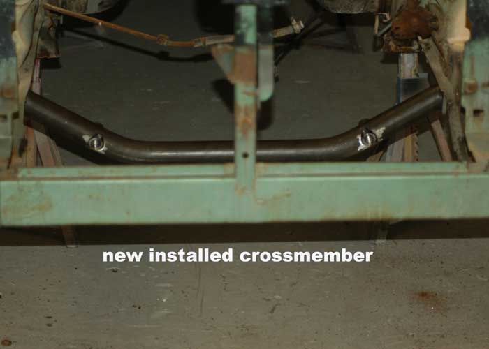

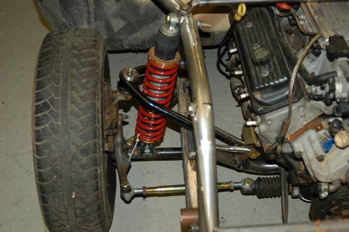

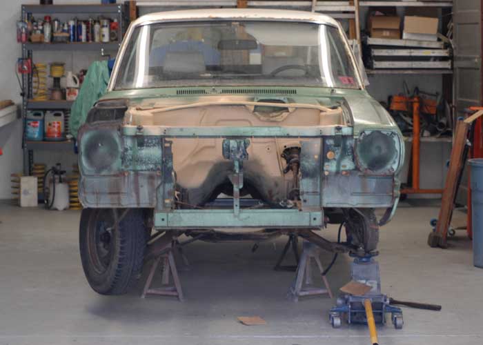

Suspension, Front - Custom built by Jimmy Britts, tube crossmember that
bolts in stock location, late model race car upper control arms with screw in

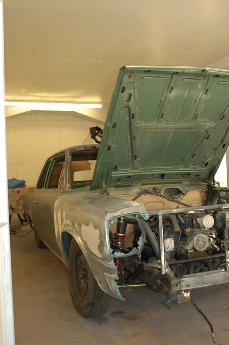

ball joints, Manual race rack and pinion. Fabbed lower control arms with screw in ball joints attached to crossmember with heim ends, also have strut rod with clevis attached to outer a-arm and mount to frame with heim end. Eibach springs, Carrera coilovers, AMC disc spindles

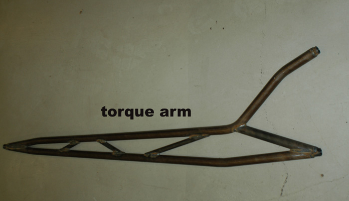

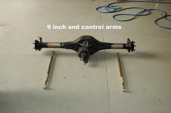

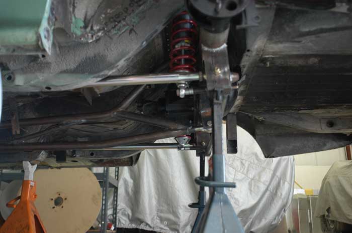

Rear - Custom fabbed torque arm w/adjustable ends, adjustable lower control arms, Carrera coil overs and Eibach springs attached to a Mike Britts narrowed 9 inch with 370 gears and posi, Camaro disc brakes

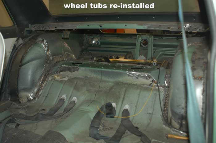

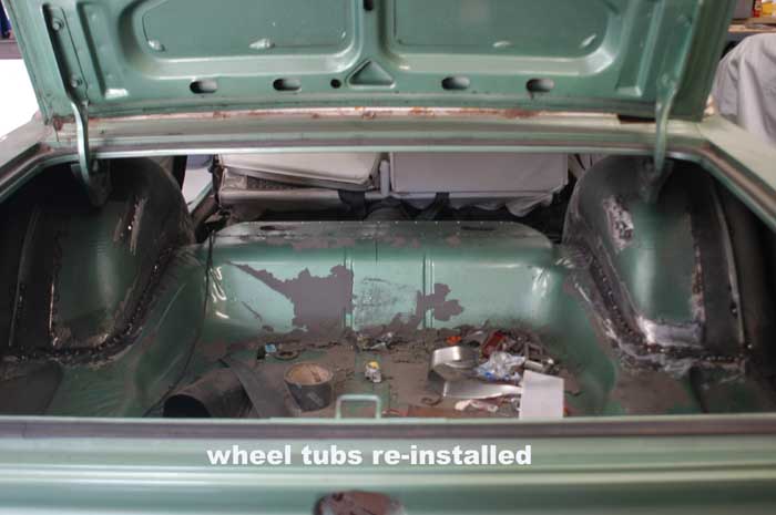

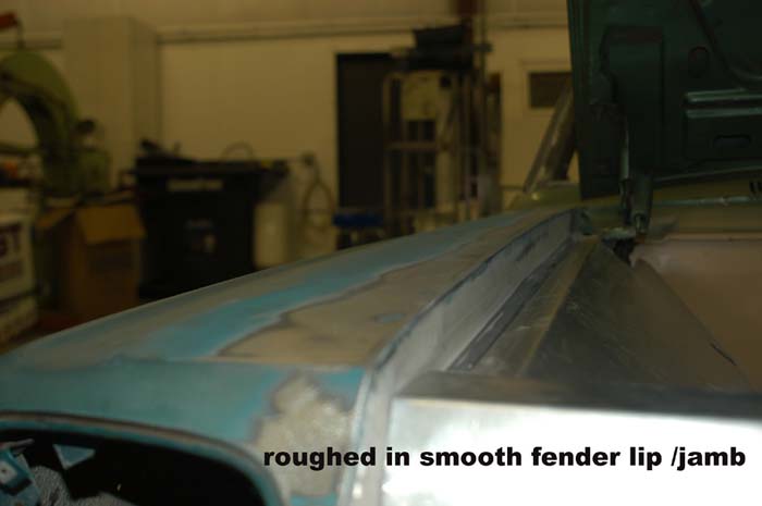

Body - Side markers, reflectors and emblems removed, Mini tubbed, custom aluminum inner fenders and core support covers
NOS parts ... headlamp bezels and driver remote control stock mirror

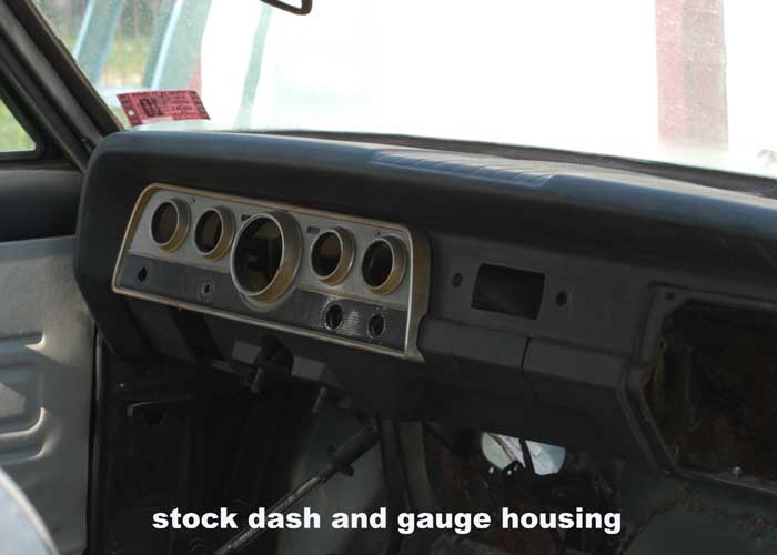

Gauges - Autometer Phantom series
