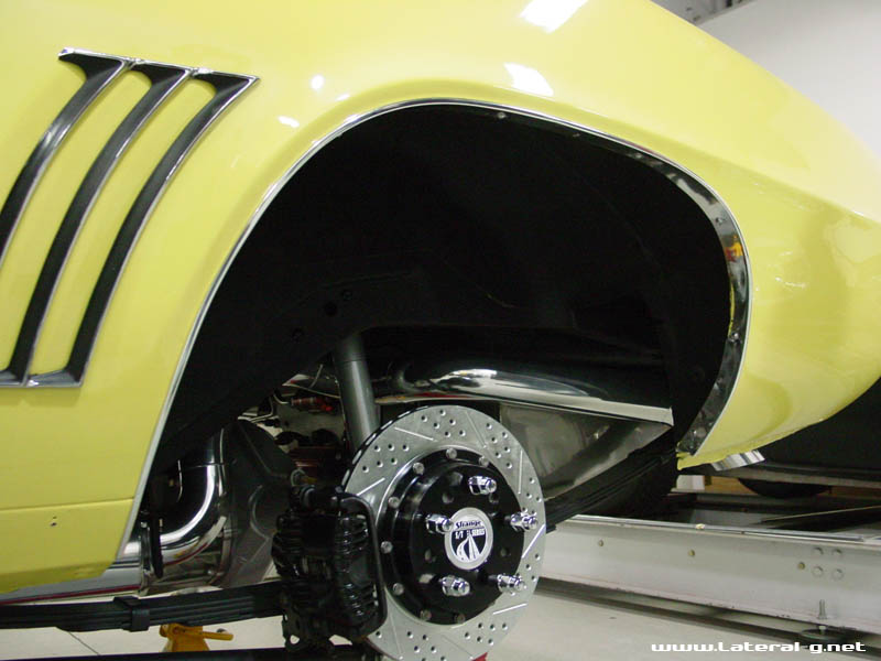

history. The first thing Jody did was to convert the Yenko block to FAST EFI,
add a 2004R in place of the TH400, and add Baer brakes and 17" Torque Thrust
wheels with Eagle F1's. With this combination, it laid down 485 rwhp and almost

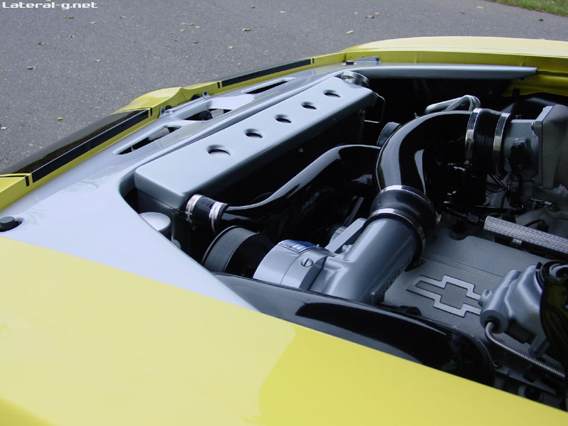

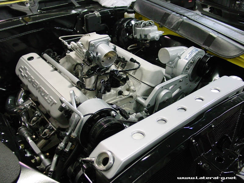

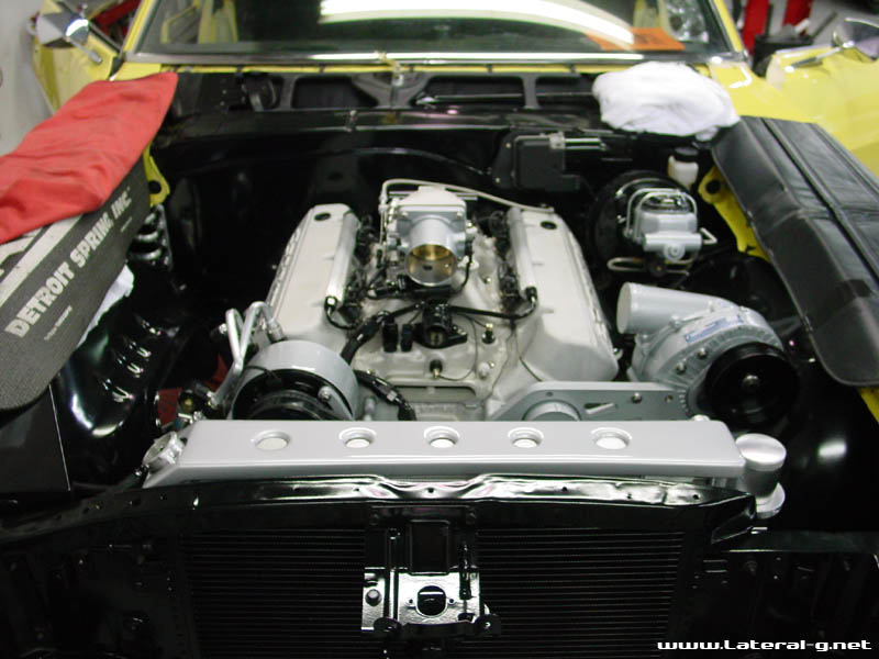

Soon after, the "more power" bug once hit Jody. With his experienced background
with centrifugal superchargers, he bought one for the Yenko 468. The motor came
out and Jody added all the usual blower-specific goodies inside the engine. This
setup made 720 rwhp at only 5500 rpm, shutting off the Dynapack chassis dyno for
exceeding it's torque range. At that point, Jody knew it was making too much

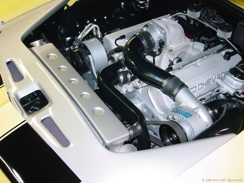

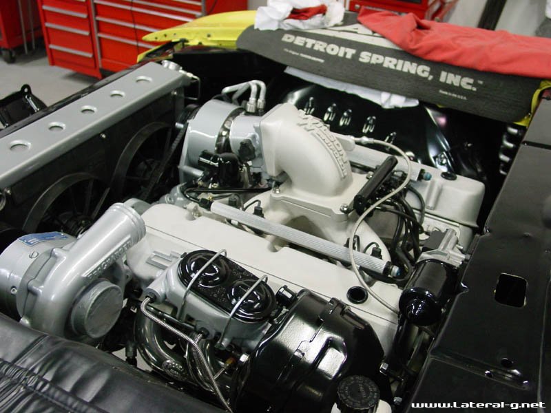

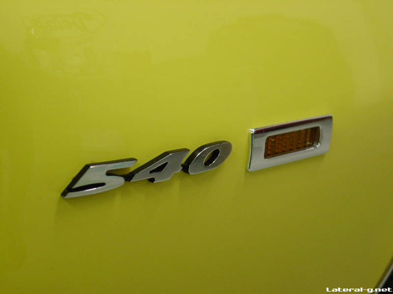

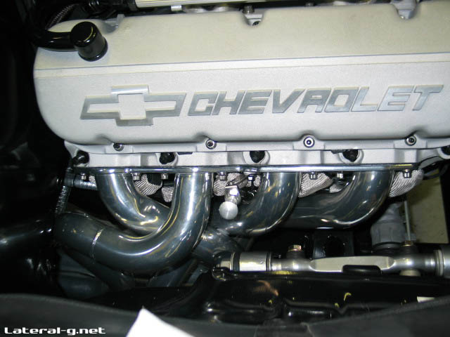

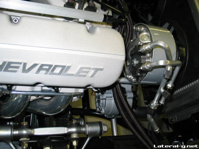

With the Arias, the sky was the limit. It had a 4.5" bore and 4.25" stroke to

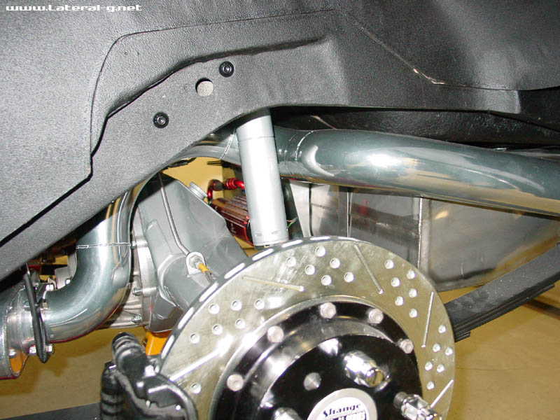

create a monster 540 cubic inch motor. While the engine was out, Jody picked up

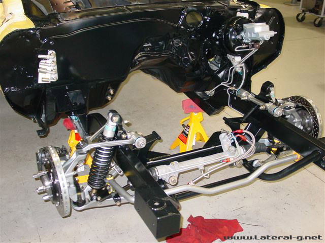

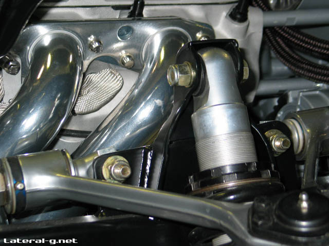

a Wayne Due C4 based front subframe. Once it was all back together, the
ProCharged Arias 540 swallowed the lockup convertor in the 2004R. It was obvious
that it needed a stout transmission, so Jody installed a Tremec TKO with a twin
disc oval-track clutch. The car put down 804 rwhp with only 11 psi of boost.

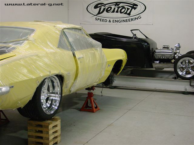

interior, or move on to the next build project. He decided to sell it to Stuart

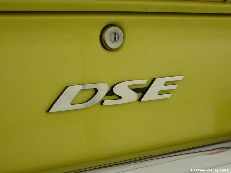

Adams. Stuart sent the car to Detroit Speed and Engineering for a major massage.
Jody built a beast, and Stuart set out to give it some manners.

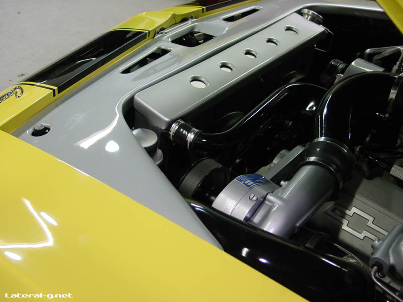

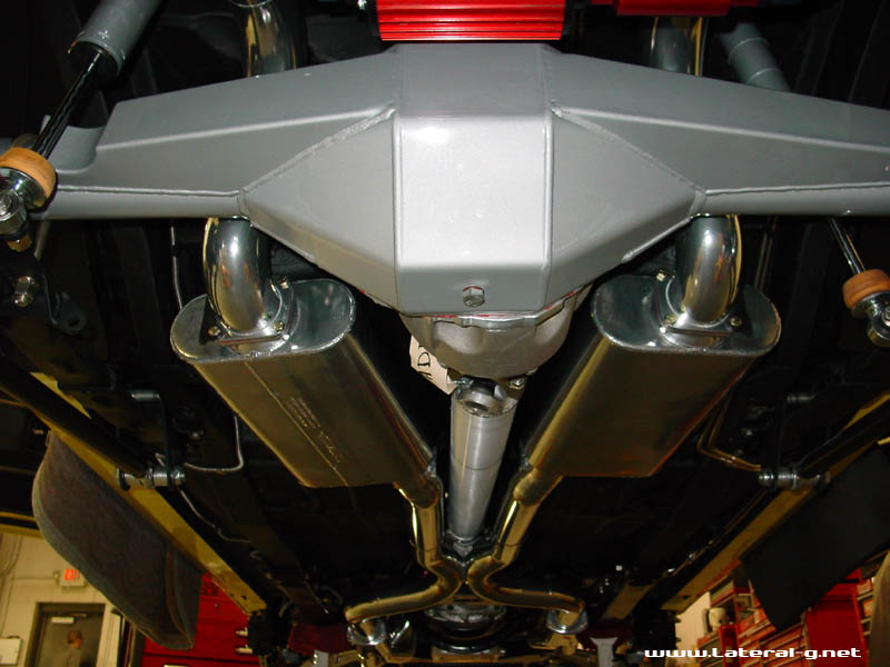

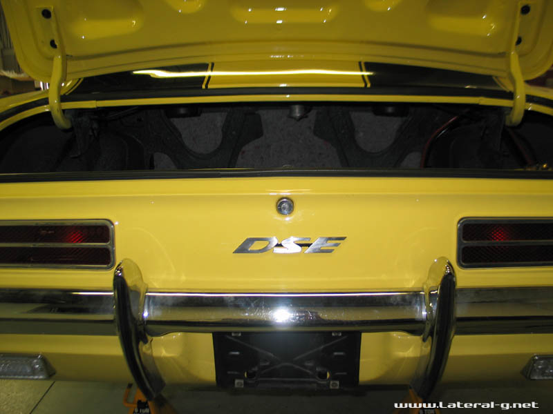

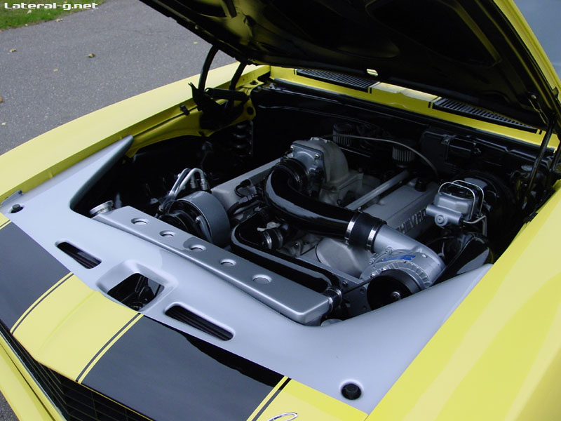

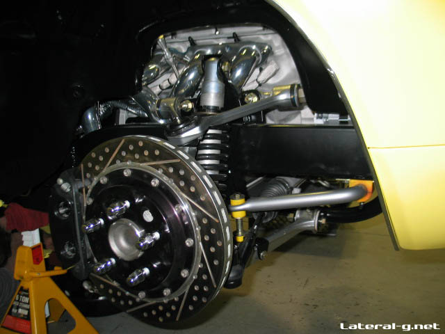

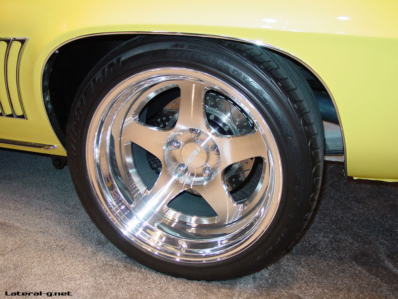

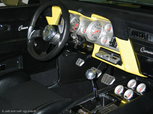

DSE mini-tubbed the car and fitted up a set of 18" Fikse FM5 wheels. They also
added their fabricated metal instrument carrier with AutoMeter gauges. The
engine compartment was fitted with a handmade close-out panel that can now be
ordered directly from DSE.

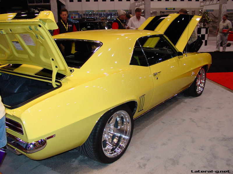

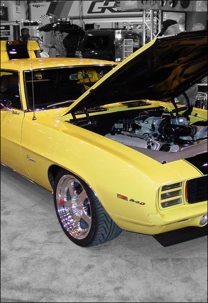

The Alumin8r debuted at SEMA 2005 in the Optima Batteries booth. It was, without
a doubt, the best representation of a GM Muscle Car at the Show that year.
