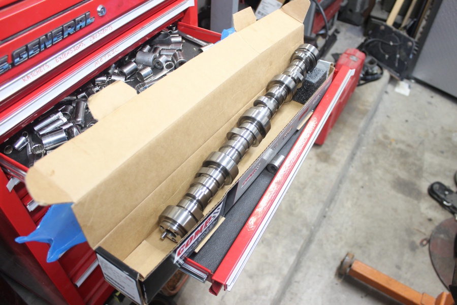

A few days later we had new parts at our doorstep. Camshaft No. 54-457-11, Spring Kit No. 26926TS-KIT, and BSR Shaft Rocker System No. 1981-16. The camshaft’s operating range is from 1,700-6,800 RPM’s and features a .610 intake and .617 exhaust lobes with 112 degrees of separation.

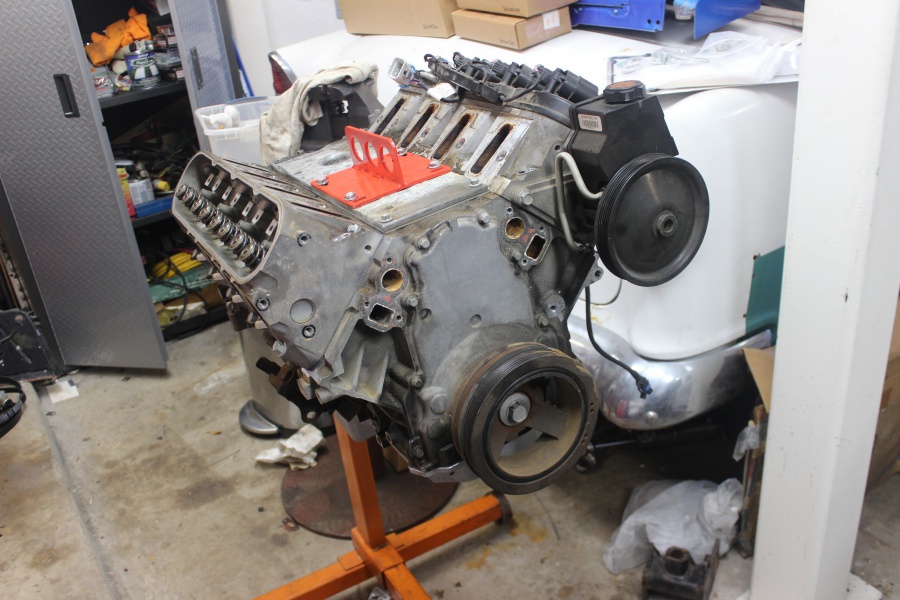

We had the engine pretty well torn apart at this point. The head was off and the old rod and piston were out. We started there first, installing the piston onto the new rod, then installing that onto the crankshaft. From there, we put the head back on using OEM torque-to-yield bolts. Then the fun part came, installing the new camshaft and parts.

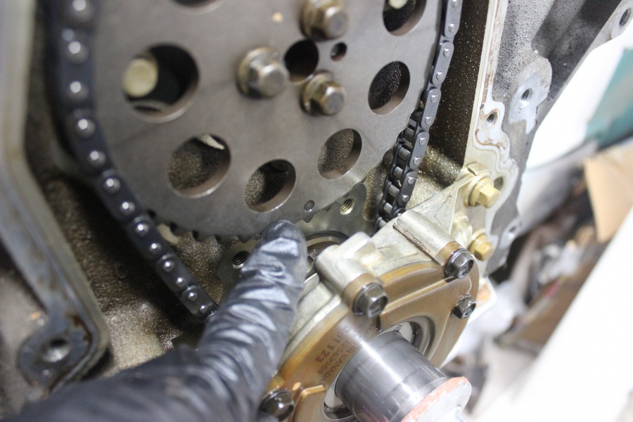

In order to access the camshaft, we had to remove the crankshaft pulley. This required us to rent a puller tool from our local auto parts store. With that off, we removed the timing cover along with the cam sprocket after making sure to line up the dots on it with the crank sprocket.

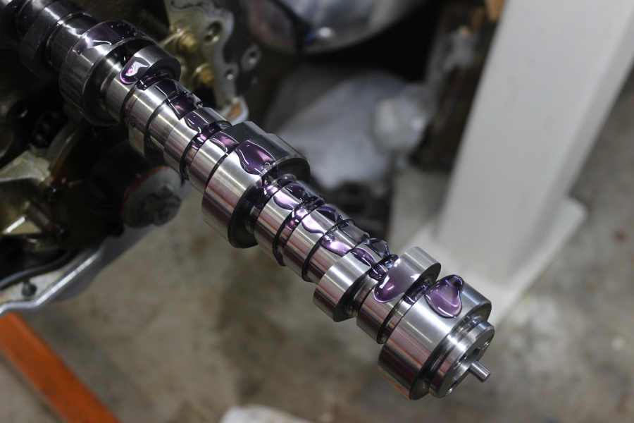

Before installing the new COMP Cam, we applied a copious amount of assembly lube to it, then slid it into place. From there we reinstalled the cam sprocket and timing chain cover. On the top end, it was time to install the new valve springs and rockers.

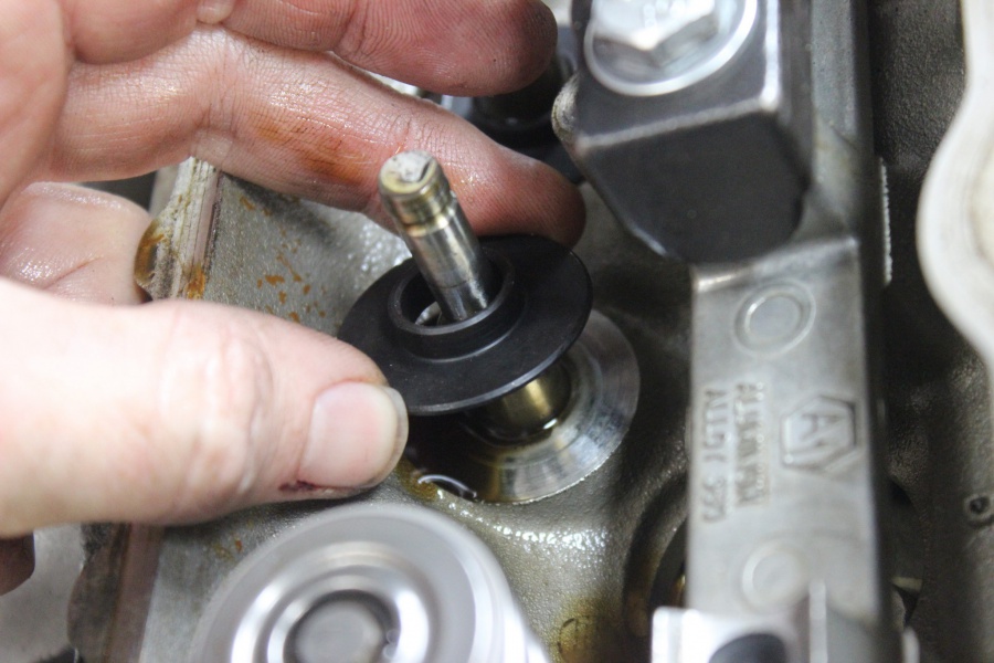

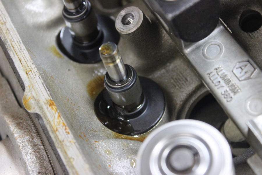

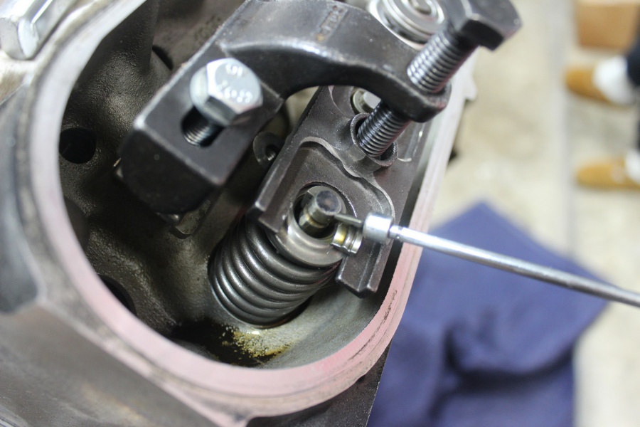

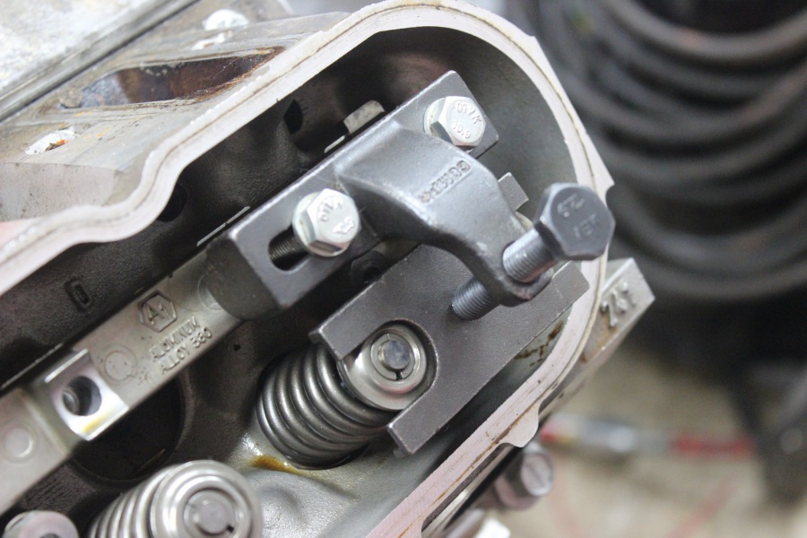

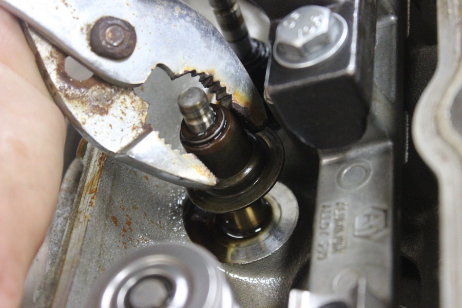

The first step is to ensure the cylinder we were replacing the springs on is at Top-Dead-Center so the valves wouldn’t fall into the cylinder. Then we used another slick tool we got from COMP a few years back, an LS Valve Spring Compressor. This tool mounts with two bolts and compresses both intake and exhaust valve springs at once. After removing the valve retainers, we slowly released pressure and removed the factory springs. Under the springs is a valve seat/valve seal that we removed.

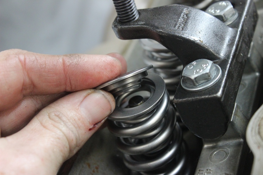

Then the new COMP Cams seat and valve seals along with the dual valve springs. Using the compressor again, we compressed the springs and installed the retainers before removing the compressor a final time. Then we repeated the process seven more times to get all the springs changed out.

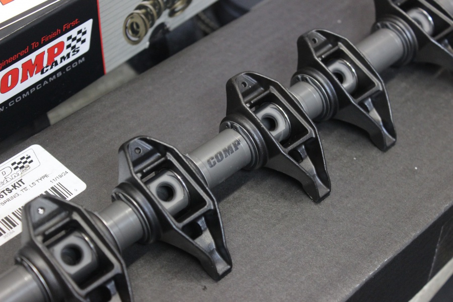

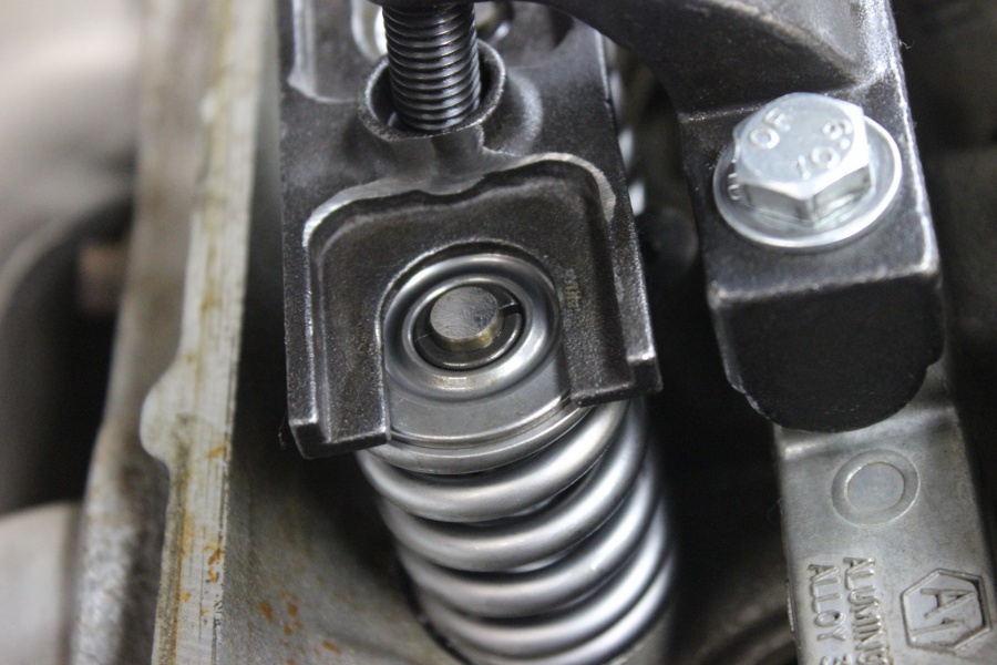

The last step is to install the new COMP BSR shaft rockers. These eliminate the failure-prone needle bearings of the factory rocker arms and strengthen the entire assembly. Installation is insanely easy for them too. After setting the pushrods back into place, you simply set the entire rocker assembly into place. We ran the bolts down and then torqued down accordingly.
