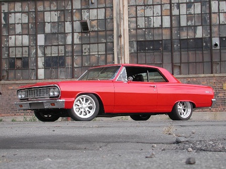

Malitude was originally built by Mark Stielow. Very cool
car that he sold to a friend and he sold it to me. I was originally just going to do a simple re-paint to fix some
issues, but things soon changed. :)
There is a huge advantage buying a car built from Mark Stielow............. you get all the hard work and engineer-
ing already done! He had already done the minitub and
frame mods, and had sorted out the suspension. All I
had to do was clean everything up, have a few items re-powdercoated, and bolt them right back on the car.
Since I had the car apart and was going to change the engine and wheels, I decided a color change was also
on the list. Not a huge fan of red, and since I was
changing enough that nobody would know the car was
the same one Mark built, I decided to do it the way I
wanted it.

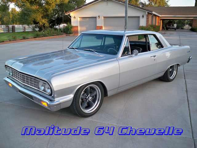

I had a twin turbo LS2 sitting in my shop, a leftover from
a previous project.Since I had to pull the car completely
apart to paint it, I might as well swap over to the modern
LS engine, right? So I sold the twin turbo small block the
car came with, and started the installation of the LS. I wanted to keep the 4L80E trans the car came with, so
a simple spacer and flexplate swap mated that up to
the LS engine.
We can add more text here. As I was deciding what motor/trans/ wheels to go with i sent the car to the body shop where Keith and his brother Steve did all the body work K&M AUTOKRAFT did the body and labored 300
hours into the once rust free original panel car. I had
them shave the rain gutters fill in all side marker open-
ings all factory seams and antenna hole. I had all the
gaps and panels spaced evenly. then I choose a ford
gt-40 color for my paint. a ghost stripe was also added on
the tail for that extra touch. Once back from body I bought a set of corbeau gtIII seats and had them recovered to match the factory pattern in white and the rears followed. I had all the plastic, chrome and headliner redone. I dynamatted the entire interior before i installed the original gauge cluster that redline gauge works redid for me. They converted my amp gauge to a volt gauge and installed a tach for me. They also refinished my gauges in white. Soon after i had the suspension done by Al's performance. They installed my bear brakes front and rear, hotchkis sway bars, tubular upper controls arms from Firm Feel, I had Paul from hydratech set me up with a hydroboost system for the car as well. All new bushings and shocks were installed. I had them powder coat the entire suspension and k member.
