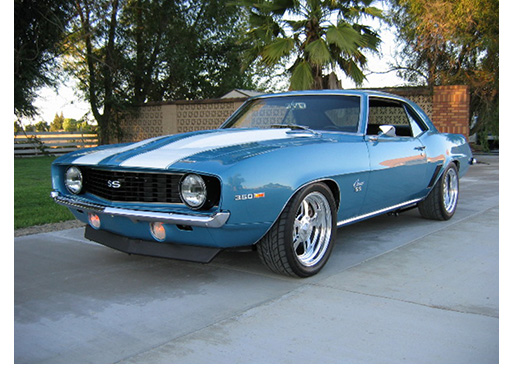

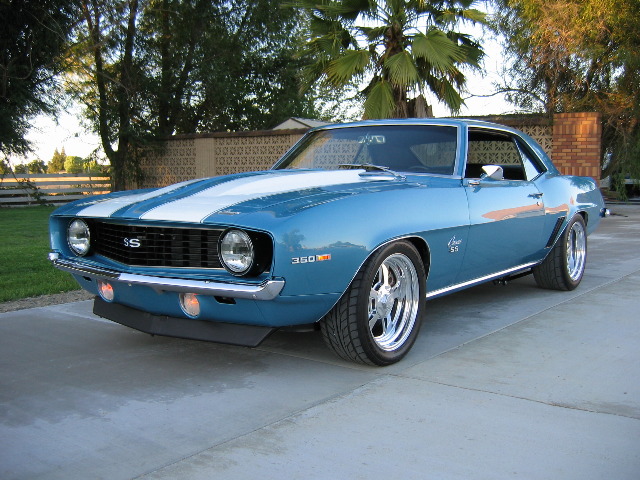

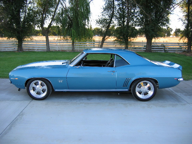

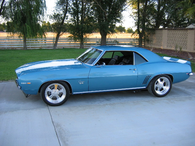

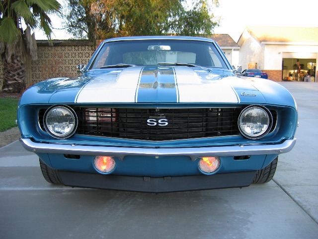

Don Estels 69 Camaro                                                                                      Lateral-g.net Feature Car
69 SS Camaro Marina Blue

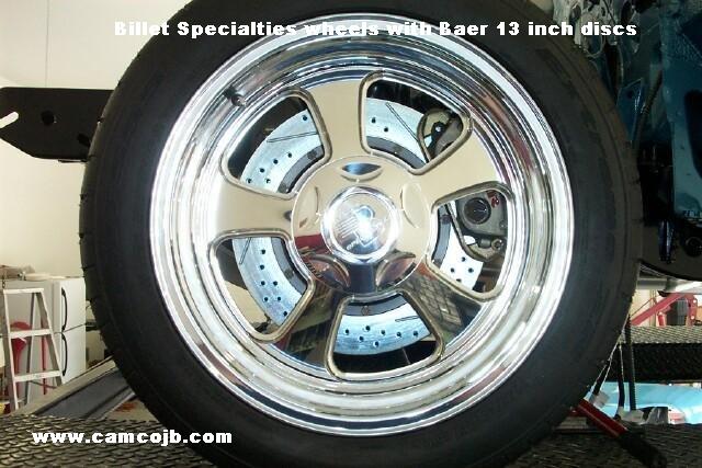

Billet Specialties Vintec wheels 17X8" (4.75" b.s.) with 245/45 Nittos on front
17X9.5" (5.5" b.s.) with 275/40 Nitto drag radials on rear

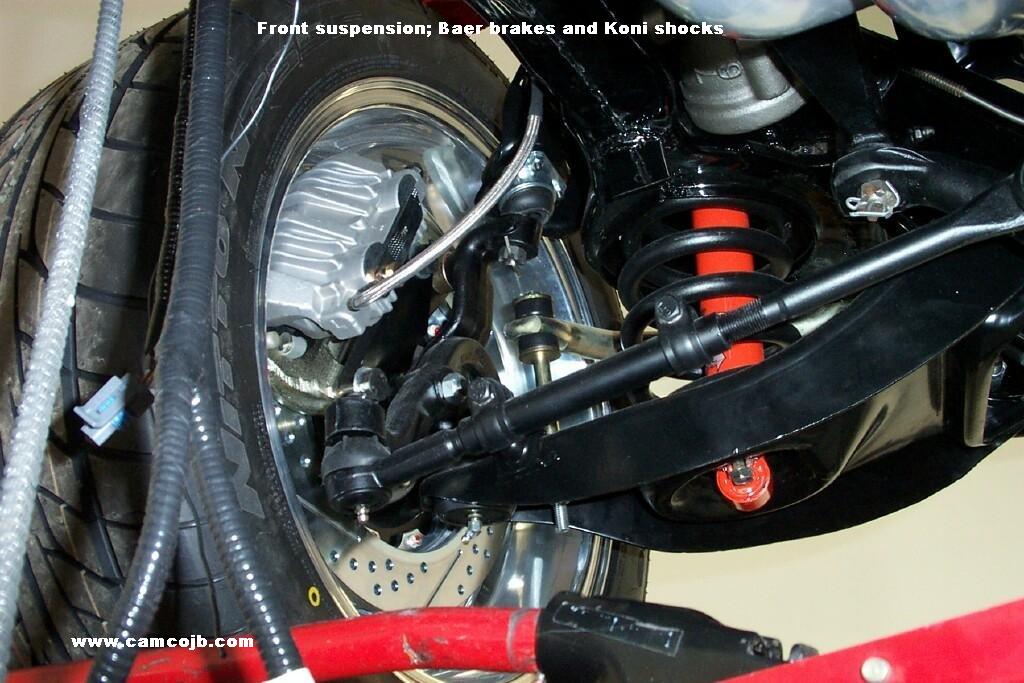

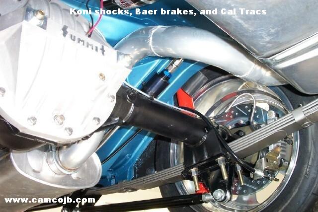

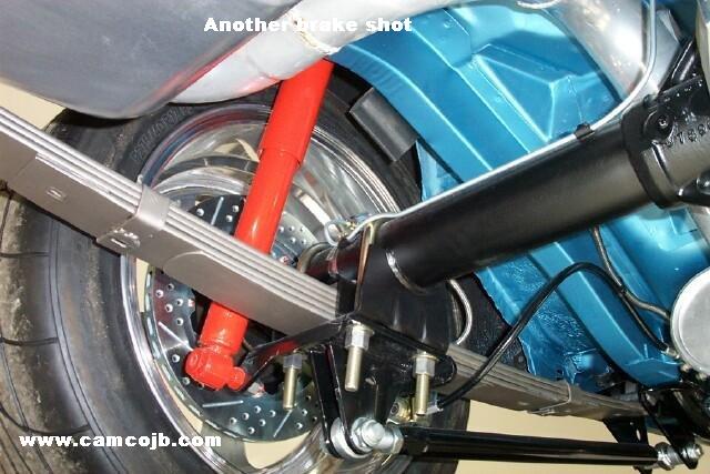

Koni shocks
Factory 5 leaf rear springs
Front 2" lowered springs from DSE
Cal Trac traction bars
PST sway bar and bushings

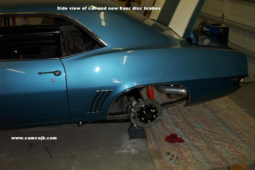

Baer 13" front brakes and 12" rear with PBR calipers and Eradispeed rotors
All suspension pieces were powder-coated by Perfect-It

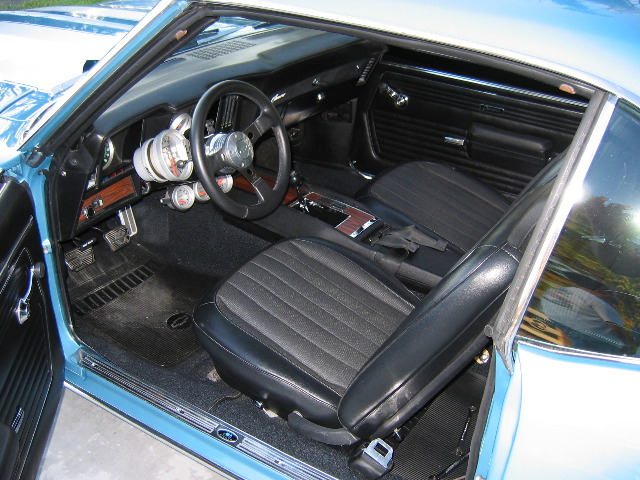

Standard interior with deluxe buckets and rear seat in comfortweave

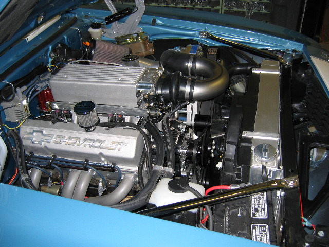

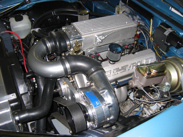

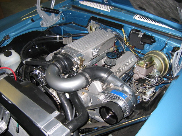

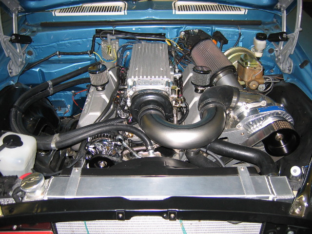

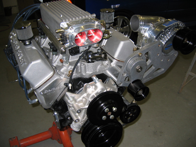

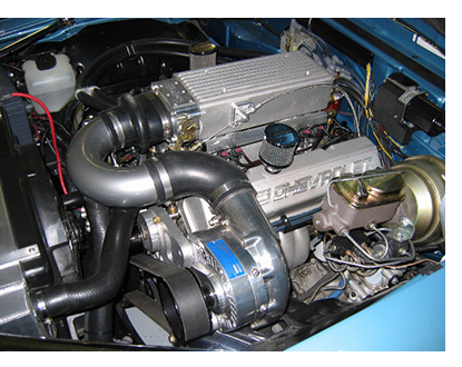

406 small block; Eagle crank and rods
Ross blower pistons (8.8:1 compression)
Fully ported Victor Jr heads by CFM Performance
Comp hydraulic roller .620 lift with 244/[email protected] on a 114 lsa
Crower stainless 1.6 roller rockers with AFR rev kit
Holley Stealth Ram with 1000 cfm throttle body

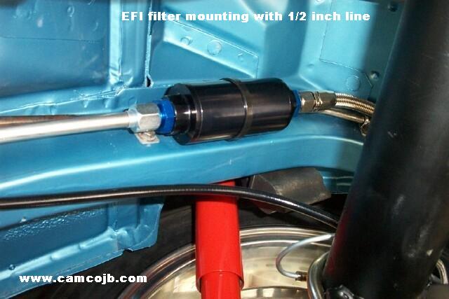

FAST EFI with 75# injectors
ProCharger D1SC blower at 14 psi of boost; 691 rwhp on 91 octane (no intercooler)

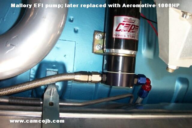

Aeromotive fuel pump and regulator
Rock Valley stainless tank

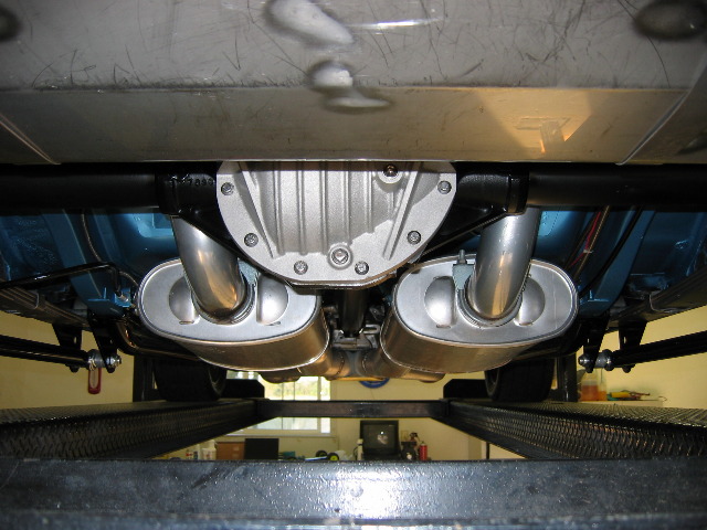

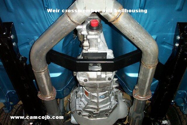

3" exhaust with Dr. Gas "X" pipe and Torque Tech tubing (Dynomax mufflers)

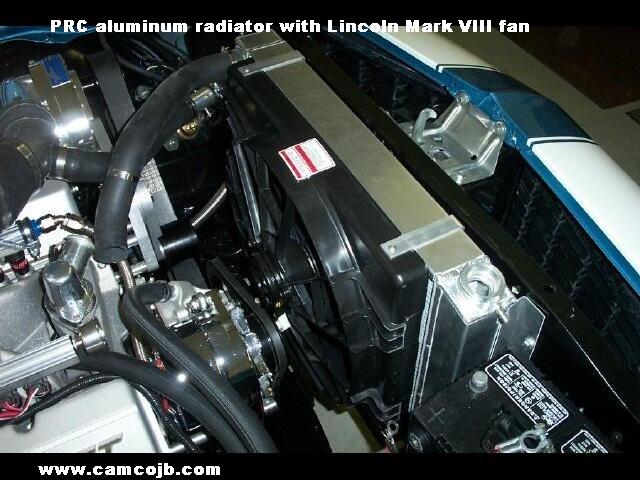

PRC aluminum radiator
Lincoln Mark VIII electric fan

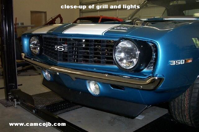

HID lighting by Iguana Motors

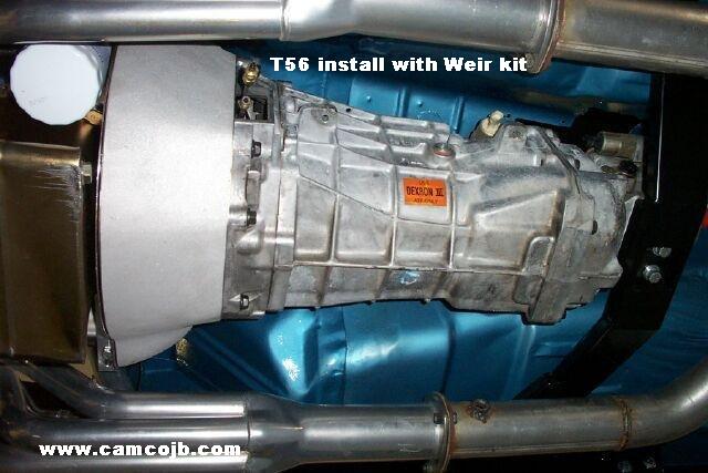

Modded T56 by D&D Performance; carbon fiber synchros, steel shift fork, Viper output shaft
Centerforce dual-friction clutch
Weir T56 install kit
12 bolt posi with 3.73 gears
