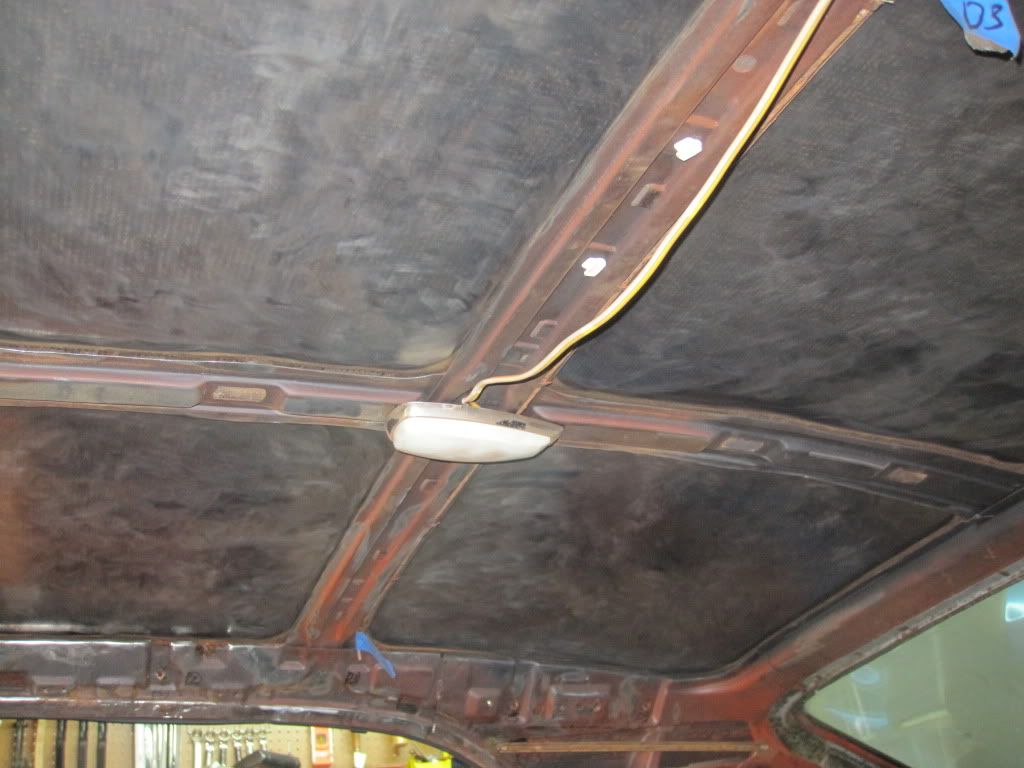

After a lot of scraping the roof was able to remove all old insulation/padding. My best friend was a sharped putty knife I sacrificed for this task. Odd thing was as I was taking off the old insulation I saw really nice unrusted roof:
http://i328.photobucket.com/albums/l...adliner028.jpg
But by the time I had taken off the entire amount of insulation the entire roof had flash-rusted:
http://i328.photobucket.com/albums/l...adliner030.jpg
Must have been some reaction of the glue + bare metal and the open air.

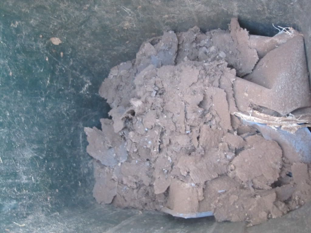

The padding disintegrates into almost something like thick potting soil even looks that way too:
http://i328.photobucket.com/albums/l...adliner029.jpg
http://i328.photobucket.com/albums/l...adliner034.jpg

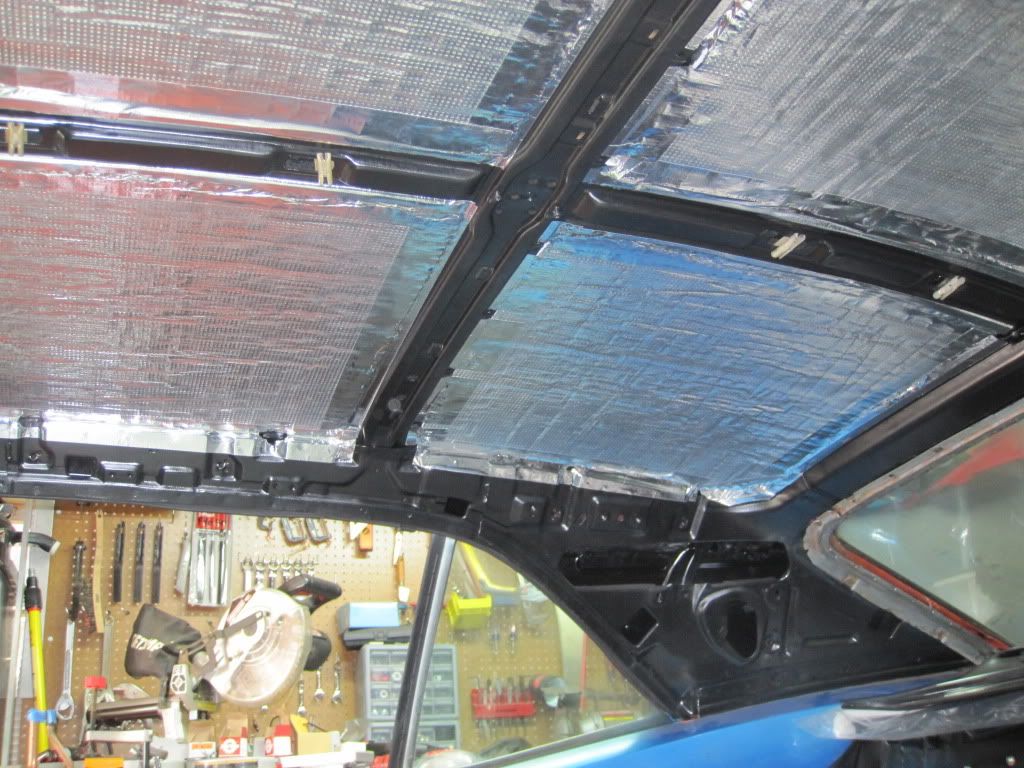

After taking most of the interior down to bare metal and roughing up with 240 grit and cleaning up, masked off the roof:
http://i328.photobucket.com/albums/l...adliner047.jpg
Painted with Eastwood's Rust encapsulator (2 coats) followed by 2 coats of Extreme Chassis black:
http://i328.photobucket.com/albums/l...adliner060.jpg
http://i328.photobucket.com/albums/l...adliner061.jpg

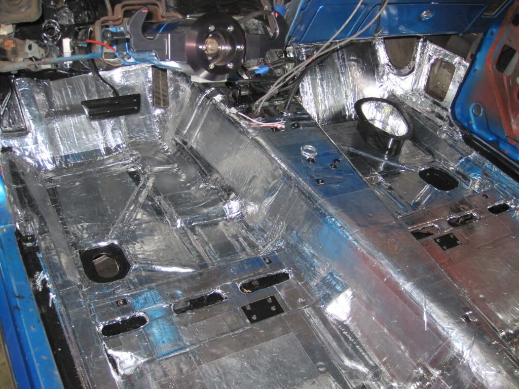

Let it dry for about a week then added Second Skin Audio's Damplier Pro:
http://i328.photobucket.com/albums/l...adliner062.jpg
Followed by their Thermal Block product and taped up all the edges:
http://i328.photobucket.com/albums/l...nterior042.jpg

Finally got the interior floor clean enough to where I would feel comfortable to use Por-15 on it:
http://i328.photobucket.com/albums/l...nterior006.jpg
http://i328.photobucket.com/albums/l...nterior007.jpg
This is after roughing up the entire floor with 220 grit emery cloth. Then used Por-15's marine clean followed up by their Metal ready product:
http://i328.photobucket.com/albums/l...nterior015.jpg
Figured I couldn't do the entire floor in one sitting with both 2 coats of por-15 then seam seal and chassis black, so figured I would divide up the floor in sections and do a bit at a time.
http://i328.photobucket.com/albums/l...nterior018.jpg
Had to leave myself some place to sit on the floor to reach the back corners
http://i328.photobucket.com/albums/l...nterior022.jpg
http://i328.photobucket.com/albums/l...nterior020.jpg
Finished product:
http://i328.photobucket.com/albums/l...nterior023.jpg

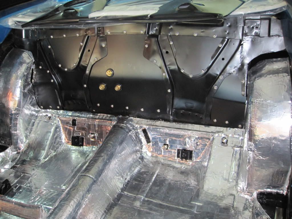

Rear package tray with closeouts are painted as well and started to put down Second Skin's Damplier Pro:
http://i328.photobucket.com/albums/l...nterior035.jpg
http://i328.photobucket.com/albums/l...nterior031.jpg
Got all the way up to the firewall. Need to mock-up all my gauges and senders and figure out how everything is going through the firewall before I finish up on the firewall.
http://i328.photobucket.com/albums/l...nterior036.jpg
Still need to do the doors, rear quarter window areas and rear package tray. Planning on putting down heatwave pro as the next layer on the firewall and trans tunnel area and then Luxury liner pro. Overkill pro on the doors.
