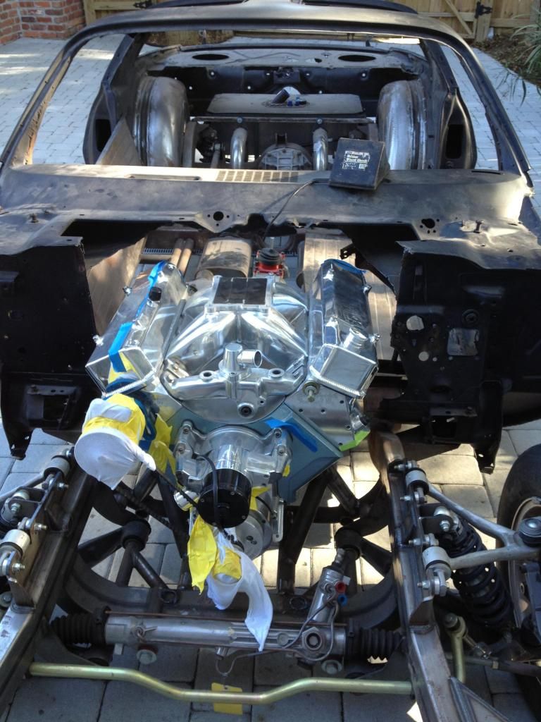

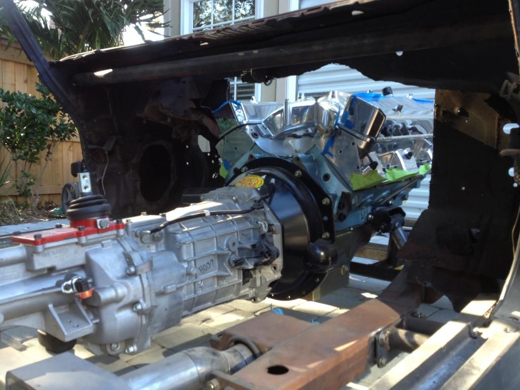

SO now lets talk about Motor placement!! How about a full 12.25" of setback!!! This requires full rework of the firewall, cowl section, some of the dash, and lots of fab work of the mounts. Lots of head scratching and yelling with Jerry but I finally came up with something I am happy with

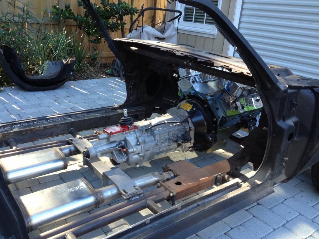

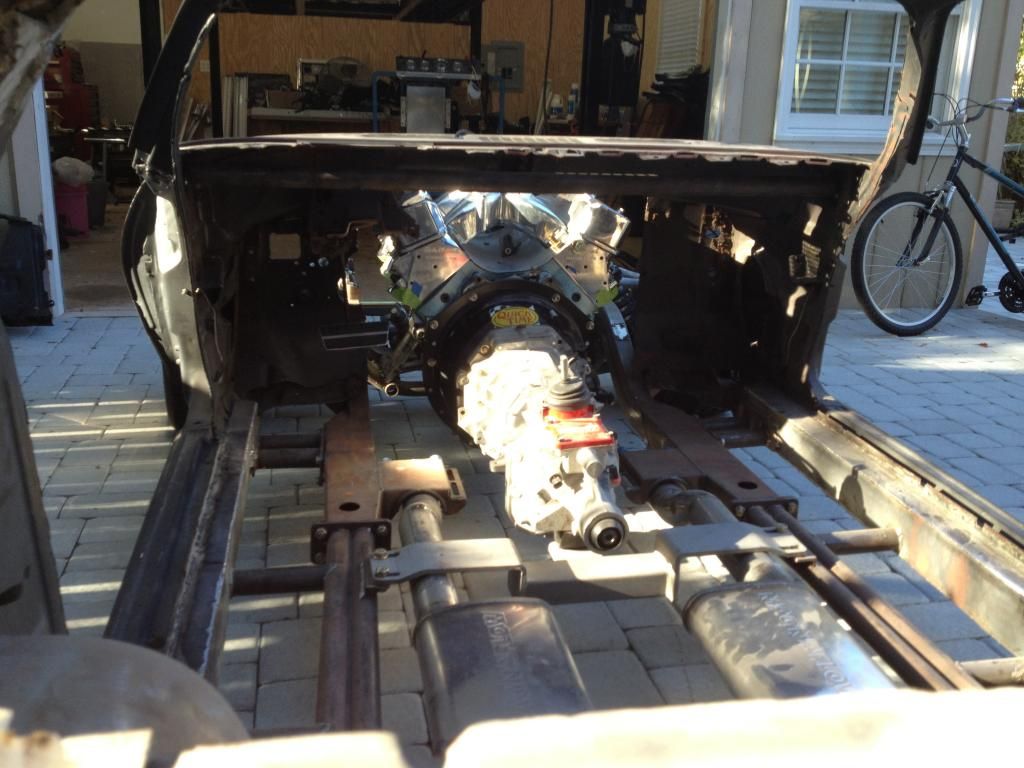

Well, as with all such projects, this one is taking a long and winding road to get to completion. The car is back at my home now as Chad was unable to finish the car. Took it to Dan Holohan for an assessment and he gave me the unvarnished truth. Basically, I have a lot of really cool parts and a lot of problems to solve.
So at first I decided to just sell it off for parts and start over but since then I have had a change of heart and decided to do this as a general contractor type job. I'll sub out the stuff I don't feel comfortable doing and do the rest myself.
Here are some "as it sits" photos...

One of Dan's suggestions that I liked was to make this a full frame car so the body can be removed in order to powdercoat the chassis. I'll get rid of the round tube stuff that was added in which I highlighted in the large blue oval and tie the front and back chassis together with the same tubing used by AME. The tie in within the small blue oval will be left though I prefer to use something other than round tubing since it just doesn't fit well visually with rest of the frame.
http://i213.photobucket.com/albums/c...IMG_0865-1.jpg
Then we'll cut the frame loose from the body in the only other point it is welded in, which is where the cross member hits the rockers. See area highlighted in red.
http://i213.photobucket.com/albums/c.../IMG_0868a.jpg
I'll put plates on the ends of the frame crossmember and matching plates in the rockers and have it bolt in there.
Then we'll cut the fuel cell "cage" that was fabricated loose and move it forward a few inches in order to trim the rear frame rails to the proper length and move the cross rail back so it can sit behind the tail panel without interfering with the bumper mounts as it does now.
http://i213.photobucket.com/albums/c...k/IMG_0881.jpghttp://i213.photobucket.com/albums/c...k/IMG_0882.jpg
Once these are located properly, I'll put end plates in place with bolt holes that will allow the endplates, body and bumper supports to all be held together with the same 4 bolts on each side.

I really likes Dan's idea of a full frame car. I would consider a chassis from the Roadster shop as they already have one ready to go and debugged !!.
I am not sure why you stuff the motor back so far. It is going to cause you another world of problems. Foot well space will be sparce at best. Unless this is a dedicated race car. Your going to have problems putting a radio, air or heat in the car.
I've been down the road your on with my last project. I had a lot of fun building the truck but thank God I am only 5' 6'' tall because if I was any taller I would have been really cramped in the cabin due to the fact that I moved my firewall back only 2". It's amazing what happens when you start moving things.
Buy the Roadster Shop Chassis. Have Dan make a new floor and plop the body on your new powdercoated chassis.
