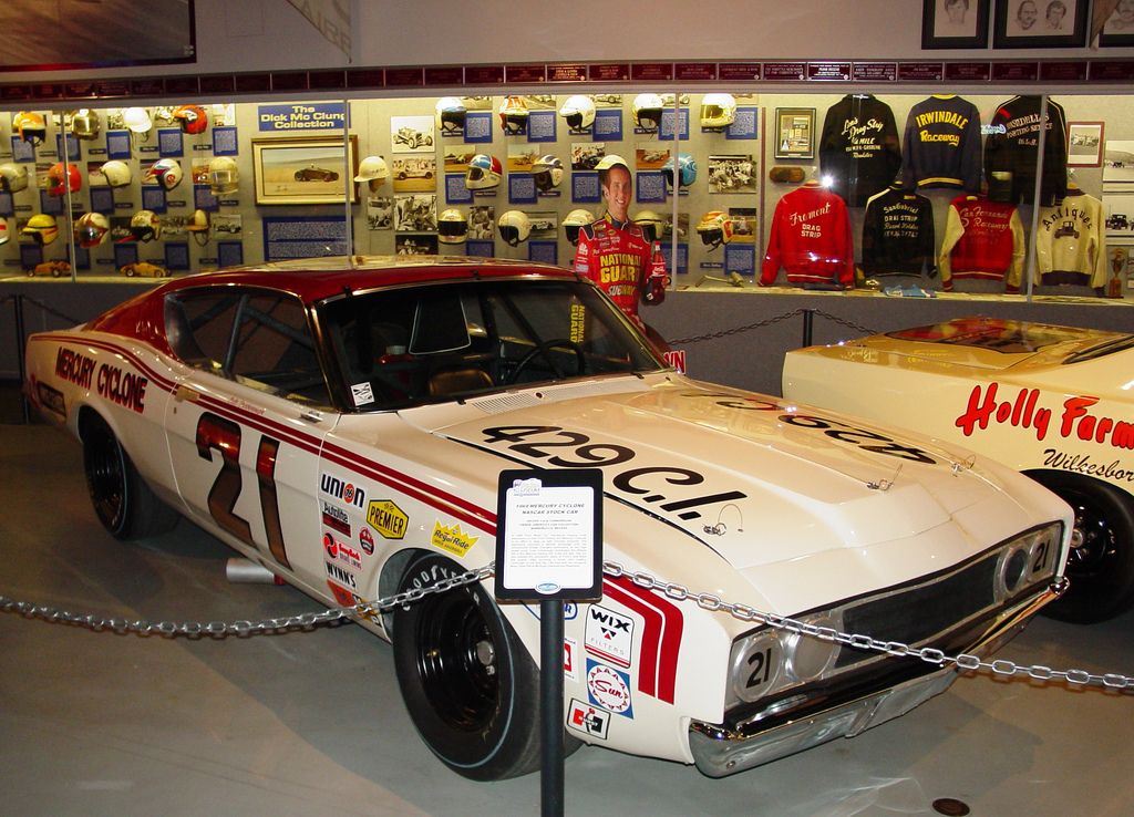

Wrong era buddy. I'm stuck in the 60s and the glory of LeMans, NASCAR and Fords other race efforts in that decade..:D

DG how about going with the upscale Mercury variant. That Petty car is the exact body style as mine I think you want something different.

I'm a Ford fan not a Petty fan, I just respect the king for being a great driver. The Mopar aero cars were a response to my ugly duckling :unibrow: and then Fords Talledega and Mercurys Cyclone Spoiler II in 69.
Petty in 69 is interesting because it was the only year he raced something other than a Mopar product. He was pissed they wanted him to stay in the Roadrunner when he knew the Torinos and Cyclones were way ahead on Aero so he jumped ship to FORD.:wow: :thumbsup: He came in second that year but he did win a lot of short track races including Riverside.
David Pearson won his second and third NASCAR championships in the Boat in 68 & 69. After that he decided to just run part time. It's a shame because his part time winning % was record setting and it seems he could have captured a few more championships.

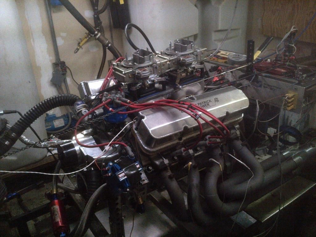

FETorino 11-10-2012 09:39 PM
I'm beat 12 hours today on the dyno.
http://i291.photobucket.com/albums/l.../dynopulls.jpg

FETorino 11-10-2012 10:30 PM
Originally Posted by Bryce (Post 445903)
Not bad for a ford

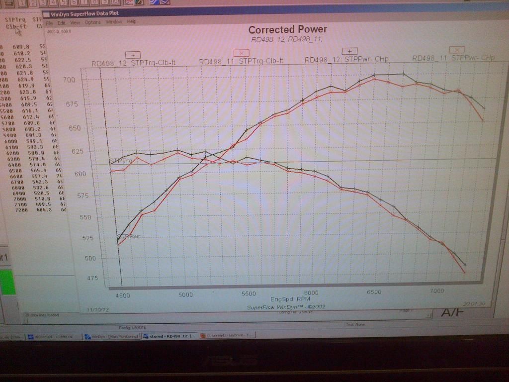

Yea pump gas with 12 in vac at idle, pretty mild.:unibrow:
http://i291.photobucket.com/albums/l.../bppower-1.jpg

intocarss 11-11-2012 12:02 AM
Nice I see a 7??Hp and a peak Tq # of 824 Dang 12 hours?? You all beat on it for a while, how many pulls you make?

FETorino 11-11-2012 07:07 AM
Originally Posted by Rick D (Post 445920)
Very nice numbers Evernote for a Ford :unibrow: Just rubinn you!!
That's some nice tq down low :thumbsup:
The goal was good hp with a broad power band. I think we got that. :D
We had a O class stocker motor on the dyno the day before, made 370hp with break in oil a 465 Holley and .400 lift cam on that one. We had to take it off and throw mine on and rig a stand for the dry sump pan. :faint:
We got 12 total pulls on mine but only 8 of those were tuning. We just got over the 700hp mark. Avg from 4500 to 7200rpm was 645hp and 584 tq.
