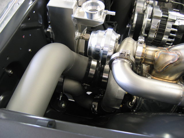

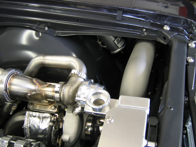

air cleaners showed up, and got the breather tanks mounted. I had some nice tanks Mark built that bolted in the wheelwells, but they didn't clear the new air filter location, so I bought some Stefs aluminum breather tanks and mounted them in the area next to the air filters. I drilled and tapped the valley cover on the LS2 behind the intake and ran two #10 lines to the tanks. That's pretty hidden, and is a baffled area of the engine, so there shouldn't be a lot of oil pushed up. I ordered some different breather caps from the tank with a nipple fitting on them, and ran a line from there to the air filter base. This way there will be no smoke or oil smell when the engine is running. I did this before on other cars, and was reminded by Charley, as I think they did this also recently to the Red Witch.
The coils just showed up, so I'm going to see if my mounting idea will work, right after I finish up the trans lines.

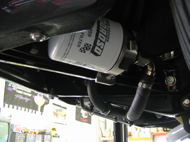

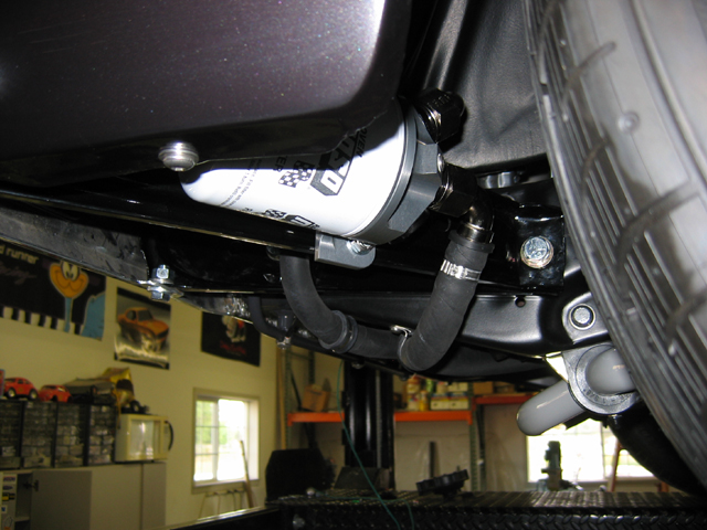

camcojb 05-02-2008 06:10 PM
forgot to post where the oil filter ended up. That last pic didn't work as the front bumper brace interfered. So it ended up being bolted to that brace. Clears the tire easily, up behind the bumper, not hanging down at all.
http://www.camcojb.com/temp/malitude 616.jpg
http://www.camcojb.com/temp/malitude 617.jpg
http://www.camcojb.com/temp/malitude 620.jpg

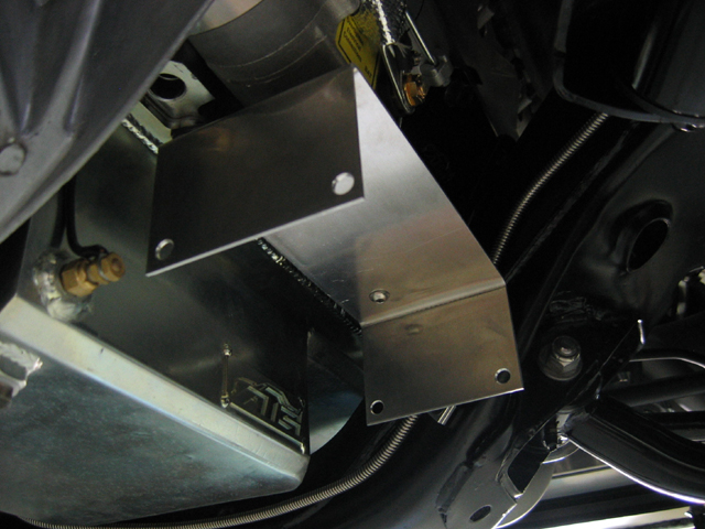

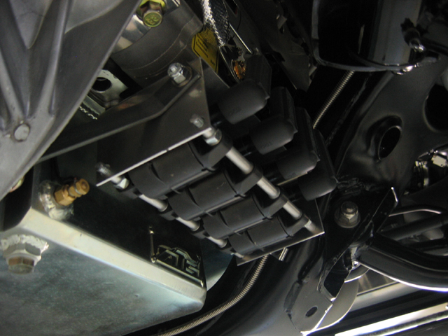

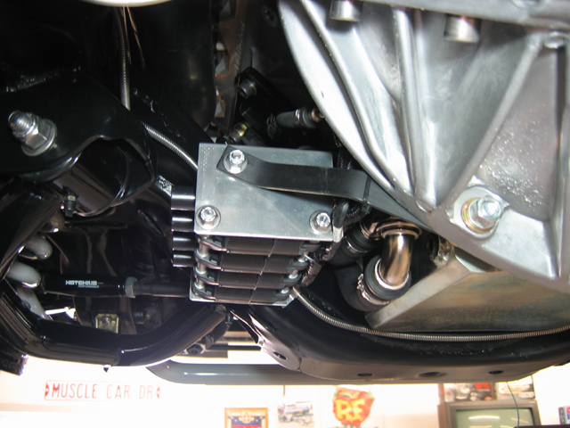

working on mounting the coils today. You'd think it would be easy to find a place to put them, but it's not, at least not for me.................
First I made some spacers, and with some 1/4" all-thread I got the four coils for each side as compact as they possibly could be. Thanks to Tony (Nineball) for this idea, saw it on his red 69 Camaro.
http://www.camcojb.com/temp/malitude 624.jpg
For you Camaro and Chevelle guys you can use the above setup and build simple brackets and bolt them to the back of the heads. They're virtually hidden and pretty simple to do. But on my car the engine has been set back further than normal; Mark had modded the frame pads to slide the engine an addition 1.5" or so, and this makes the passenger head very close to the firewall. I wanted to keep this setback, so the rear of the heads was out. The problem from here was trying to get them in the same area on each side. Originally I wanted to put them in the wheelwells, but Chevelles don't have wheelwells........... :D They're so small you'd have to remove the the wheelwells to put them on or do any work on them. One the drivers side you could build a bracket to bolt to the side of the block to mount them; not on the passenger side, starter is in the way. On the passenger side they could be mounted to the front crossmember, no way on the drivers side. No frame room either side, etc. So this is what I came up with.
http://www.camcojb.com/temp/malitude 621.jpg
http://www.camcojb.com/temp/malitude 625.jpg
http://www.camcojb.com/temp/malitude 626.jpg
Added some braces and it's very solid. It's tucked up high out of the way of water, debris, etc. and still has plenty of room to get the wires and harnesses in there. Now on to the drivers side; similar deal but will need to be spaced a bit further out to clear the oil lines.
Van B 05-03-2008 06:57 PM
I would be afraid of them getting doused with water off the tire when driving in rain.
A+++ for getting them out of sight though.

camcojb 05-03-2008 07:41 PM
I don't think the tire will turn that far to have the water hitting that area; definitely not driving down the road. I guess if your oil pan and starter gets wet in the rain then this would too, but I don't remember mine having that issue.

camcojb 05-03-2008 10:32 PM
thanks guys. :) I know the coils are not the ideal location, but other than a deep puddle 10+" I think they're fine. They're fully shielded from water from the front of the car by the crossmember. I may look at alternatives later, but for now they'll stay. This is not a rain car by any means, it's a daily driver good weather car. If I get stuck in rain it should be fine, but I'll avoid it if possible........... :P

Van B 05-04-2008 06:39 AM
Remember Cleveland to Kalamazoo last year? Great weather if you're a duck.
JamesJ 05-04-2008 08:22 AM
The coils are pretty strong, I would think that as long as they are not getting soaked with water they will be fine. You can always put some silicone around all the connections if need be.

camcojb 05-04-2008 08:37 AM
the metripack connectors are sealed, and the coil/plug wires are packed with dielectric grease, so I'm not going to worry about it. Worst case, I get towed into the next stop by the Red Witch................. :faint: :rofl:
