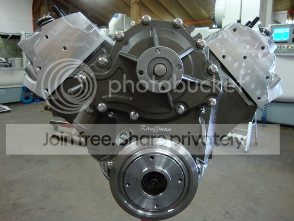

Engine is DONE!!
Kevin Swaney finished the final assembly of the TIP/KRE 440 yesterday!! This thing is a work of art Kevin!!!! :bow:
http://i691.photobucket.com/albums/v...M/DSC02683.jpg
440cid stroker, 4.188-in bore x 4.00-in. stroke, KRE 320cfm Aluminum D-ports, KB Pistons, Comp solid etc.
This beast will be on the dyno early next week!!! I can hardly wait!

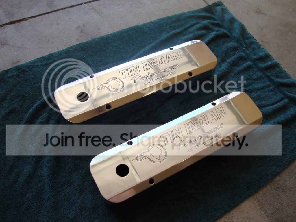

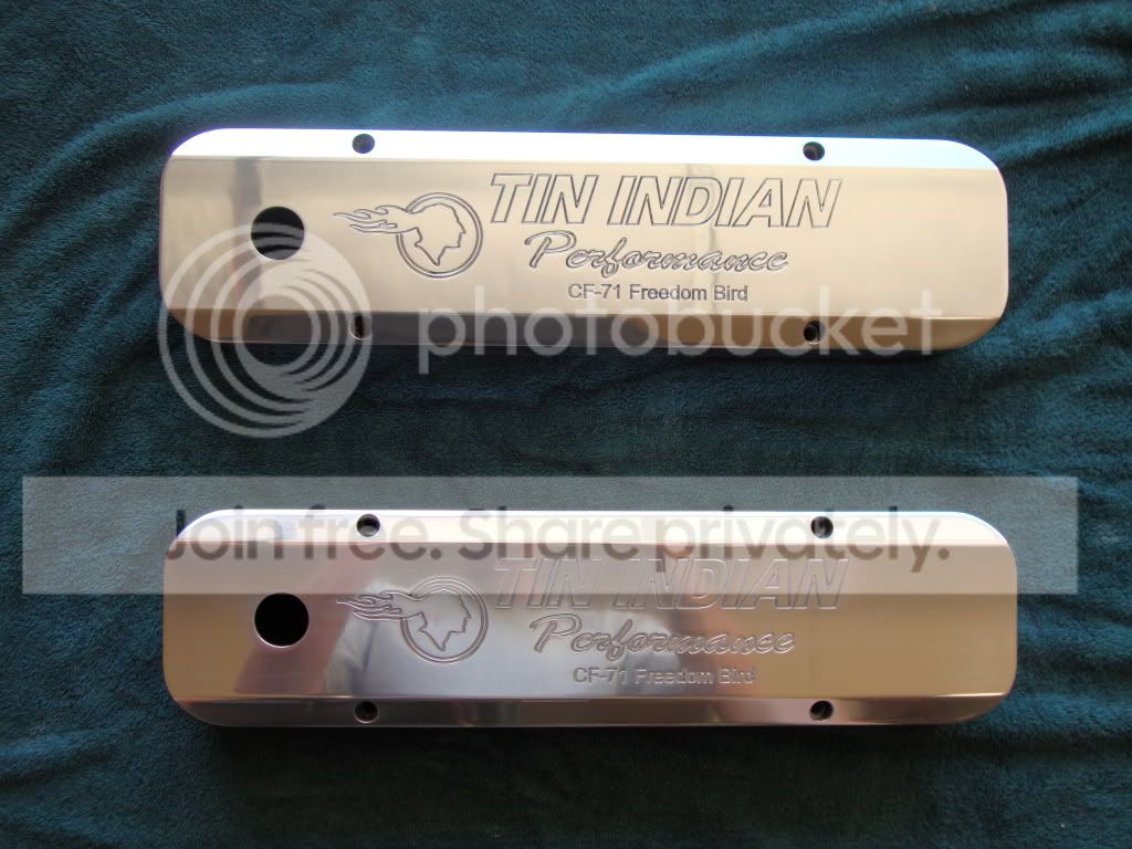

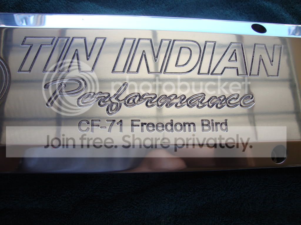

Billet-TEK Valve Covers!
Here's TIP's Billet-TEK custom built Pontiac valve covers for the 440!
http://i691.photobucket.com/albums/v...M/DSC02687.jpg
CNC machined, thick CNC machined rails for perfect flatness and superior sealing, will clear high port intake and supercharger manifolds without any modifications...
http://i691.photobucket.com/albums/v...M/DSC02689.jpg
Available with stainless steel socket head cap screws or black oxide socket head cap screws and optional breather grommets, grommet holes can be placed anywhere you want, designed to clear ALL valve train components - poly locks and stud girdles!
http://i691.photobucket.com/albums/v...M/DSC02697.jpg
Covers feature recessed bolt hole for a clean finished look!

A cool thing about the engine is that only the stock iron block is original! EVERYTHING else on it or in it is from the aftermarket!
TIN INDIAN Performance and Kauffman Racing Equipment have collaborated on the build and used their parts to replace everything but the block!
Even the timing cover is made by Kauffman Racing as are the heads and other parts like the oil filter adapter!! And some new stuff to be revealed here shortly!! :question: :unibrow:

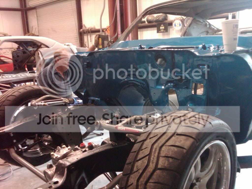

Subframe Update!
Chad just sent another quick text pic...
http://i691.photobucket.com/albums/v...90905-1942.jpg
AGR Billet 12:1 power steering box, BMR tubular control arms, KORE3 billet hub assembly (with 1/2"-20 screw-in ARP wheel studs) and a Fletcher's Customs-modified stock spindle!
I'd picked up another set of axles and had them modified last summer in order to speed up the process when swapping out the brakes... this was all before Chad got the project... anyway, FWIW late model 2nd-gen spindles are NOT the same as early 2nd-gen spindles!! The outer bearings are just slightly different sizes! So, if anyone needs an already modified set of late model 2nd-gen F-body spindles that are already painted and ready to go... let me know! LOL L2 = Lesson Learned!
IMPORTANT note from the KORE3 instructions! "GM tall-spindles came in two variations with respect to the outer wheel bearing size. The outer wheel bearing seat diameter of the spindle may be either Ø.750" [Ø19.05 mm] or Ø.844" [Ø21.44 mm]."
And now you know why I have an extra set of spindles available! LOL :rolleyes:
INTERESTING note from the KORE3 instructions! "KORE3 billet hubs decrease track width .03" [.8 mm] per side over stock applications, making the overall track width .06" [1.6 mm] narrower than stock."
AGR's Billet box features a true 12:1 ratio, the fastest turning ratio available. Firm race type valving enhances road feel and offers precise handling. Total Bearing Control locks in the sector shaft for smooth, precise steering! :drive:
