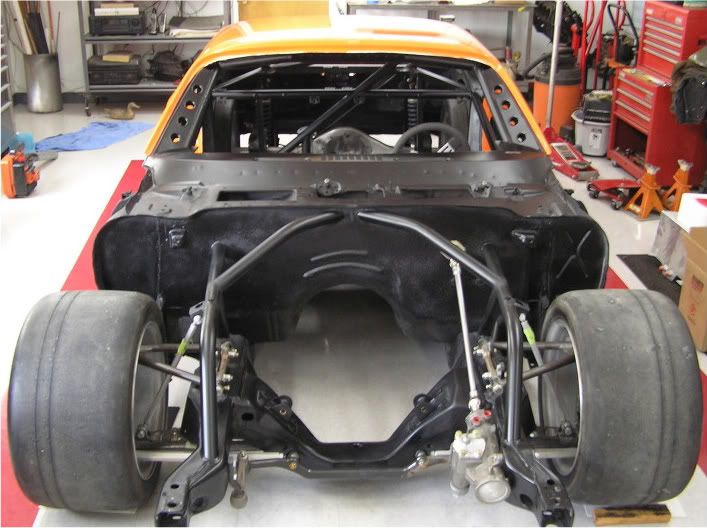

Originally Posted by 73CPCAMARO (Post 320481)
The engine and transmission are going in tomorrow. Here is the last shot with an empty engine compartment.
http://i80.photobucket.com/albums/j1...PC040563-1.jpg
That is the coolest thing I have seen all day! Look at those meats! Very cool.:thumbsup:

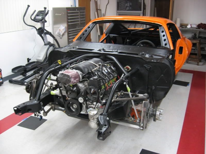

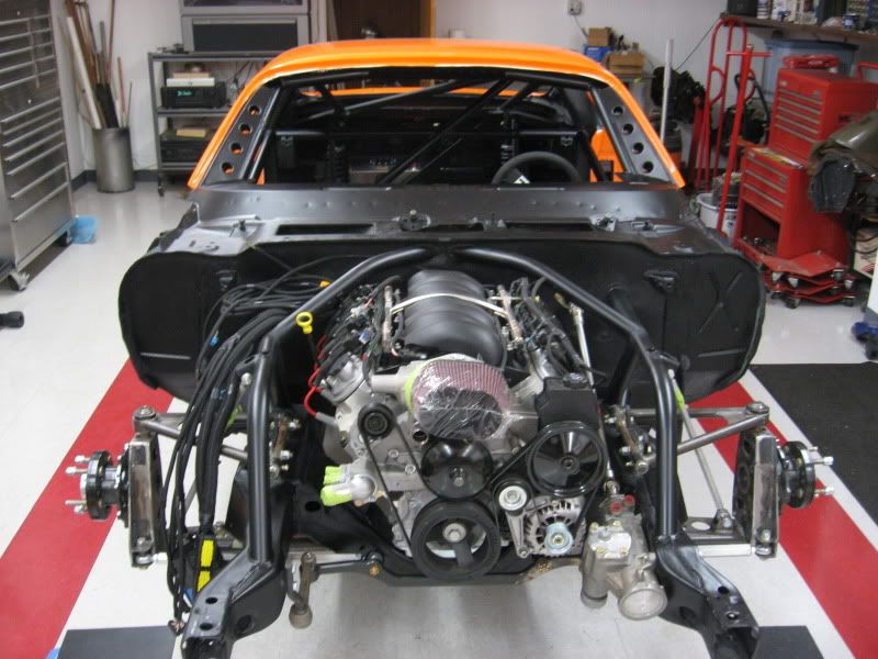

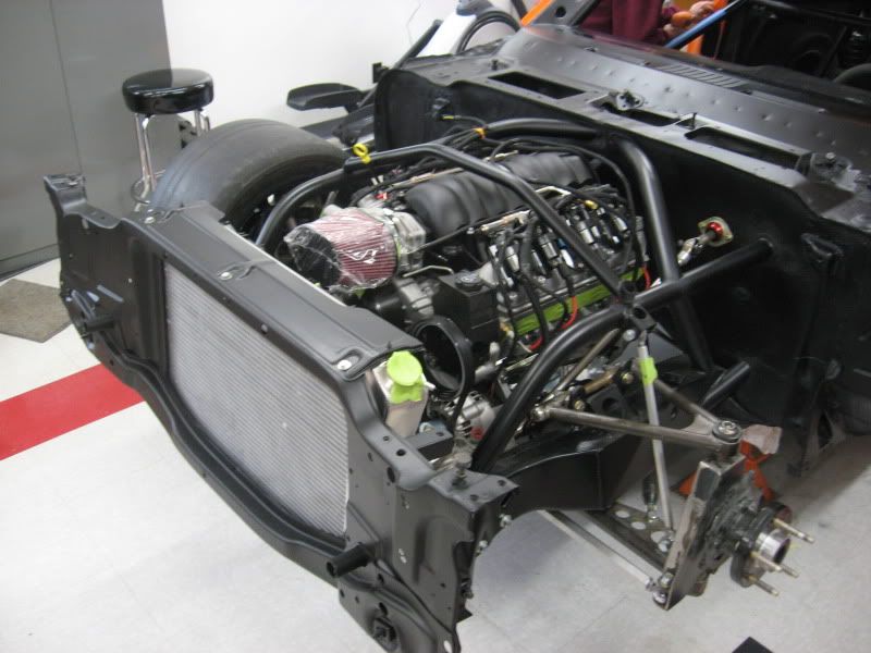

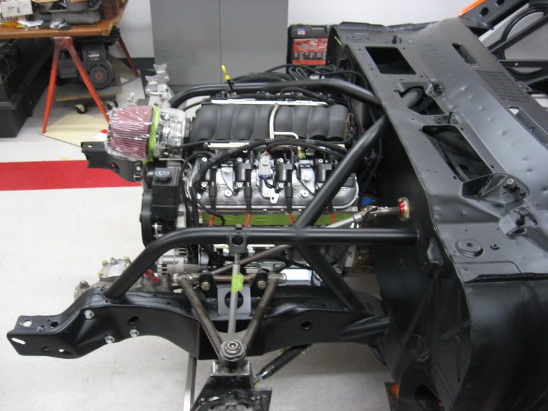

73CPCAMARO 12-08-2010 08:58 AM
The engine and transimission were installed last night :D . It feels great to have in coming together and so close to finishing up after a few years. Now we can start on the plumbing and electrical.
http://i80.photobucket.com/albums/j1...b/IMG_3614.jpg
http://i80.photobucket.com/albums/j1...b/IMG_3615.jpg
http://i80.photobucket.com/albums/j1...b/IMG_3612.jpg

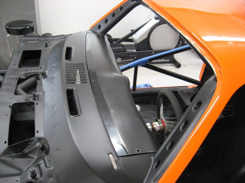

onelapduster 12-12-2010 02:17 PM
Do you happen to have any more pictures of the dash installed? I am researching my build and would like to know what you did to get the VFN dash installed? Mounting brackets, support structure, etc... Thanks
I read through your entire thread and this car is bada$$, very well thought out and built, cant wait to see it done!

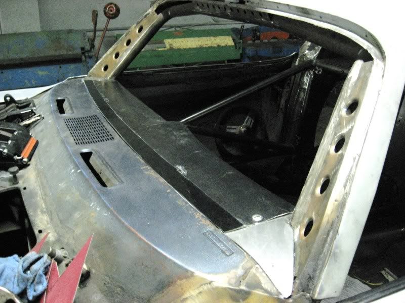

73CPCAMARO 12-12-2010 07:05 PM
Here is a photo of when we first installed the dash. I will be putting the dash in later next week and add some more photos at that time. The dash was cut on the ends because of the cage. Maier Racing filled in the corners with sheet metal. They also added about 1 1/2" of extra material to push the dash into the passenger compartment for some clearance issues we had. Dzus fasteners are used to hold the dash in place. You can see some of them in this photo.
http://i80.photobucket.com/albums/j1...b/IMG_1168.jpg
http://i80.photobucket.com/albums/j1...b/IMG_3617.jpg

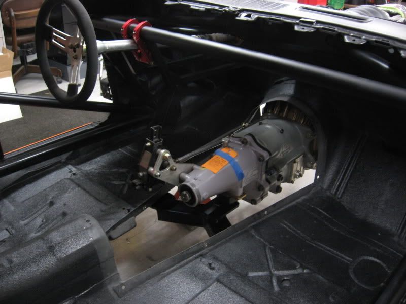

conekiller13 12-13-2010 08:16 AM
Originally Posted by 73CPCAMARO (Post 321603)
So obviously a four speed which is what I plan on going to as well. Can You tell Me what type and where you sourced it?
P.S. anyone need a T-56?:unibrow:
73CPCAMARO 12-13-2010 09:17 AM
http://i80.photobucket.com/albums/j1...b/IMG_0285.jpg
I am using a G-Force GF4A I purchased from Competition Transmissions & Gears in Mooresville, North Carolina.

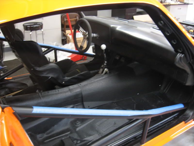

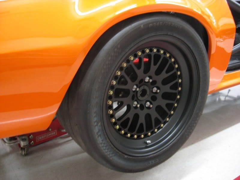

73CPCAMARO 12-18-2010 03:15 PM
Latest update:
Radiator support and cooling installed. With some minor modifications, everything seems to fit nicely.
The dash was installed today. Next is to figure out where to mount all the gauges and switches. The dash will come back off and finish off the texture and paint.
I also took apart the CCW wheels and painted everything black. I was going back and forth on whether to black out the outer wheel. I really like the all black look.

lilcraigford 12-18-2010 06:38 PM
I am a fan of the black CCW's. Totally sinister!
