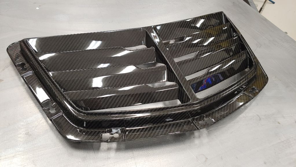

Goosesdad 01-19-2020 09:34 PM
4 Attachment(s)
Hood vent - for another day!
Attachment 71144

CamaroAJ 01-20-2020 12:30 PM
Whats the hood vent from? measurements? I'm looking for one for my car to match the Anvil ones and make fit the cowl hood.
Goosesdad 01-20-2020 01:18 PM
APR Performance - C7 Z06.

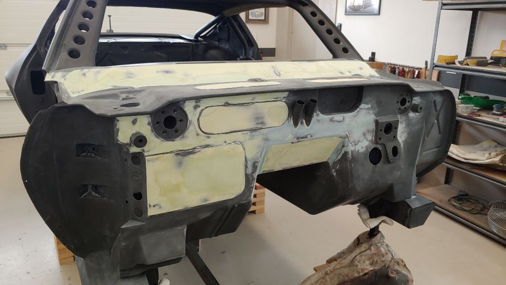

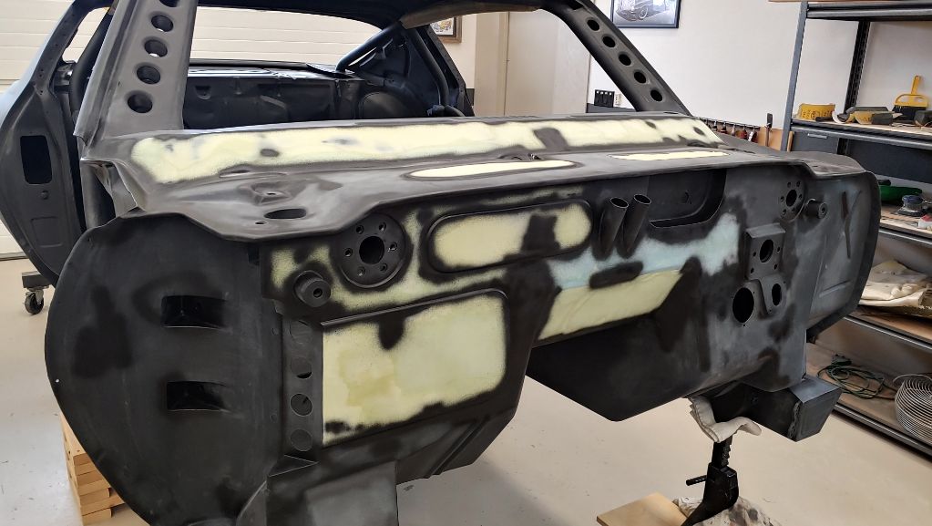

Goosesdad 02-04-2020 02:26 PM
2 Attachment(s)
I've been struggling with those 2 stupid chimneys that I built on the firewall for the 2 fire suppression heads....the automatic head (in a previous post) is pressurized from the factory so you can't do anything to the line in order for it to penitrate the firewall perpendicular, and the hose (braided) limits the options so sort'a stuck with something sticking out from the firewall. Anyway, didn't like what I did so changed it... I think this gets closer to a clean solution.
Attachment 71272
Finished the first round of block sanding, went through to metal in a few spots so touched them up with epoxy along with the fire suppression fix.
Attachment 71273

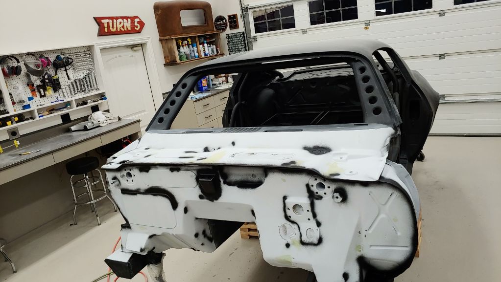

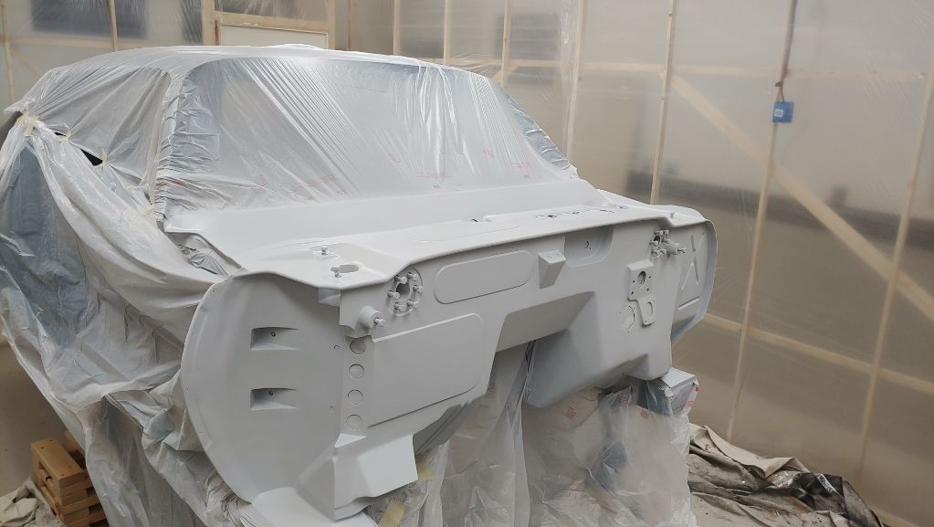

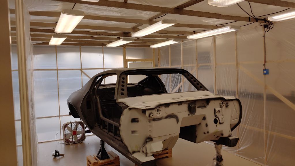

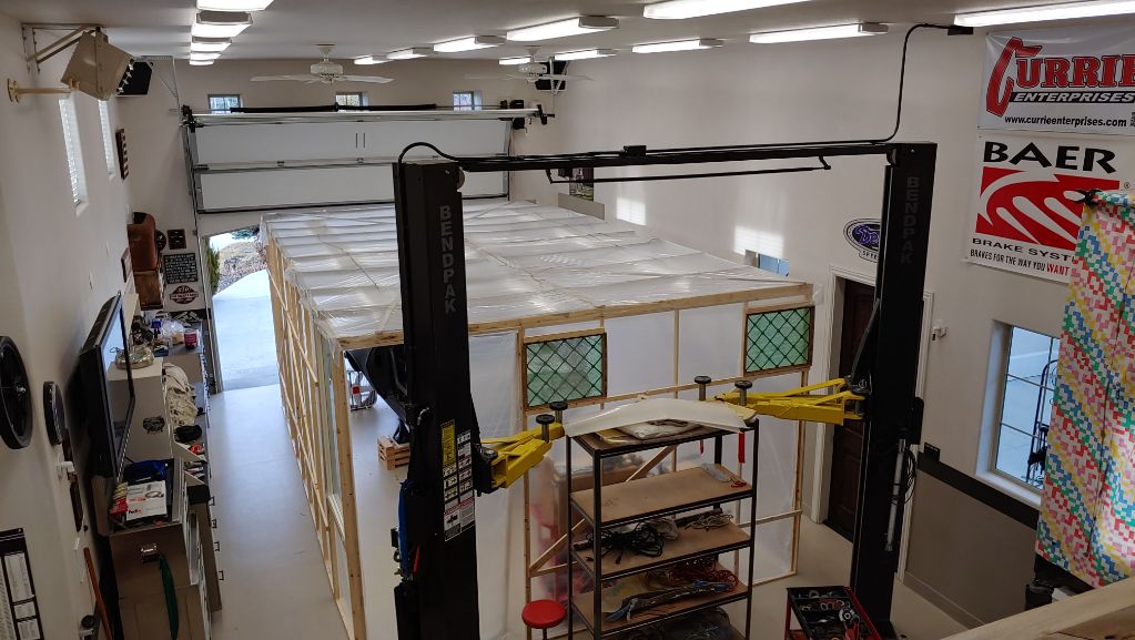

Goosesdad 03-01-2020 08:31 PM
3 Attachment(s)
Built a temp booth so I could contain sanding dust, as much as possible, and so I could spray primer. Just trying to manage the mess a bit.
Attachment 71471
Attachment 71472
Sprayed a final coat of polyester on the firewall. I will block it and paint next.
Attachment 71473
slimjim 03-02-2020 04:53 AM
Great work on the booth, my garage will need a full overhaul once the car heads out to paint as the poly dust ruins everything!
Goosesdad 03-02-2020 08:18 AM
Thanks! So true. I tried to convince myself that just doing the firewall wouldn't put dust in every possible nook and cranny within a 100' radius. Lying to myself when I know better seems to be common for me.

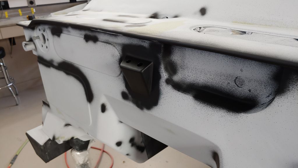

Goosesdad 03-20-2020 07:21 PM
2 Attachment(s)
Shot a few coats of OMNI 243 primer. Won't block sand for now. Paint and Raptor for another day. Hadn't planned on smoothing the inside but did a light sweep of filler just because I could/should.

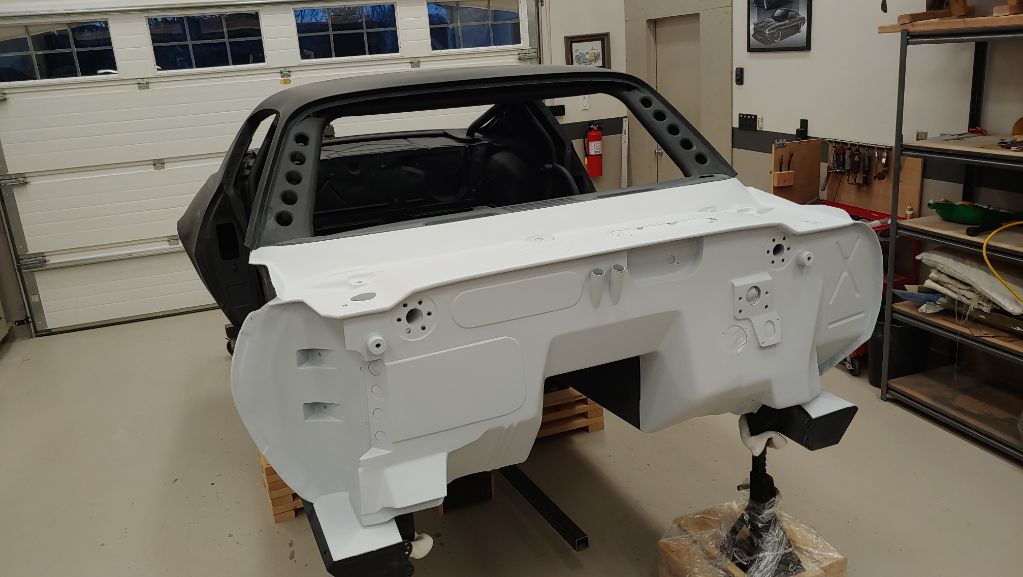

Goosesdad 03-30-2020 08:33 AM
7 Attachment(s)
Firewall painted/cleared this weekend.
First pic is sealer...DP-90 2:1:1/2(885 reducer)
The following pics are after paint and clear.
Deltron 9700 black. 1:1
PPG D8115 Matte Clear: 3:1:1 1/4

Musclerodz 03-30-2020 10:23 AM
Attachment 71671
Attachment 71672
Attachment 71673
Attachment 71674
Attachment 71675
Attachment 71676
Attachment 71677
looks awesome. one the 8115 I use 2 full parts of reducer instead of the recommended 1.5. It helps it flow out nicer so it doesn't have that texture to it.
