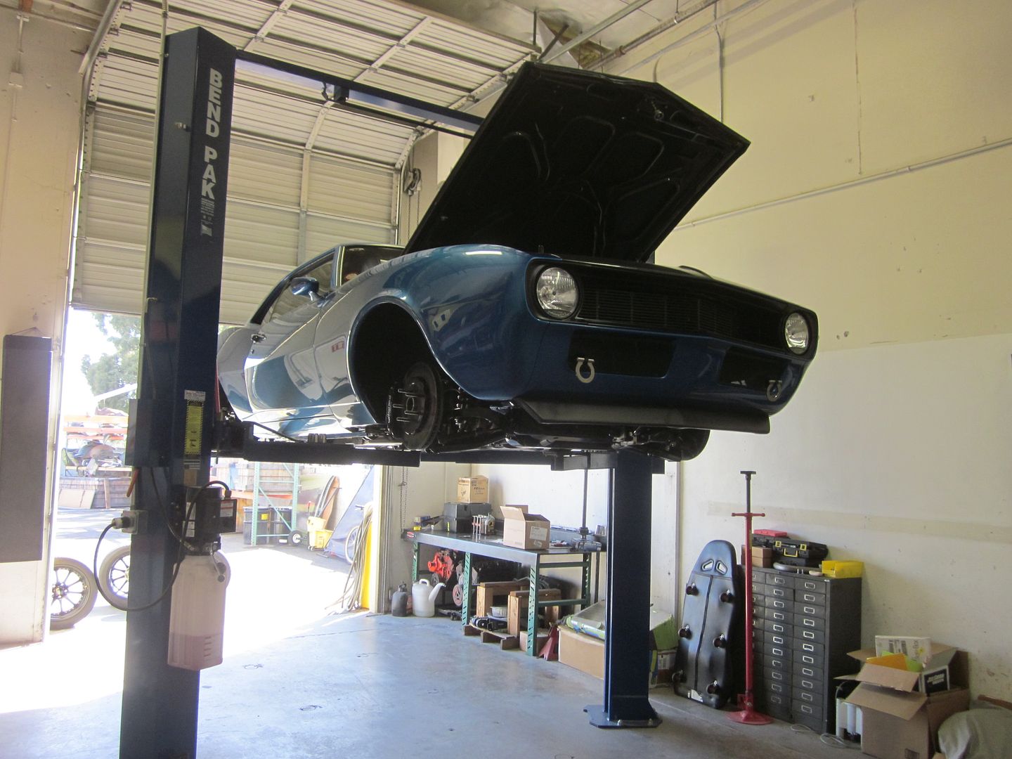

Cris@JCG 07-10-2012 09:23 AM
Finished testing & tuning yesterday! getting the car clean, new tires mounted, change fluids, & nut/bolt check... Leaving tonight to South Haven MI tonight to the Motorstate Challenge.. it a good thing that Guy Ankeny is making that 40 hr drive with me!

SBDave 07-11-2012 11:03 AM
Blu Balz even looks good while on a lift without tires! ...my car would be kinda scary from that view.
