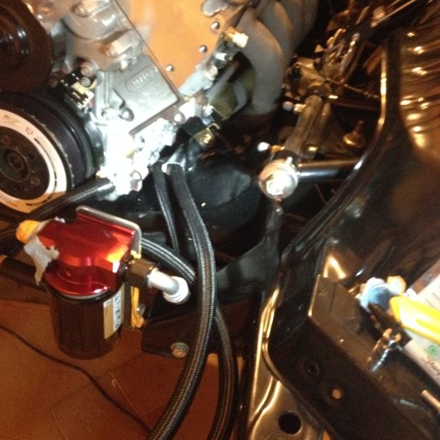

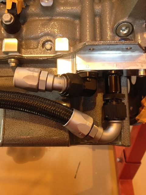

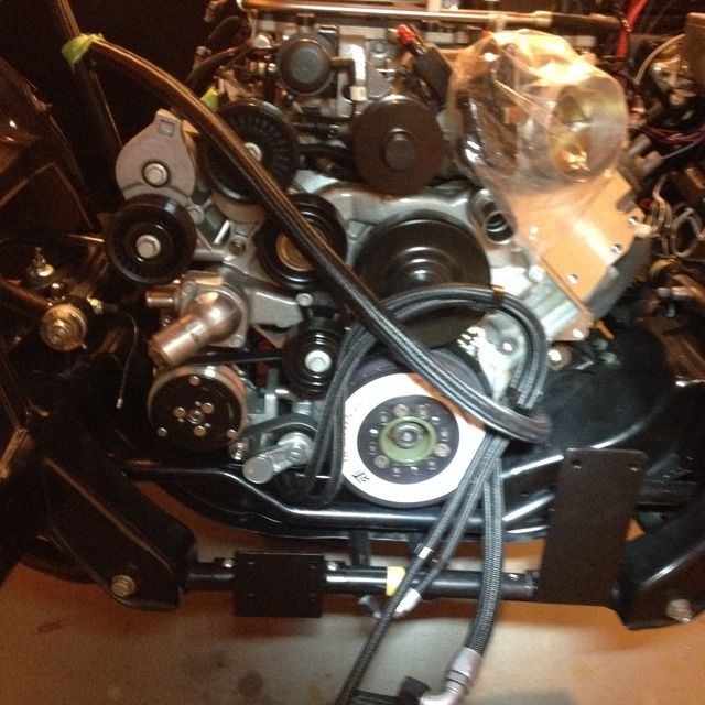

I was out in the garage for a while today and test fit the oil lines to the remote filter and when the radiator support goes back in I'll plumb the oil cooler in the Radiator.
This was the idea I had when it was on the engine stand.
http://i172.photobucket.com/albums/w...psncpzn7qj.jpg

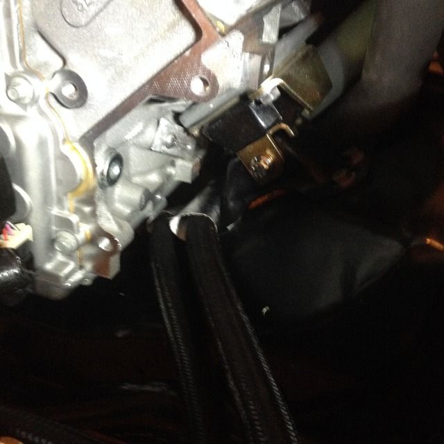

Here it is installed loosely. They are not as tight to the oil pan as they look.
http://i172.photobucket.com/albums/w...pscnyuyj84.jpg
http://i172.photobucket.com/albums/w...pscgbc7kdl.jpg
They clear all hot or moving parts. They will also have a hose seperator bolted to the block to keep them safely away from everything.

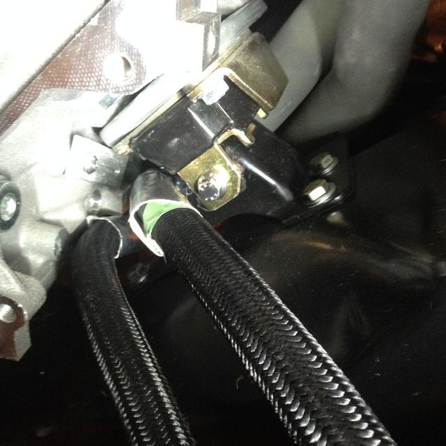

http://i172.photobucket.com/albums/w...pspypwzukq.jpg
In this picture you can see the aluminum piece bolted to the block, there is also a bolt hole right below it. I will drill and tap the aluminum for the hose seperator.
http://i172.photobucket.com/albums/w...psoytjeh4m.jpg

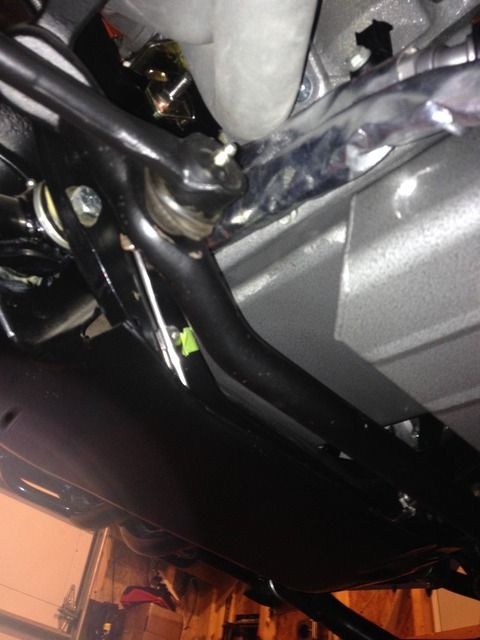

Here you can see the room I have.
http://i172.photobucket.com/albums/w...pskddrqgov.jpg

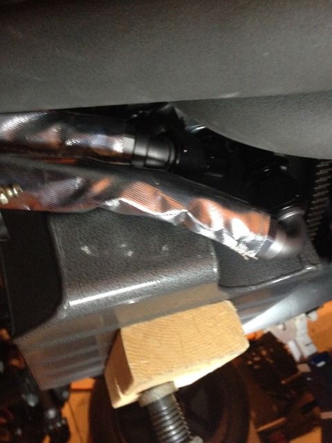

The return line is connected to the filter the long hose will be secured to the frame or inner fender on its way to the bottom of the in radiator cooler.
http://i172.photobucket.com/albums/w...pswvjwrm89.jpg
Then its to figure the routing of the discharge from the cooler to the in side of the filter.

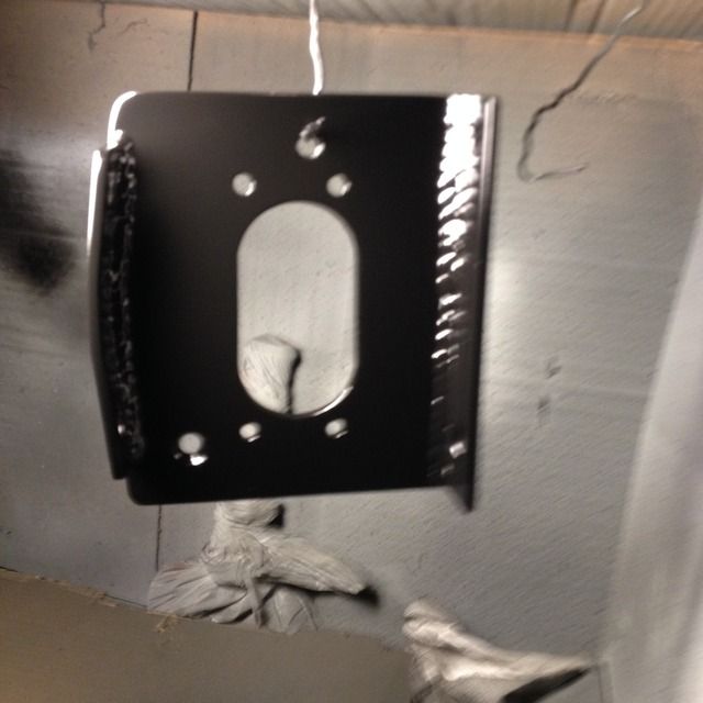

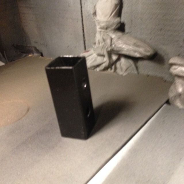

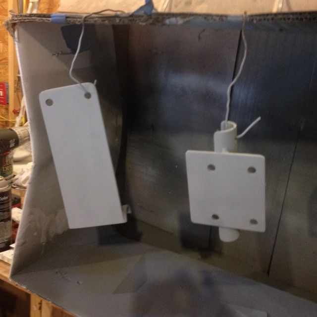

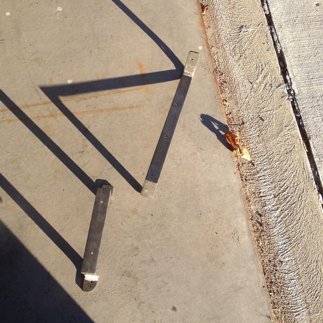

I spent all day and most of the night in the garage Friday removing mill scale from my brackets we made. Holy moly I wish I was as tough as that crap is!! It took for ever, had to quit because I could feel my neighbor zeroing in on me with his rifle for the compressor running after 11:30. He shouldn't complain there IS 9' between his bedroom and the garage. The next day I used Eastwood fast etch on all of them, then sprayed them with high zinc content primer. Then some black paint. Thank God for my reperator, that zinc paint will kill you quick.
Here's a few pictures.
Here's a couple of the brackets after Fast Etch
http://i172.photobucket.com/albums/w...ps1ueou3fx.jpg
Some primed parts. Smaller is for the Heat exchanger pump and the long one is for the remot oil filter.
http://i172.photobucket.com/albums/w...pskz5sjtfx.jpg
Both installed
http://i172.photobucket.com/albums/w...psdfch9cgi.jpg
I also did the same to the spacer for the trans mount, and the remote hood latch.
http://i172.photobucket.com/albums/w...pshu0l7bvr.jpg
http://i172.photobucket.com/albums/w...psz3llgynr.jpg
Next will be the piece of the latch that connects to the hood.
