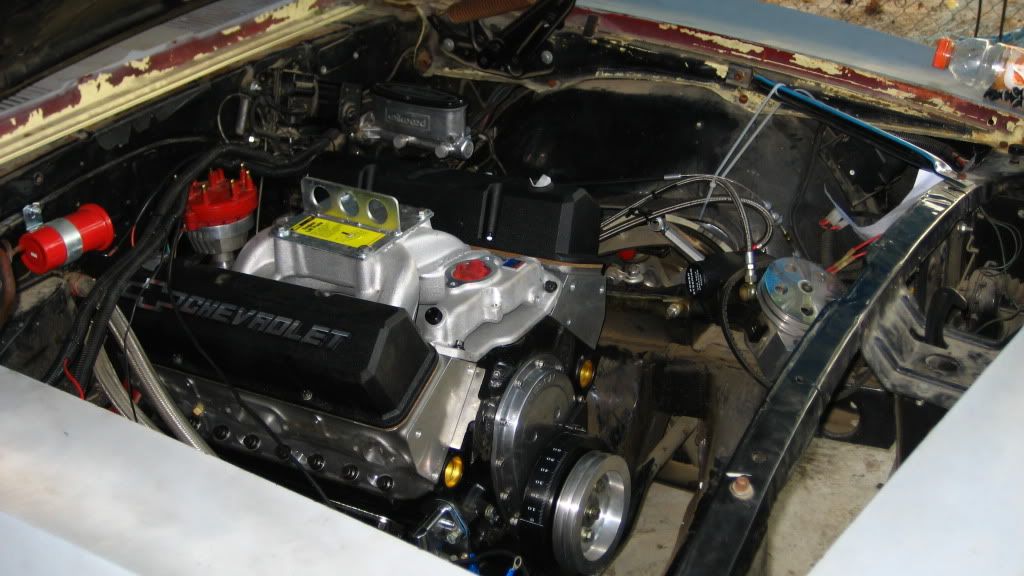

Along with the engine install, I cut the shifter hole, tightened down some brake fittings, cleaned up some wiring, and installed some of the clutch linkage. Shouldn't be too long now!

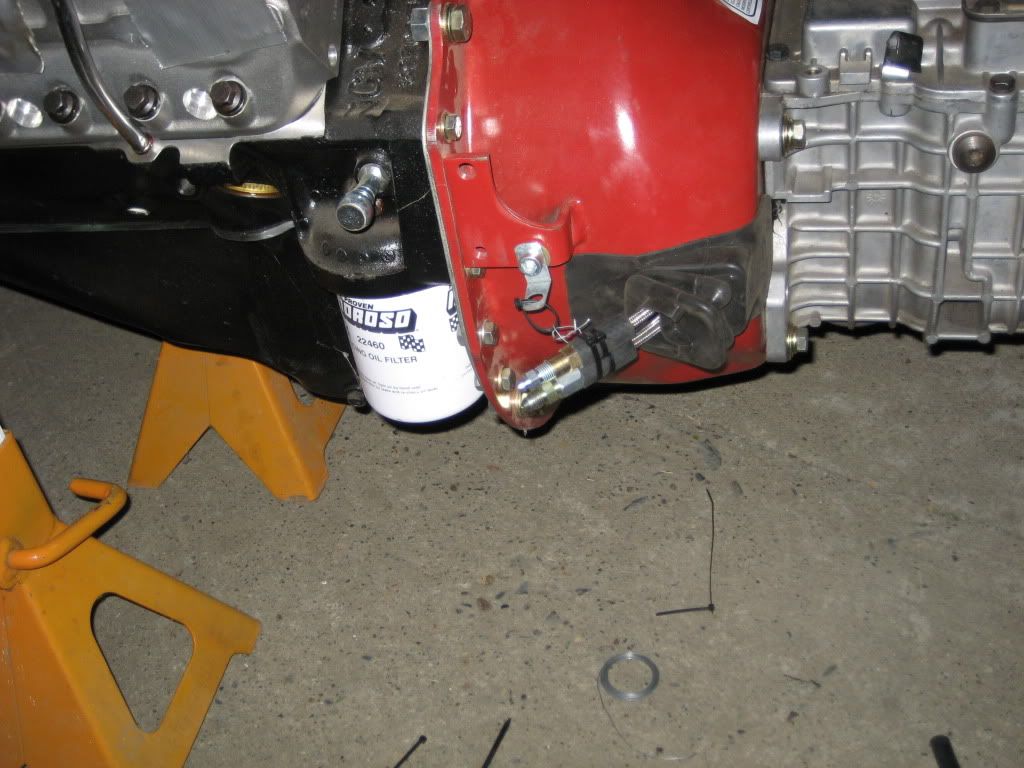

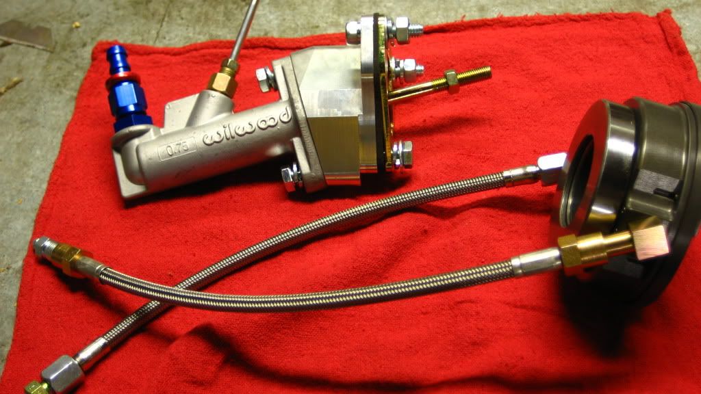

I decided to abandon my effort to run clutch linkage, and go full hydraulic. This weekend was the 5th time I had my engine in and out. Between myself, my dad, and my brother, we can pull the engine/tranny in ~5 minutes and re-install in about 15...we've had lots of practice.

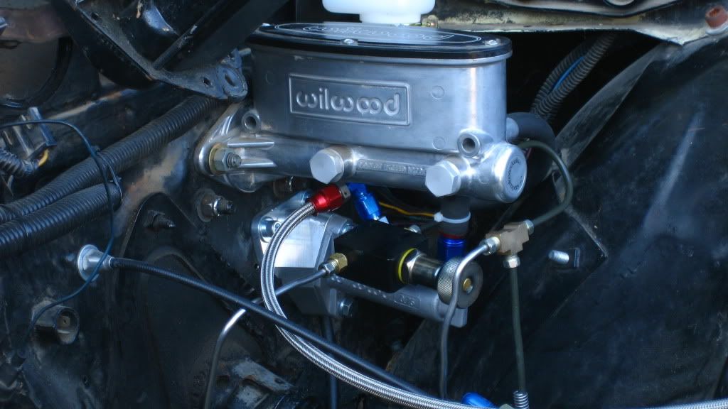

Having never encountered hydraulic clutch setups in my life, I was a complete newbie. After reading many threads and talking with many helpful people on this site (special shoutout to Frank at Prodigy, for talking me through my problem even when he had nothing to sell me), I had come up with the following components for my install:
Keisler hydraulic clutch kit (minus the throwout bearing), which includes Wilwood 3/4" MC
Mcleod 1400-30 slip-on throwout bearing (for my Ford input shaft)
4ft of -4AN steel braided hose
Misc. earl's fittings...
Here is a picture of the main components:
http://i207.photobucket.com/albums/b...o/IMG_0241.jpg
You can see on the MC that there is a machined billet base, which is what Keisler provides to align the MC pushrod to the clutch pedal holes. Nice jobto Keisler for a quality setup. Just make sure that the master cylinder pushrod doesn't kink during pedal travel. I had this problem and had to drill another hole lower on the pedal to prevent binding. It's 3/4" lower than the other hole, so it should not increase pedal effort too much more.

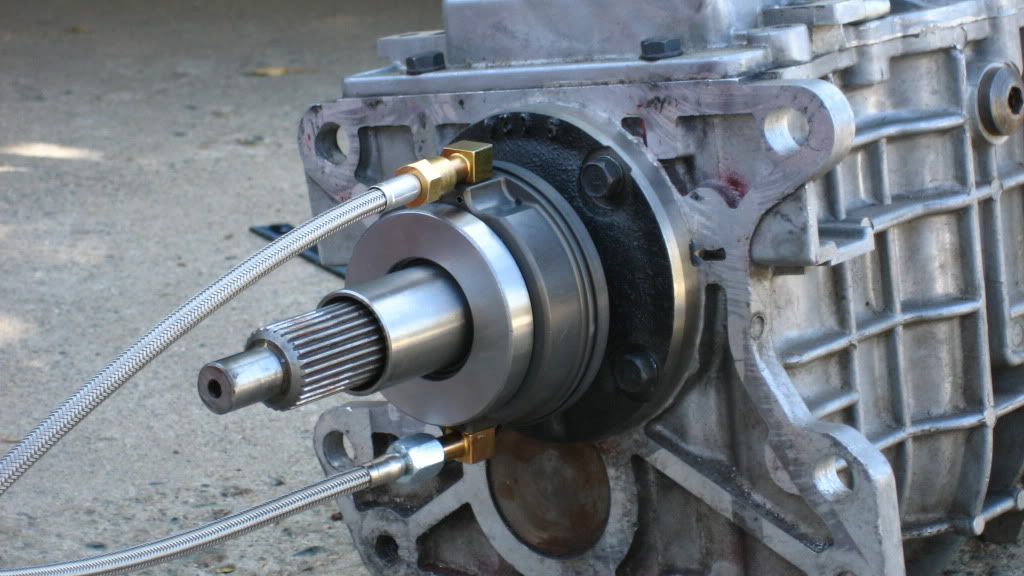

Next, the throwout bearing. Here it is on the input shaft.
http://i207.photobucket.com/albums/b...o/IMG_0243.jpg
Setting up the proper length was super easy...there's a threaded sleeve that slips on the input shaft first, then the TO bearing threads onto the sleeve. Just turn it on the threads until proper length is achieved.
Here is a picture of the two hose ends from the TO bearing out of the clutch fork hole, bleeder end goes on top:
http://i207.photobucket.com/albums/b...o/IMG_0263.jpg
Lucky for me, I didn't have to redo any of my brake lines. With a little encouragement, everything seemed to just clear and turned out to be a pretty compact arrangement:
http://i207.photobucket.com/albums/b...o/IMG_0267.jpg
Gotta love the increasingly prevelant blue/red fitting look!

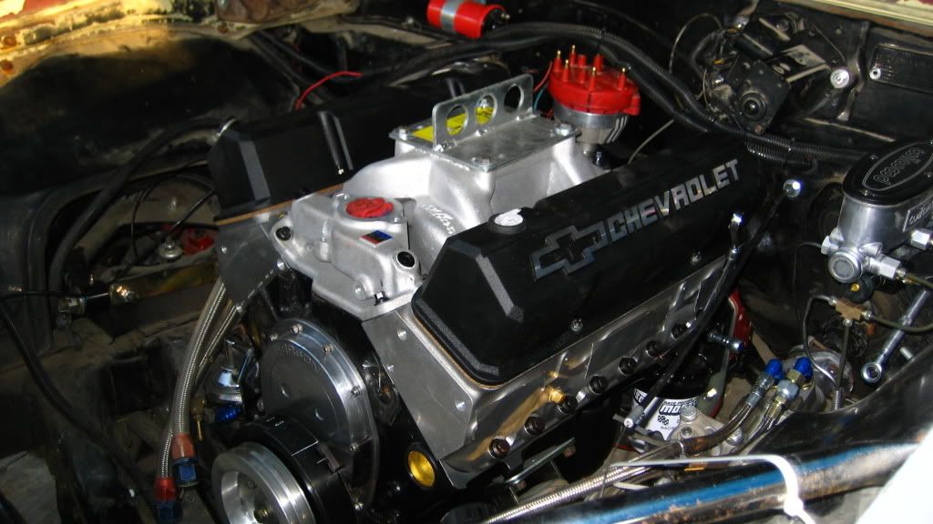

Today (tuesday) was an epic day: the first ignition of my new 355.
I was losing hope that this day would ever come...I am still partly in shock that car is running.

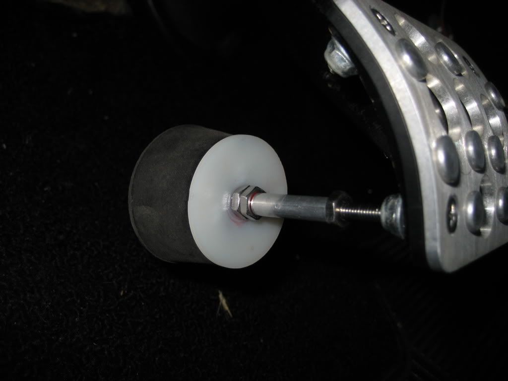

As a side note, I also installed my prototype for my clutch pedal stop. It is a rubber foot sandwiched between washers, with a screw through it, a couple nuts for pre-tension, a threaded sleeve for adjustability, and another flat screw. I came up with this setup because it will work with the Modo pedal covers I have.
It doesn't look super strong but I think it will get the job done...I am going to try it out and see if it holds up.
