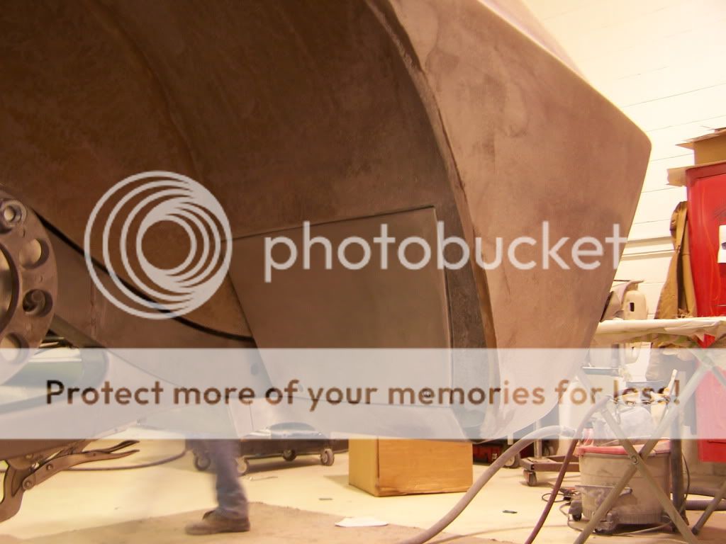

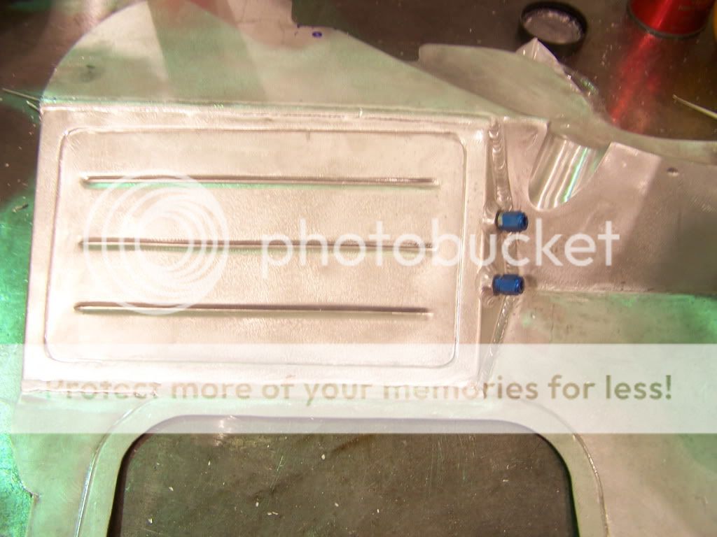

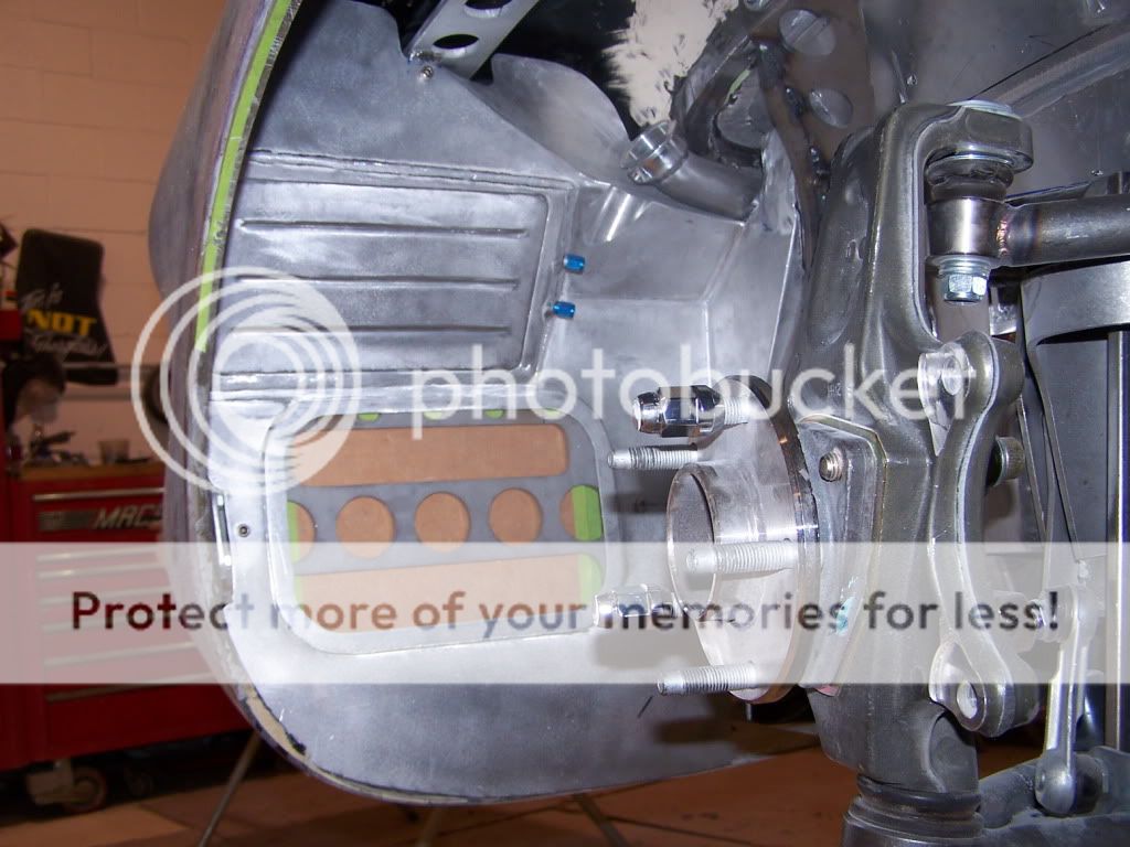

Roadster Shop 06-26-2009 03:56 PM
Rear close out panel behind tire

Front close out panel infront of tire. There is a lot going on here. The headlights are mounted infront of this panel. THe cut out section where the cardboard is houses a power steering cooler on one side and an oil cooler on the other side of the car. there is a perferated screen to match the front grille that goes in here when completed. There is also a radiator overflow tank built into the panel. It is the ribbed section with the two AN fittings.
http://i563.photobucket.com/albums/ss79/RS-Perf/92.jpg
Here is a close up. We made a tank out of aluminum to follow the shape of the inner fender panel and welded it all together for a clean look.
http://i563.photobucket.com/albums/ss79/RS-Perf/93.jpg

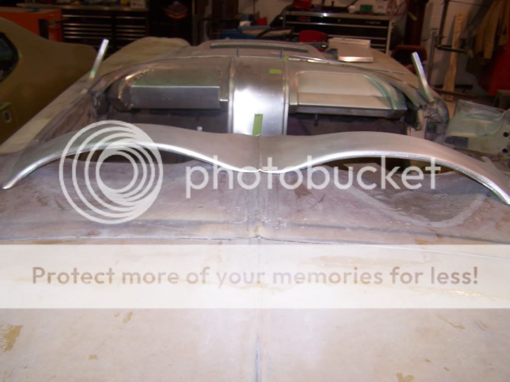

Roadster Shop 06-26-2009 04:07 PM

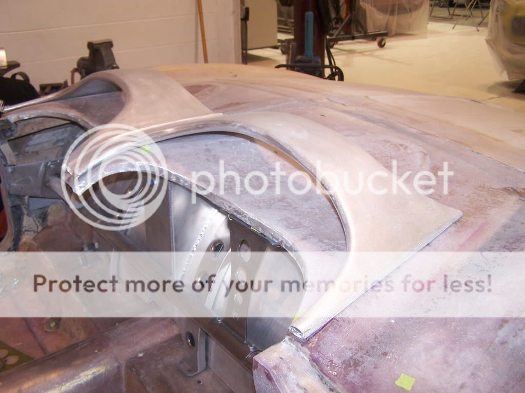

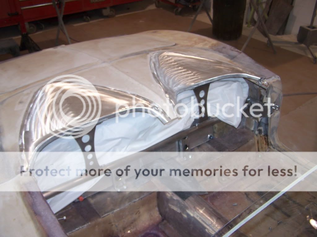

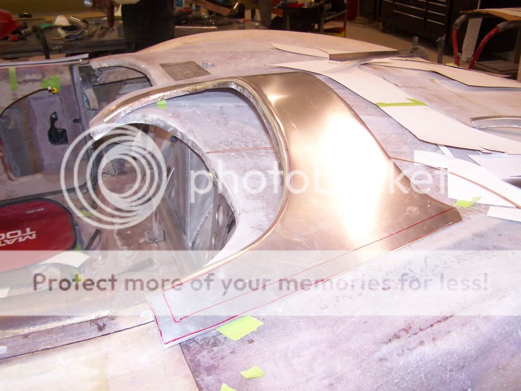

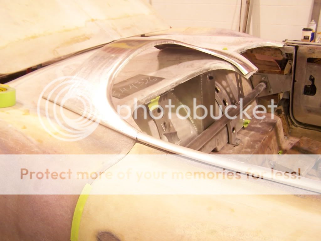

The convertible top was ditched and the car turned into a roadster so we could fit the 345/35R20 Michelin's in the back. You don't drive a convertible with the top up anyways!
The original lid for the convertible to fold into was eliminated. We fabbed 2 aluminum coves to go behind the driver and passenger's heads and give the car some more detail.
http://i563.photobucket.com/albums/ss79/RS-Perf/80.jpg
Then fabbed an aluminum arch that wraps into the cockpit surround molding and into the windshield trim.
http://i563.photobucket.com/albums/ss79/RS-Perf/117.jpg
http://i563.photobucket.com/albums/ss79/RS-Perf/118.jpg
http://i563.photobucket.com/albums/ss79/RS-Perf/120.jpg
http://i563.photobucket.com/albums/ss79/RS-Perf/119.jpg

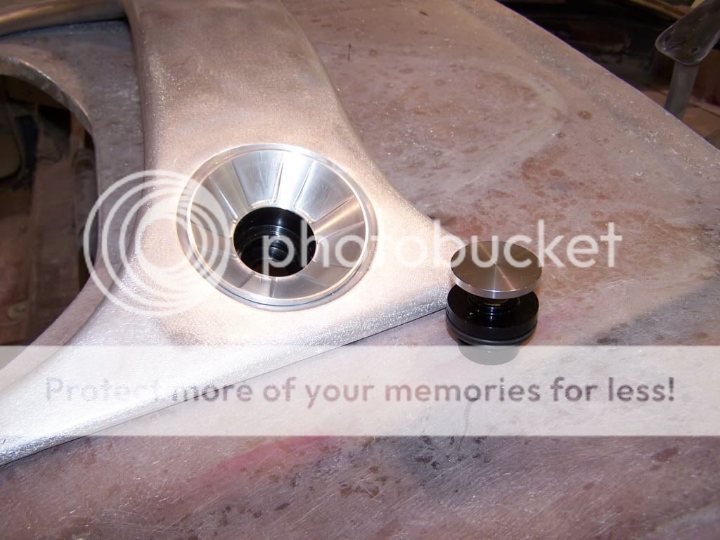

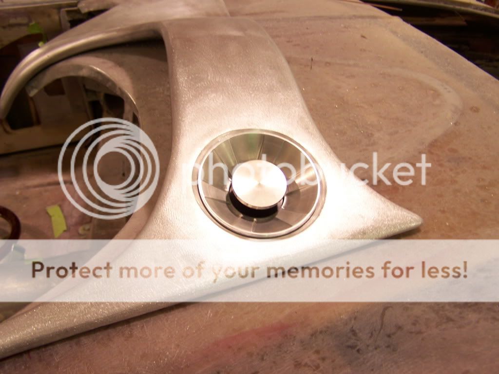

Roadster Shop 06-26-2009 04:10 PM

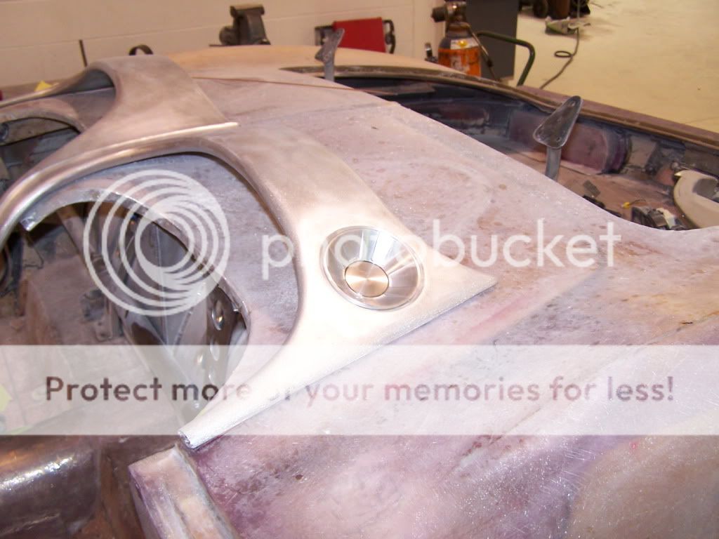

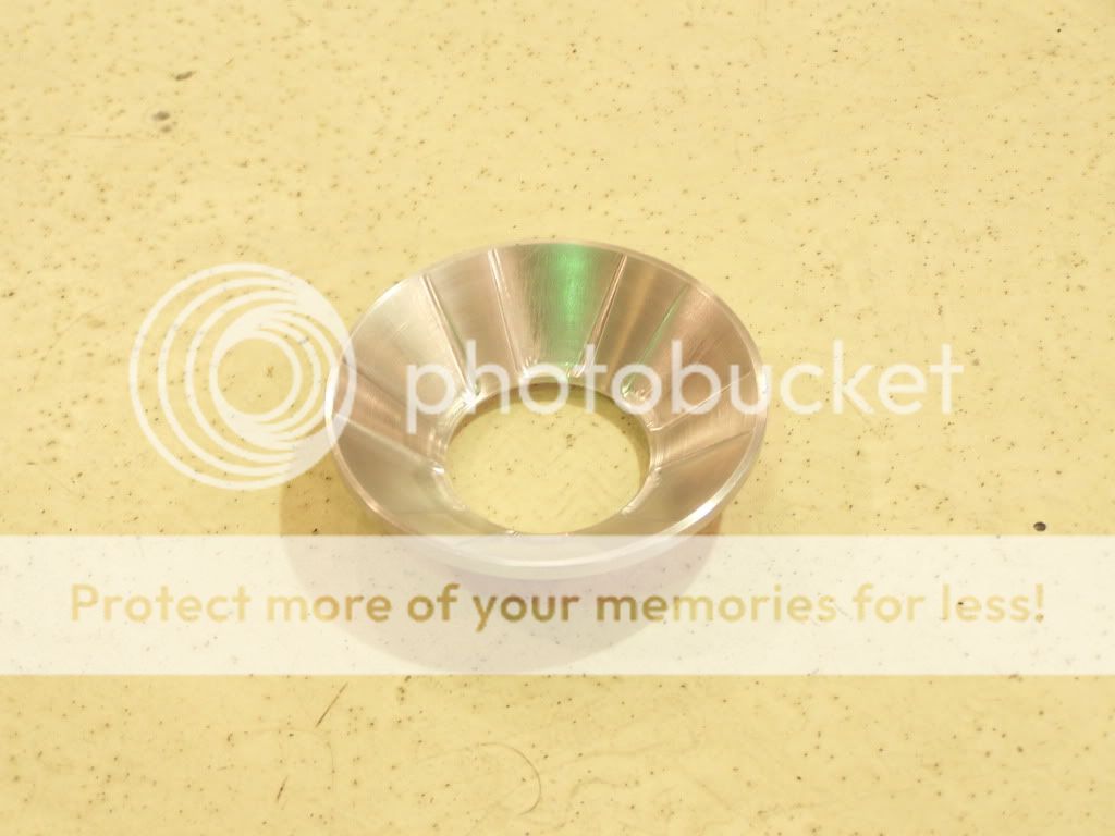

Pop up fuel filler in the side of the arch.
Machined a trim ring to match the headlights and a few other parts still to come on the car.
http://i563.photobucket.com/albums/ss79/RS-Perf/121.jpg
Then sunk that into the aluminum arch.
http://i563.photobucket.com/albums/ss79/RS-Perf/122.jpg
Push and twist to remove the center cap
http://i563.photobucket.com/albums/ss79/RS-Perf/123.jpg
http://i563.photobucket.com/albums/ss79/RS-Perf/124.jpg
