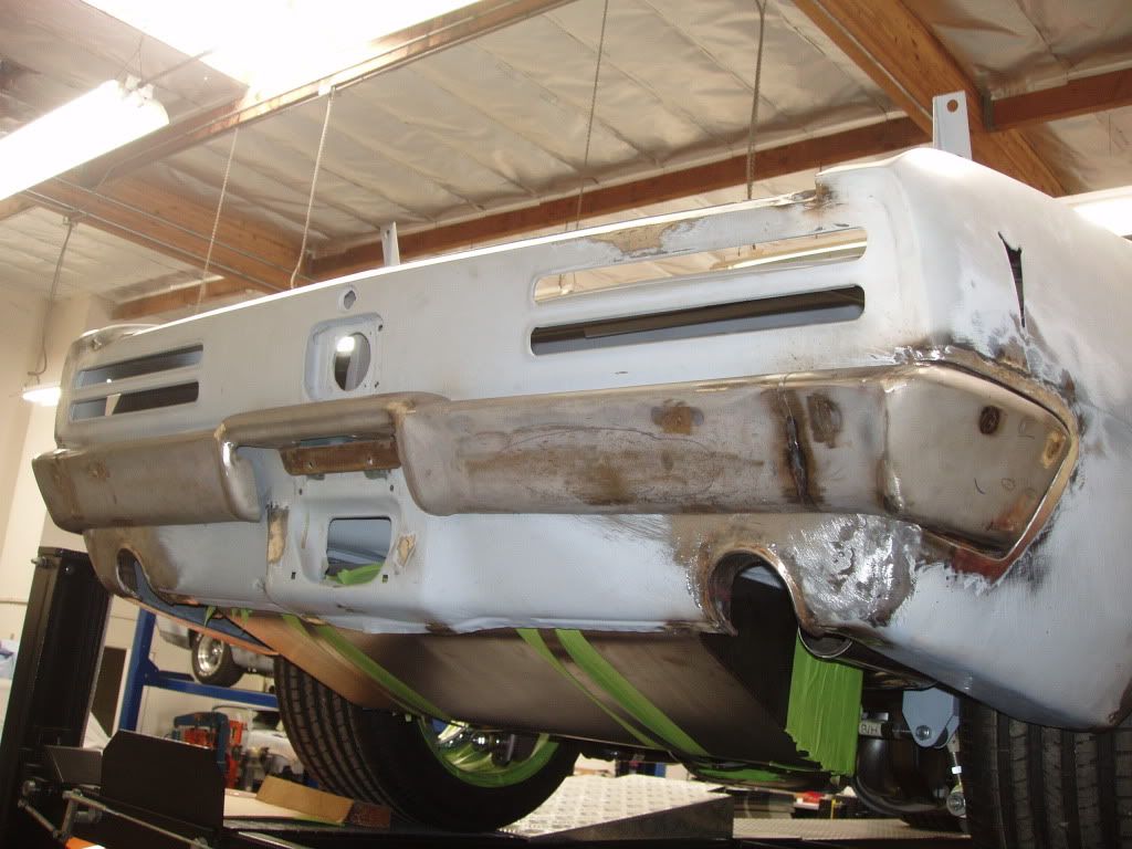

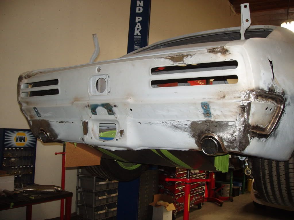

Tail Panel with Bumper

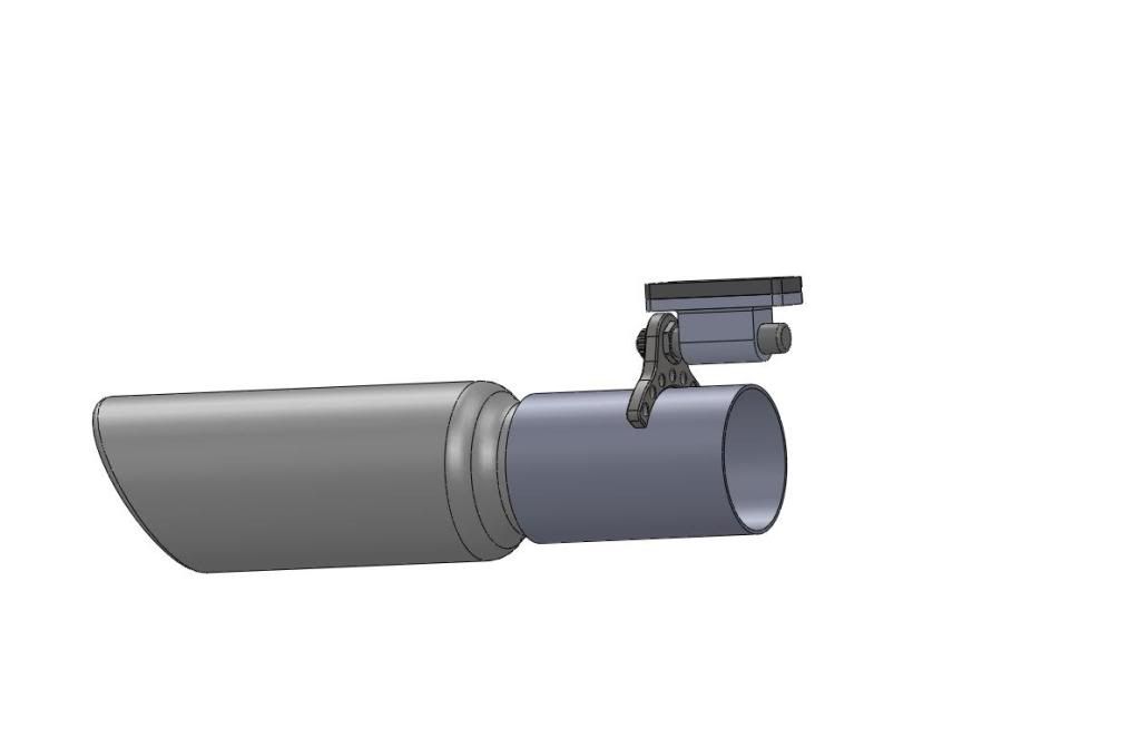

Here is the latest status on the bird.. We have rough finishes on the rear bumper with tail pipe openings.. We just finished the design on the tail pipe hangers & will have a pin to hold hangers with rubber o-rings to allow expansion of exhaust @ the rear.. When we machine these pcs I will post pic on how the concept works :D
http://i1015.photobucket.com/albums/...n/P2260036.jpg
http://i1015.photobucket.com/albums/...n/P3040045.jpg
http://i1015.photobucket.com/albums/...ntAssembly.jpg

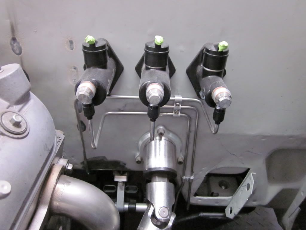

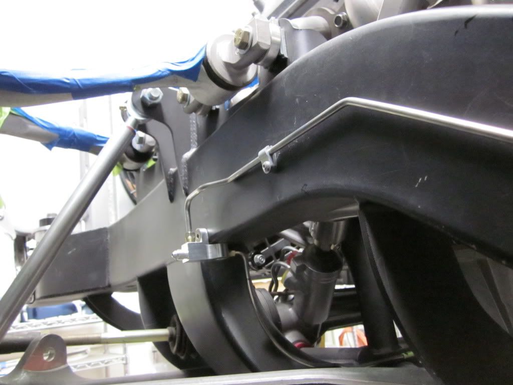

Cris@JCG 06-11-2010 08:15 AM

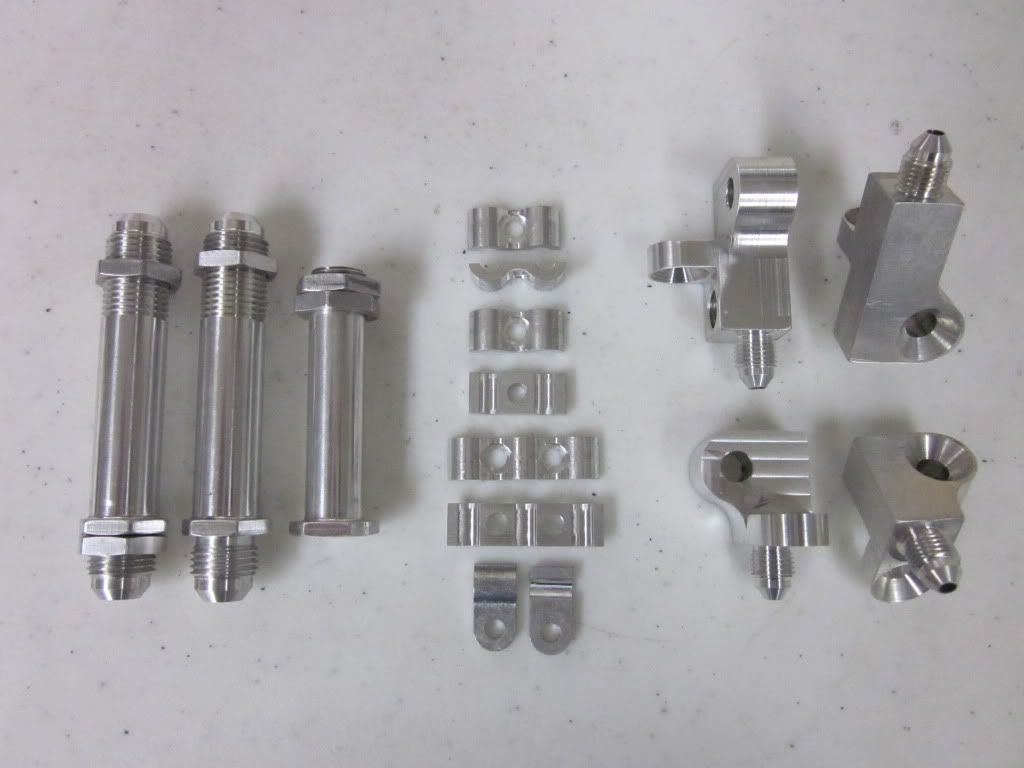

Plumbing!
We have been plumbing! Here is where we are @ so far..
Machining our own fitting, clamps, & distribution blocks..

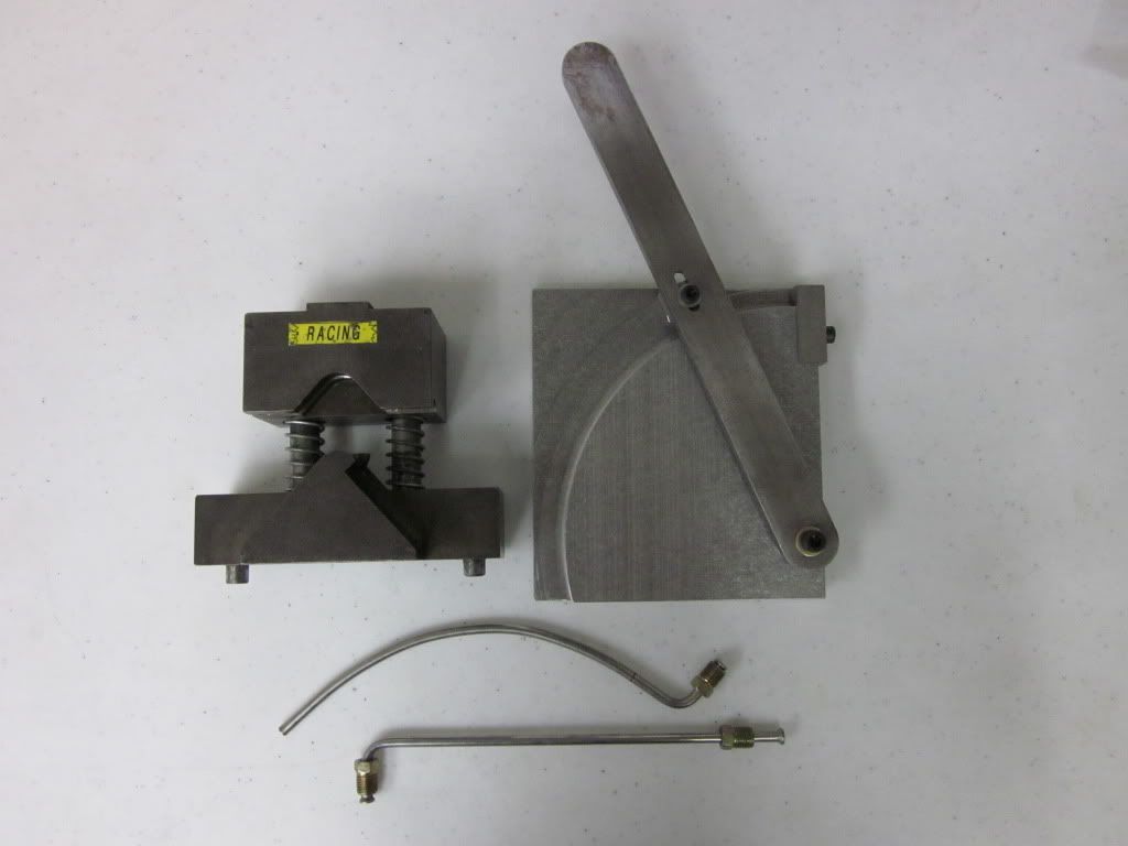

Designing & machining tools for bending..
http://i1015.photobucket.com/albums/...n/IMG_0145.jpg
Machining banjo fittings & bolts..
http://i1015.photobucket.com/albums/...n/IMG_0153.jpg

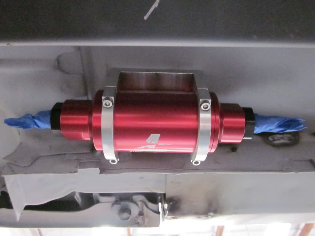

Machine our own filter retainer bracket.. I know.. I know.. We could have bought one!! :D
http://i1015.photobucket.com/albums/...n/IMG_0165.jpg

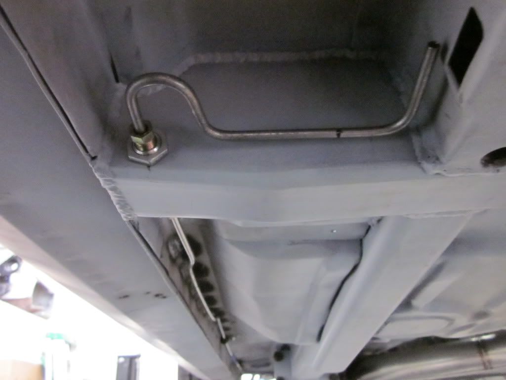

Some pics of the plumbing!
http://i1015.photobucket.com/albums/...n/IMG_0166.jpg
http://i1015.photobucket.com/albums/...n/IMG_0167.jpg
