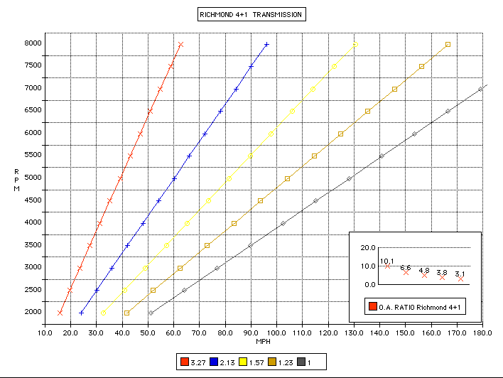

Here's a gear chart I did for our Richmond to plot shift points and rpm drops. Follow the chart to your shift rpm, then draw a line down to the next gear to read your rpm's you will be at after the shift.
FYI, a new Richmond is around $1900. The Hurst shifter is another $300, plus shipping and tax, then add a new yoke.
http://www.pozziracing.com/Media/richmond_chart.gif

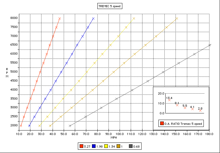

Here is a tremec for comparison. I did this chart a few years ago, so this isn't the newest Tremec model. Verify the gear ratios of whatever Tremec you are considering.
http://www.pozziracing.com/Media/Tremec_chart.gif
