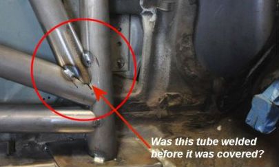

Originally Posted by Musclerodz (Post 435433)
This is the area I am speaking of.
http://i140.photobucket.com/albums/r...c/Untitled.jpg
I can see it is all tacked and would be full welded at a future point once full built, just did not know how far you would disassemble to fully weld.
I understand what you asking and we will remove that tube when we know the customer likes everything and fully weld that seam. We have it handled. I think
Musclerodz 09-11-2012 09:52 AM
No problem, I understand the direction, just observing the progress and enjoying the show. Thanks for clarifying. :thumbsup:

Vince@Meanstreets 09-11-2012 10:07 PM
I can see it is all tacked and would be full welded at a future point once full built, just did not know how far you would disassemble to fully welded.:thumbsup:
Most full custom cages get mocked up and tacked into place then a weld order gets established before it is all fully welded. It takes a lot of planning for a cages system especially as elaborate as this one. If not done right will make more work and wasted tubing later. If done properly some sections can be removed or disconnected from the chassis to be welded.
