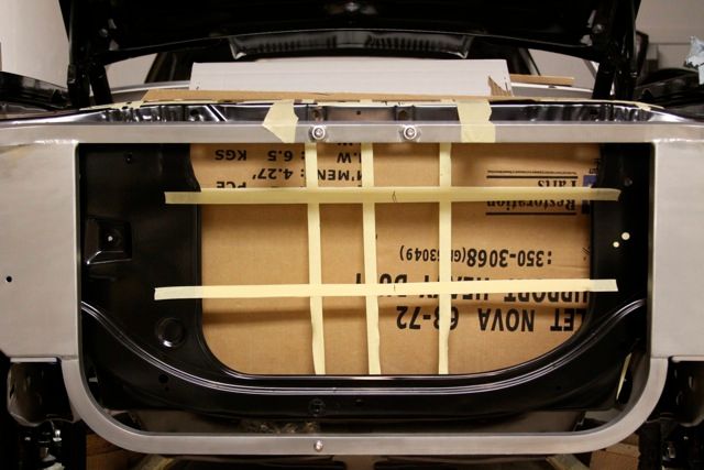

Here is a shot showing how much an Autorad gains you in radiator surface area. HUGE difference in opening size versus the OE style "heavy duty" core support.
http://i33.photobucket.com/albums/d6...ps77a364bb.jpg

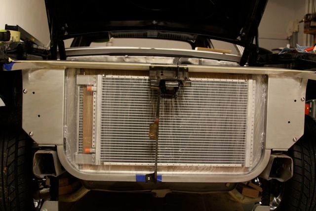

Here it is with the radiator installed. The condenser mounts directly to the radiator.
http://i33.photobucket.com/albums/d6...psafc61fe2.jpg

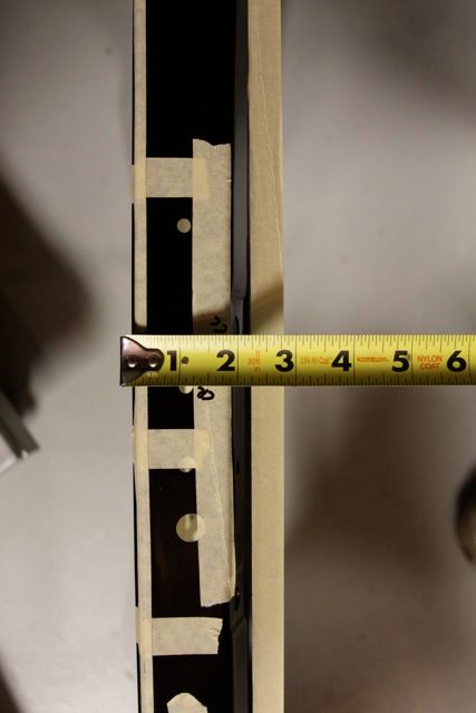

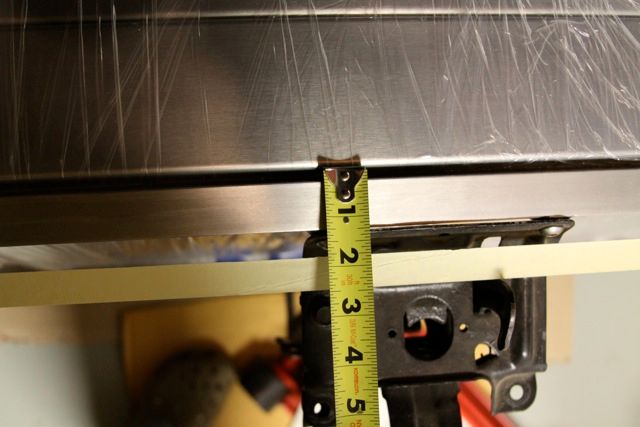

Here you can see better what I mentioned earlier in the thread about the Autorad radiator mounting surface not being so far back. The tape line is pulled between the center line of the rear most fender mounting locations on both the OE and Autorad support. You can see the Autorad radiator mounts .5" forward of the OE setup.
http://i33.photobucket.com/albums/d6...6b27bc45-1.jpg
http://i33.photobucket.com/albums/d6...906906-1-1.jpg
