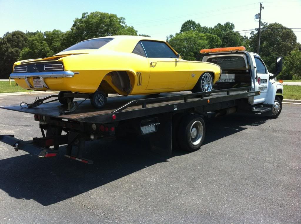

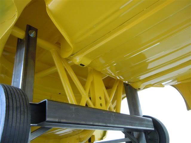

Payton King 07-20-2011 09:30 AM

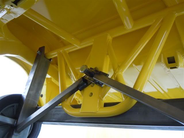

TIme to send the car off for the bottom to get
painted. Dan made a dolly. I guess I have the first pro-rik shah
http://i1138.photobucket.com/albums/...g/DSCN3051.jpg
http://i1138.photobucket.com/albums/...g/DSCN3057.jpg
http://i1138.photobucket.com/albums/.../IMG953892.jpg

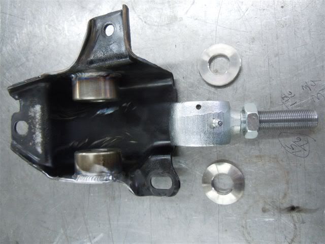

Payton King 07-20-2011 09:34 AM

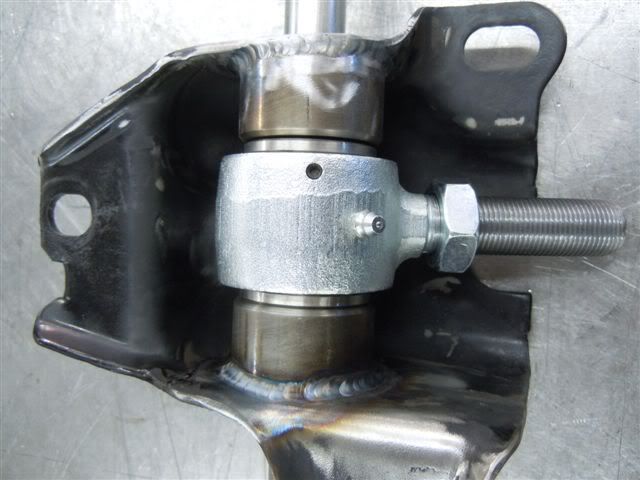

And because we cannot leave anything alone

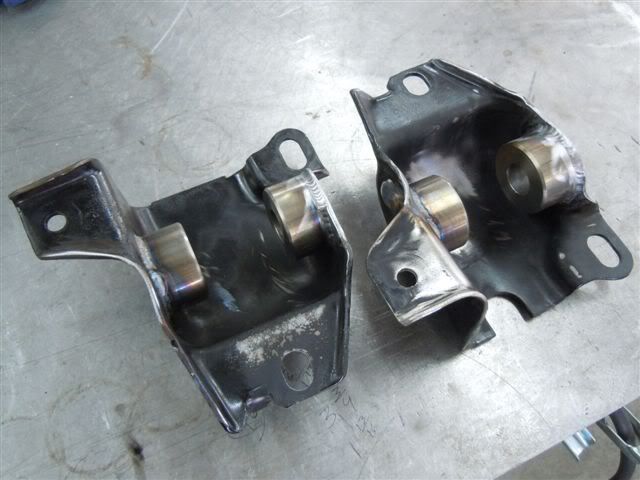

I decided I did not want to use the poly bushings and I was not hip to the heim joints, so I took JP;s advice and used the sphoon ends. Very nice piece but they are large, which made us modify the bracket on the housing and do a little work in the pocket. Turned out nice
http://i1138.photobucket.com/albums/...g/DSCN2927.jpg
http://i1138.photobucket.com/albums/...g/DSCN2926.jpg

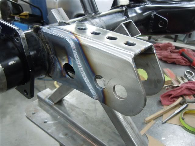

Payton King 07-20-2011 09:36 AM
wrong pic in the middle
http://i1138.photobucket.com/albums/...g/DSCN2940.jpg

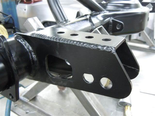

Payton King 07-20-2011 09:38 AM
here is what we did in the pocket
http://i1138.photobucket.com/albums/...g/DSCN2768.jpg
Conical washers too
http://i1138.photobucket.com/albums/...g/DSCN2769.jpg
http://i1138.photobucket.com/albums/...g/DSCN2771.jpg
