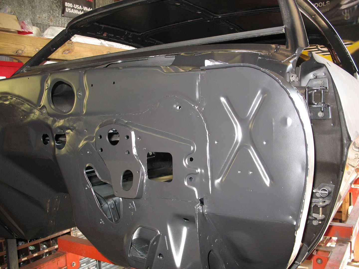

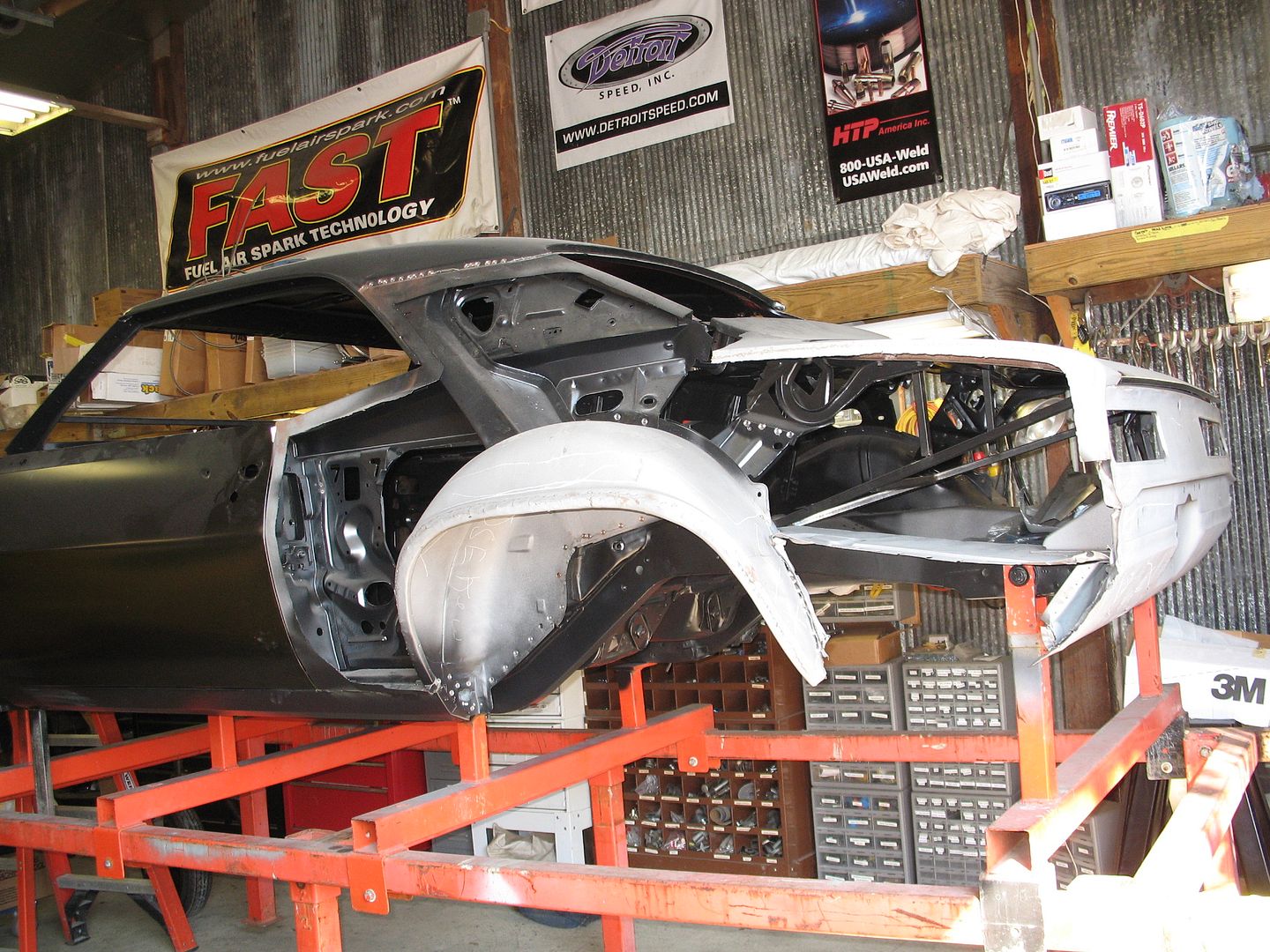

Getting back to Lou's Change, I'm happy to report we've officially turned the corner and the body shell is now "coming back" vs. being disassembled and cut up.
I know I've said it before but I really appreciate the fact that V8TV does all this work with the shell welded to their jig so things will all be nice and square when its done.
http://i1140.photobucket.com/albums/...psf0c7b754.jpg

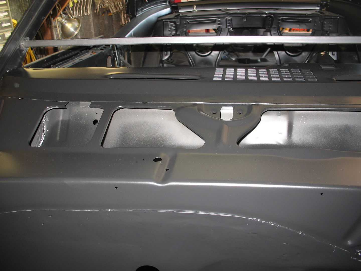

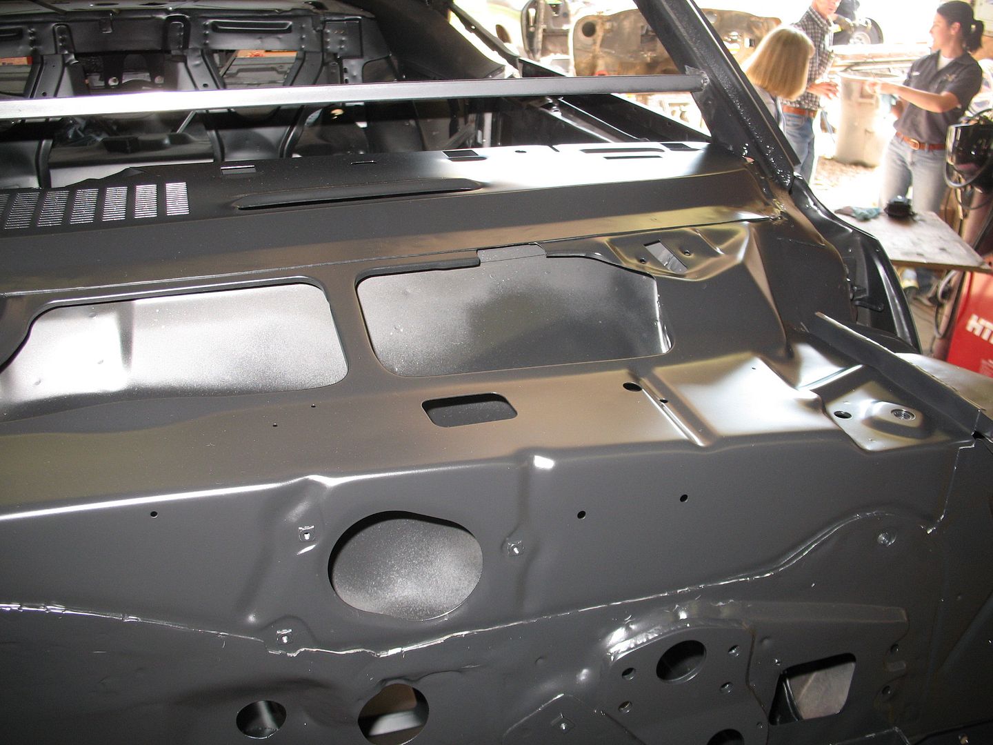

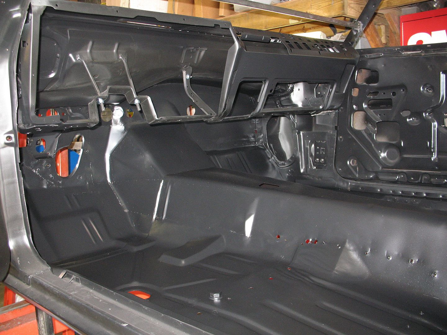

Nick removed the inner and outer dash along with the upper firewall for replacement.
http://v8tvshow.com/1969_Camaro_LC/s...9.21.12_55.JPG
http://v8tvshow.com/1969_Camaro_LC/s...9.21.12_57.JPG
The lower firewall flange was still in good condition.
http://v8tvshow.com/1969_Camaro_LC/s...9.21.12_61.JPG
http://v8tvshow.com/1969_Camaro_LC/s...9.24.12_04.JPG
New dash and upper fire wall installed. A little more dolly work will make it all better than new.
http://i1140.photobucket.com/albums/...ps09a71bc0.jpg
http://i1140.photobucket.com/albums/...pscb8832d7.jpg
http://i1140.photobucket.com/albums/...psb4118d4c.jpg
The floors have also been repaired and look good. The trans tunnel mods are already done in order to clear the Magnum T56.
Since the repairs in the floor are all butt welds, a little more weld clean up and dolly work will make the repairs virtually undetectable.
http://i1140.photobucket.com/albums/...ps99a5c1fa.jpg
