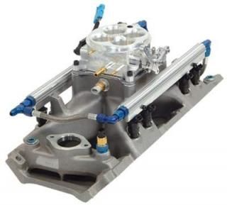

Well the LT4 is out of a corvette and has been rebuilt. I am going to do a direct port injection on the carb type manifold and run an air valve so I can put the stock cowl type air cleaner on the car. This will give it a stock look with the valve covers off a 69 Z28 and the block painted orange. The goal is to make this car look like it came from GM back then but with modern suspension and electronics to make the drive more comfortable.
Here is the Direct Port Injection.

WSSix 12-12-2013 05:32 PM
Ed can you give me some more details on that intake? I wasn't aware anyone was making a direct port carb style intake for LT motors. That could really work well with my TA.

Trey,
If you go to www.azspeed-marine.com you can call and they do the direct port on the LT1 GM carb manifold. They use the FAST throttle body and wiring. The manifold is still offered from GM Performance Parts and they just make the fuel rails and drill the holes for the injectors.

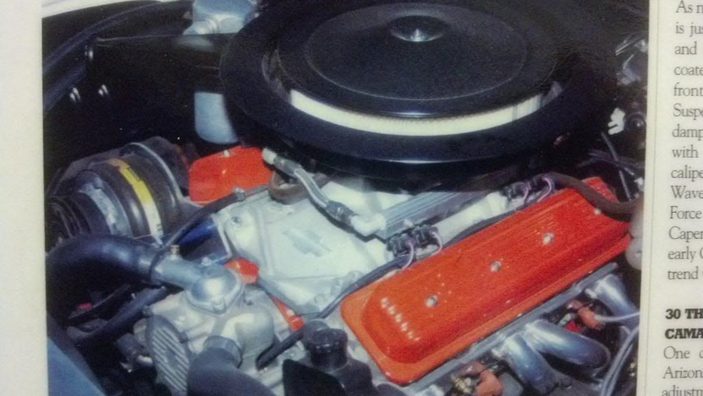

I have used this before on a 69 Camaro I built that was on the cover of Chevy Rumble Magazine December 2001.
Here is a very bad picture of what it looked like from the magazine.

Hope that helps.
Ed
