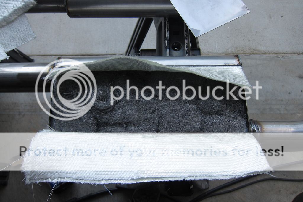

Home made ones :D They are a straight through design with louvered through pipes. I laid down fiberglass mat first, then stuffed the muffler full of steel wool.

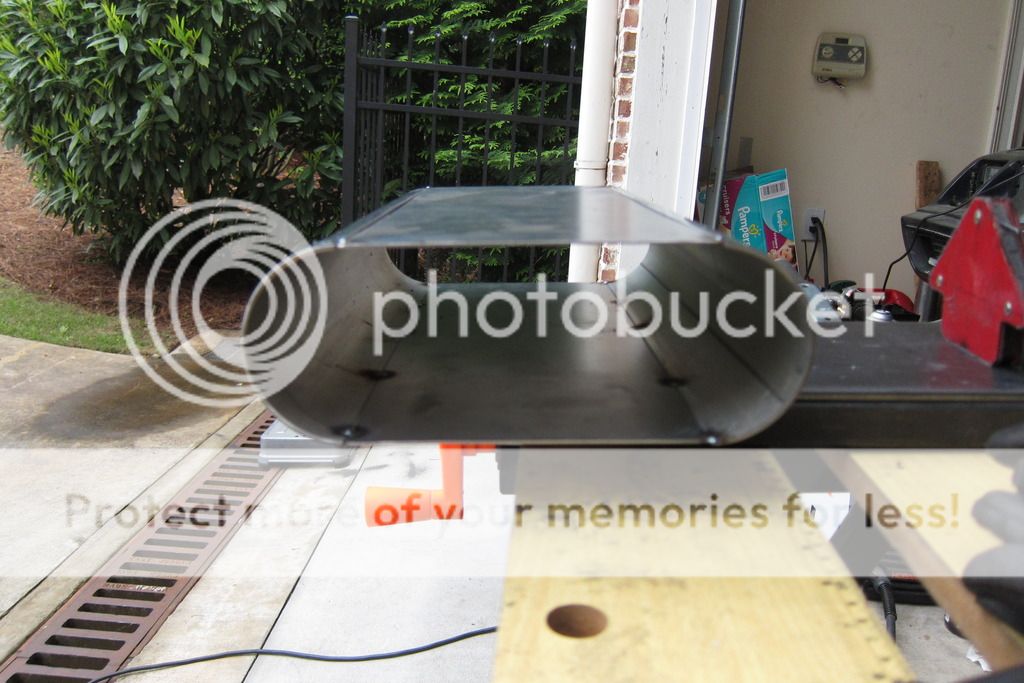

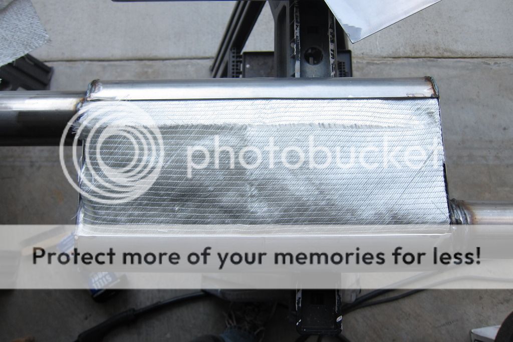

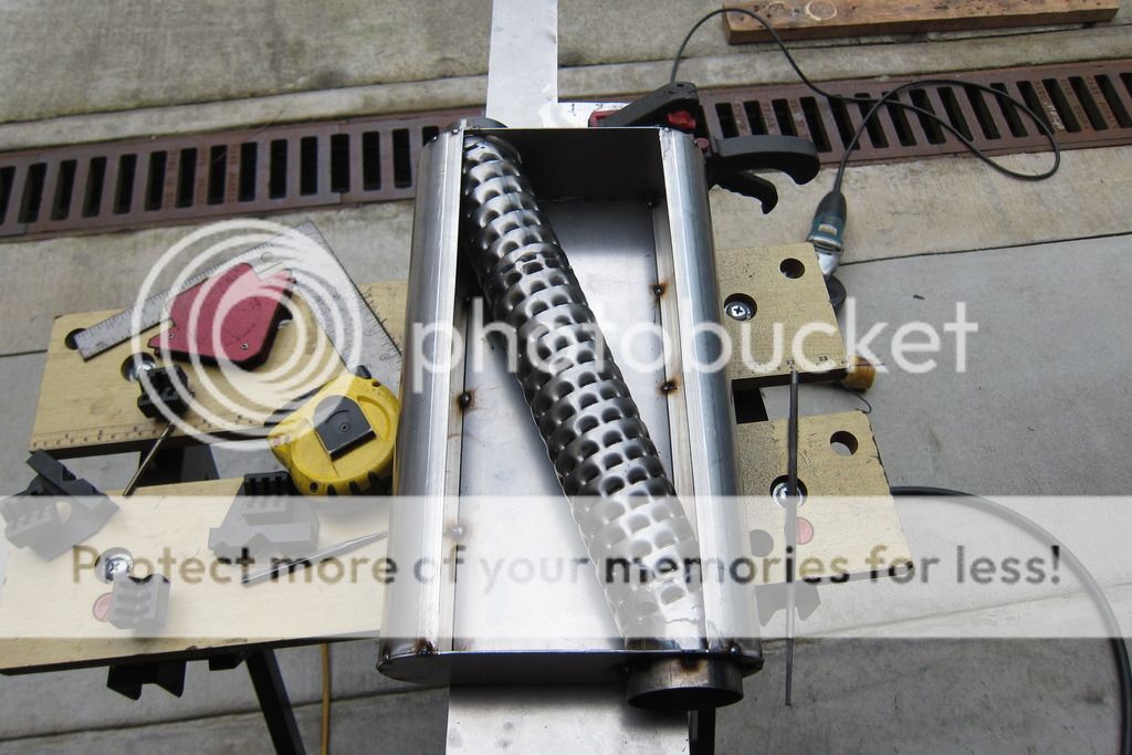

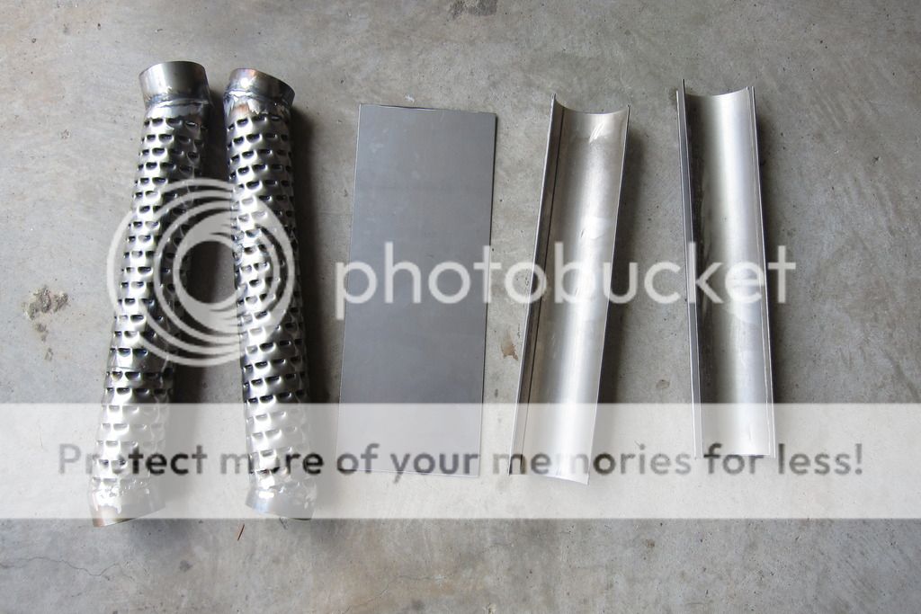

On to the pictures. I made my own mufflers before I realized I could actually buy similar size mufflers from both Spintech or Flowmaster. The design is a 3 inch thick muffler that's 2.5 inches straight through. I laid fiberglass down first and then stuffed steel wool all around the inside of the muffler before putting the top plate on. I got the idea to do it this way from looking at cut away pictures of Magnaflows and watching videos on youtube. Hopefully, it holds up well.
