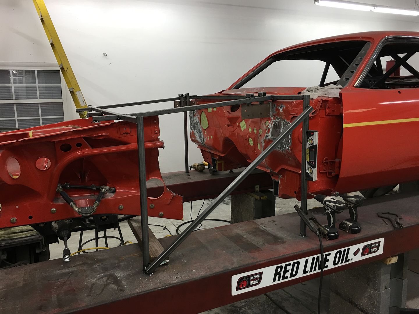

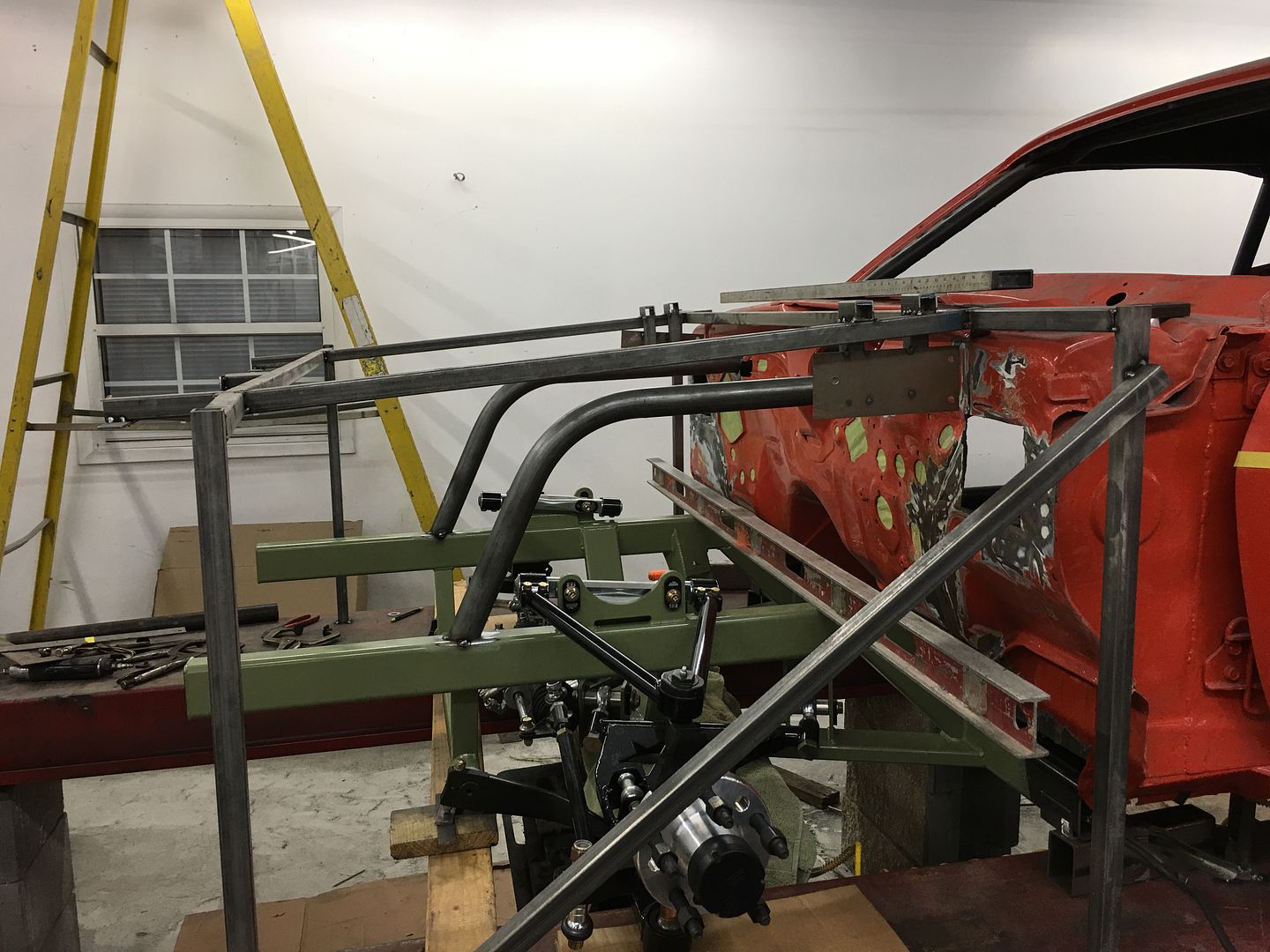

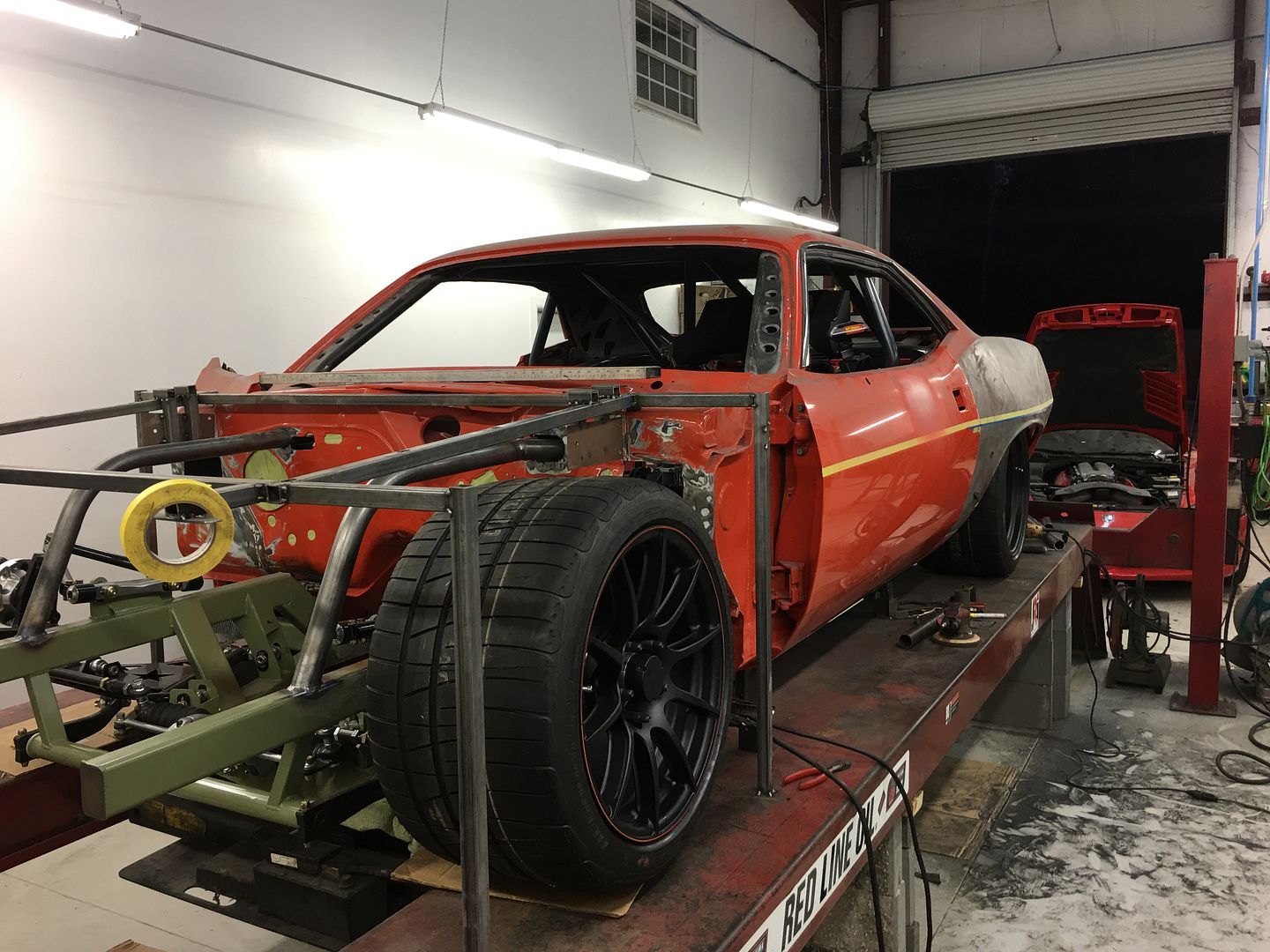

Little bit, got the front on and some support bars in.
http://i1060.photobucket.com/albums/...psabllf8h0.jpg
http://i1060.photobucket.com/albums/...pshrelia0r.jpghttp://i1060.photobucket.com/albums/...psivk6fq00.jpg

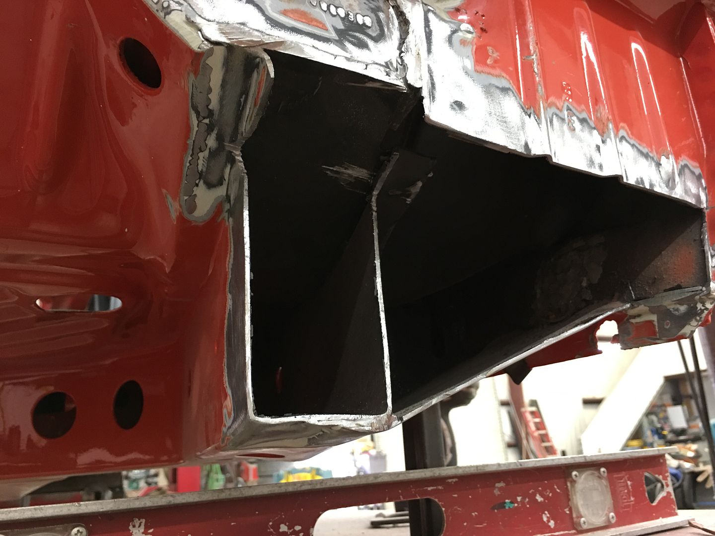

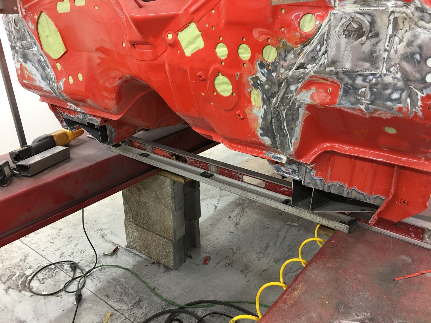

I notched the existing frame structure to accept the 2x3" rails of the clip. The car is locked down, so made careful measurements and cuts to fit everything nice and tight.

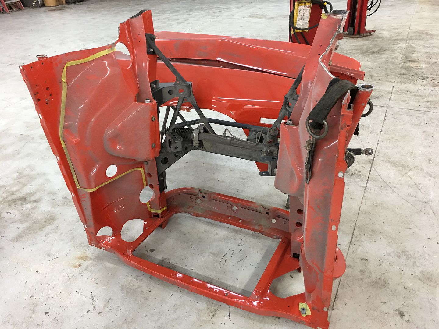

http://i1060.photobucket.com/albums/...ps67jjeuof.jpg
http://i1060.photobucket.com/albums/...psgogybgzo.jpg
http://i1060.photobucket.com/albums/...pseibnrnif.jpg

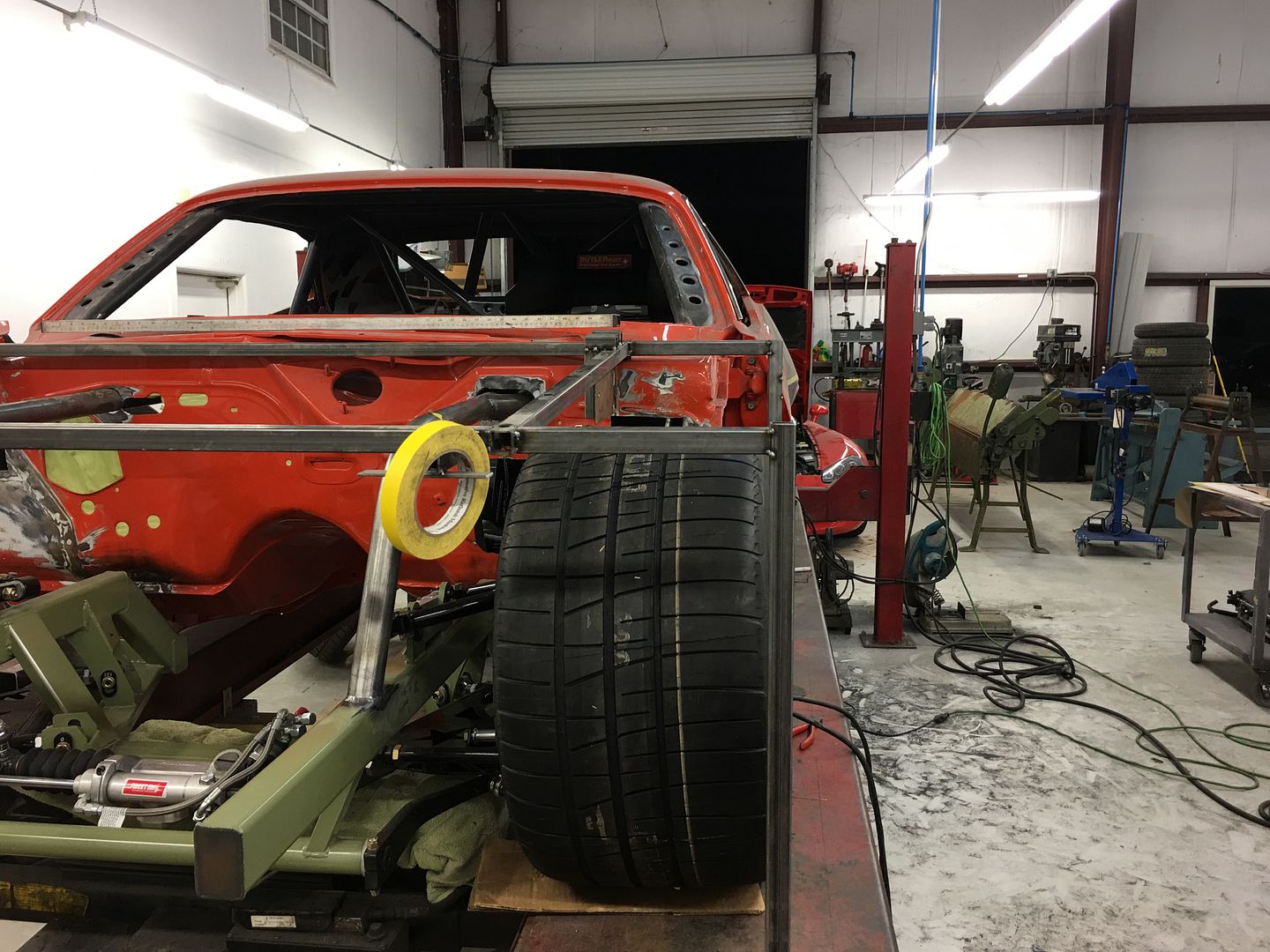

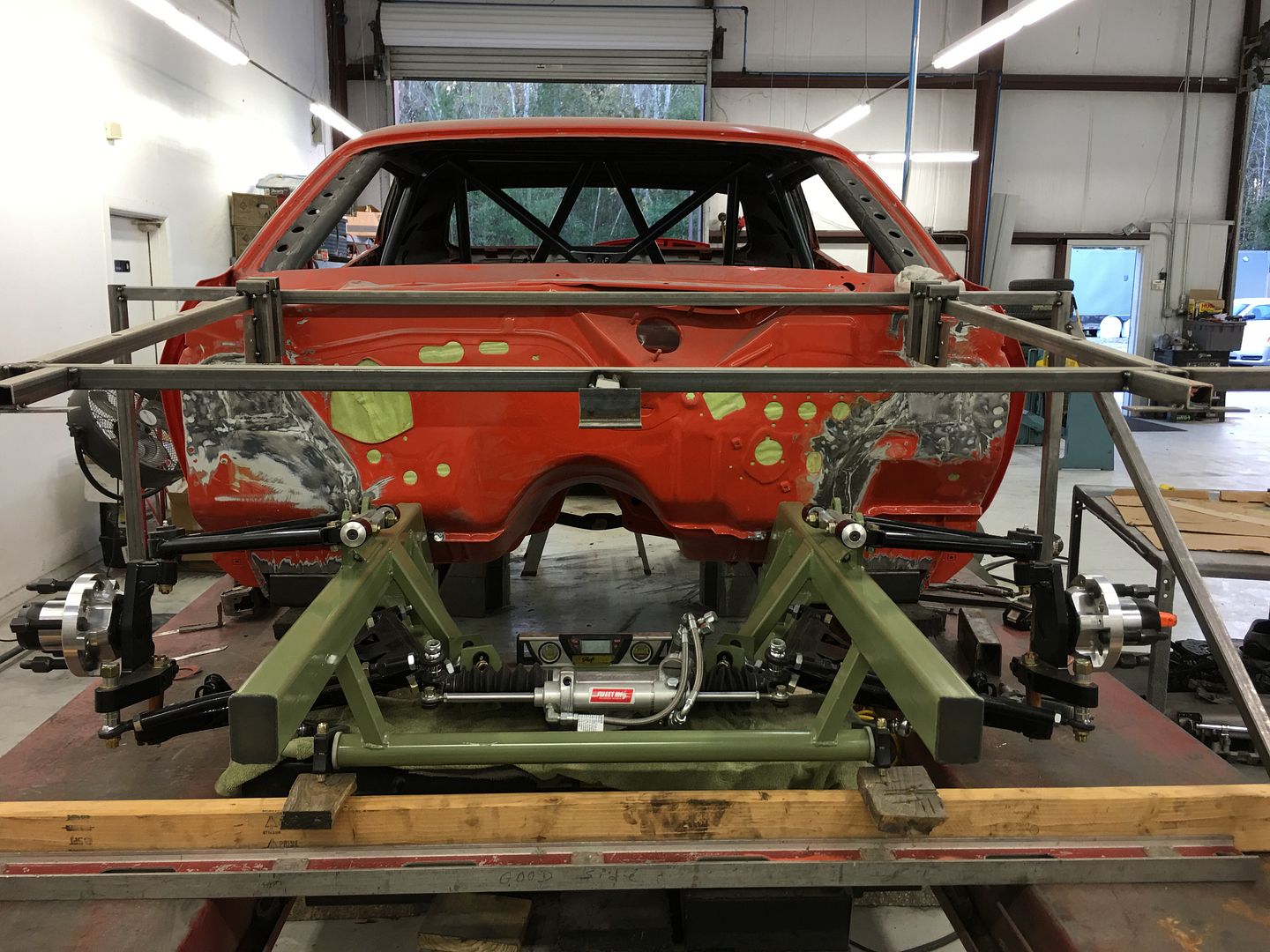

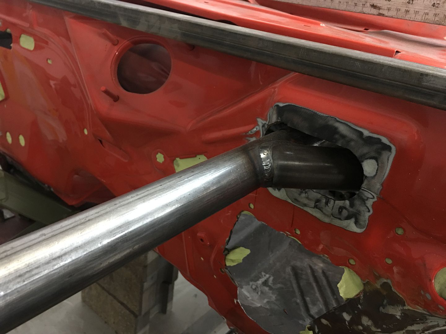

So after fitting, took some measurements and everything was way off. WTH? Turns out Ron sent the front blueprint with a different ride height than everything else. So back out, lower the sub and fix and fill in all the careful cutting and fitting, then refit. Lots of time wasted here.
