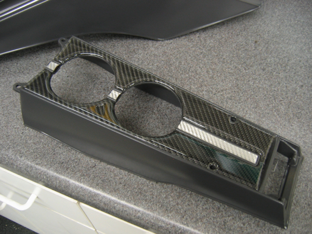

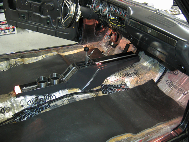

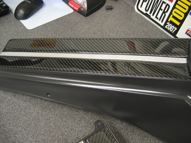

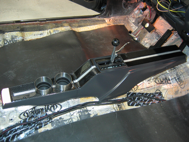

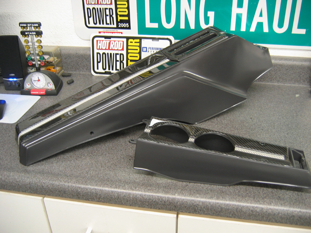

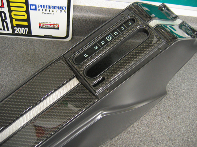

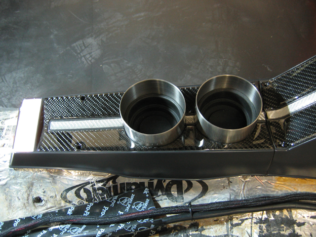

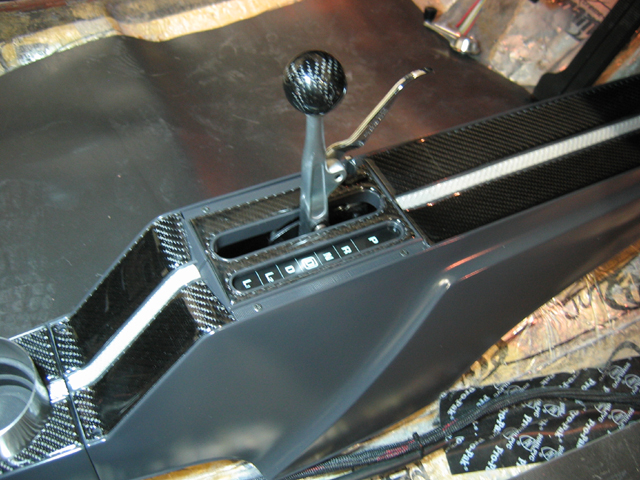

Painter Jim :yes: showed up today, and painted the small metal section under the rear window in the dark gray matte finish. Now I can have the front and rear windows installed this week.
I also got my carbon fiber console pieces from Wabbits inTexas. Guys do great work, and they got them to me fast. Here's a few pics of how it turned out.
