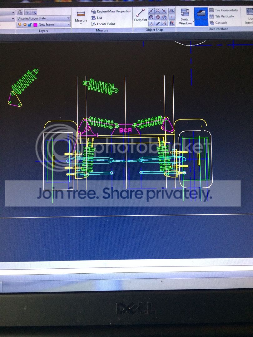

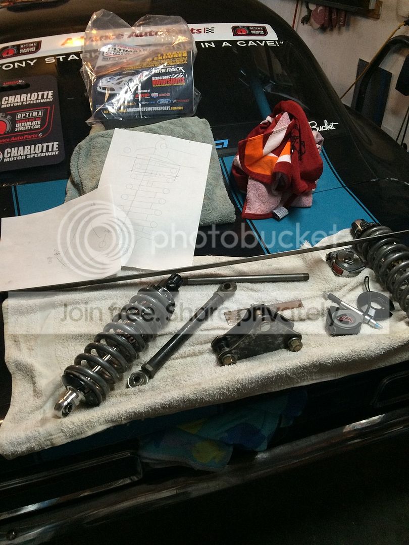

Updates! I'm coming back out of hiding for all the winter project updates. After Optima in Charlotte I needed to take a break on car stuff (according to my wife). Now I'm back on all the winter projects. After Charlotte I found I had broken both rear shocks off at the tip on the last session of the hot laps. Other than that, nothing else was broken! Now I have some time to work on my "nice to do" list instead of "I gotta make the next race" list. Since both shocks were broken in the same place I decided it was time to re-engineer the whole coilover setup in the rear. I never really liked it to begin with and I've been wanting to go inboard for a long time, so I finally took the time to start actually doing it. Here's some shots of what I have so far.
http://i539.photobucket.com/albums/f...psop7ulbht.jpg
back to the drawing board...

GregWeld 11-28-2015 08:10 AM
Nice project!
It bothers me, however, that both shock tops broke off like that.... and I wouldn't sleep well until I discovered what was putting that kind of bind (or whatever) on them to make that happen. My radar would be up that something else in the car was moving around and trying to make the shocks act as some kind of rear end locator....
Beach Cruiser 11-28-2015 08:16 AM
yeah it bothers me too. I did spin off the track and came back on it sideways with both rear wheels and it took a pretty good hit, I'm about 90% sure that's when the broke. I came in after that and didn't run again. I noticed they where broke when I loaded it on the trailer. I was hard to tell because they still looked intact because the weight was holding everything together still. I've taken the new setup through full ranges of motion and every scenario I can think of and it looks solid.
GregWeld 11-28-2015 05:24 PM
Ah ha!! Yeah -- that could certainly explain the issue!! I cut a Hoosier doing that once.... a spin with only the back two going off a little and coming back on. There's a LOT of sideways pressure going on there that the car doesn't like!! LOL
MX145 11-28-2015 06:56 PM
Very cool inboard setup :cheers:

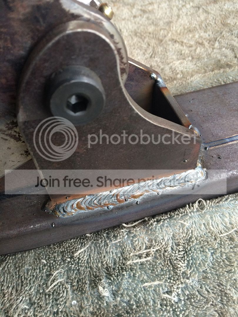

Almost got the Inboard setup done, the disaster struck. Some low life decided to steal my welder! mostly my fault for leaving it outside by my workbench, still hidden from street view but someone must have been staking it out. Lock your stuff up fellas, I made a mistake and now my welder is gone. Anyway, while I'm dealing with the police, here is the progress pics that I have up until now.
Relief pockets in the frame all done.
http://i539.photobucket.com/albums/f...pslubthucr.jpg
Not a bad weld not having any practice in a while...
http://i539.photobucket.com/albums/f...pspcjdhvz2.jpg

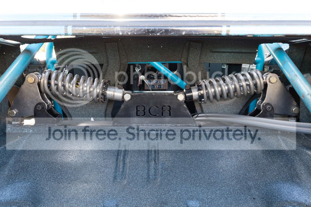

Beach Cruiser 01-11-2016 08:35 AM
All finished up! well almost. I still need to make some covers for inside the wheel well to try and keep most stuff out of the trunk from the pushrod reliefs. Got it back on the ground after Christmas and was able to drive to our local Cars and Coffee Jan 2nd. Everything worked perfectly, its actually smoother and quieter than the previous setup! Its really hard to keep my focus on the road instead of watching it all work through the trunk in my rear view mirror! I haven't beat on it hard yet, but I did take it through its paces on a really rough road.
http://i539.photobucket.com/albums/f...psm1dy5qyg.jpg
http://i539.photobucket.com/albums/f...pslzfewkvv.jpg
http://i539.photobucket.com/albums/f...ps6nw4zoil.jpg
http://i539.photobucket.com/albums/f...psl2czo0bm.jpg

Chad-1stGen 01-11-2016 10:29 AM
I can't remember. What was the reason for the inboard pushrod setup? Are you able to fit longer shocks now?
romayo 01-11-2016 10:35 AM
you can lower the car where the tunnel is the limiting factor. you'll have more shock travel
very popular modification when students compete in FSAE
Beach Cruiser 01-11-2016 11:06 AM
Partially true, I never liked the way they had to be mounted under the car to clear all the IRS stuff, over time and racing (and wrecking) I snapped the top off them 3 times. Plus it looks cool!
Chad-1stGen 01-11-2016 12:21 PM
It does look cool! I was blown away but this style of setup when I saw it in Mike Maier's Mustang years ago.
19,69camaro 01-11-2016 12:34 PM
Cool! What did you use for the bushing or bearing?

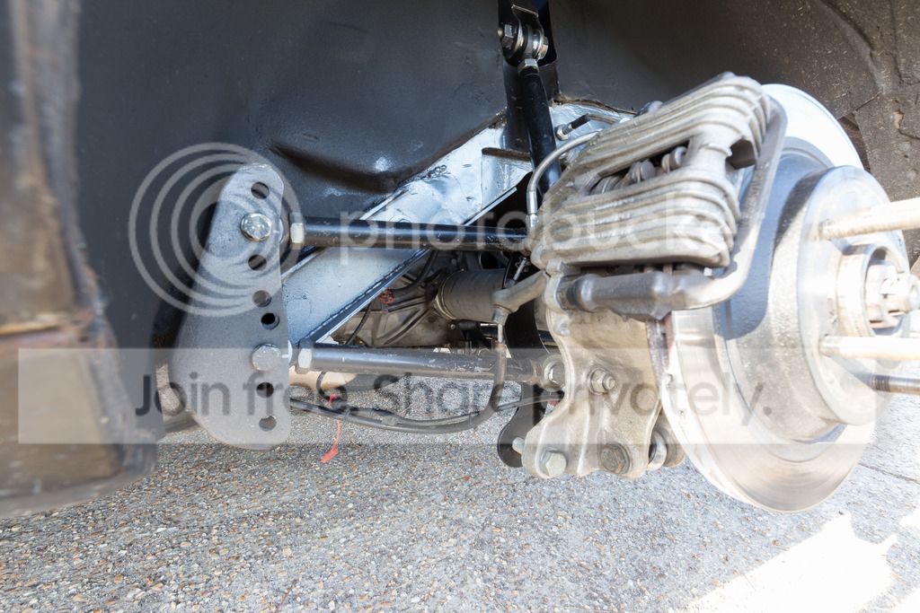

Beach Cruiser 01-13-2016 03:15 PM
I used oil impregnated Bronze bushings on each side pressed into the rocker. There is a tube in between the plates where I have a grease fitting so I can fill it full of grease. The bolt through the middle is called an axle bolt and it only has threads on the end so the shank and the bore of the bushing is the same. Perfect fit actually, It took me a while to figure out how to do it cheaply, but it works great, and if it wears I can replace the bushing for about 85 cents each!
19,69camaro 01-14-2016 08:26 AM

First AutoX today with the new setup, everything worked perfectly! I need to adjust the ride height and re align everything. The camber and toe was pretty far off, I just didn't have time to deal with it before the AutoX. Next stop, New Jersey Motorsports Park to get a little seat time around the Thunderbolt course to prep for the Optima event there in May. JonnyMac even came out for a ride today.
http://i539.photobucket.com/albums/f...psbbjnrxvm.jpg
No more low hanging Coilovers!
http://i539.photobucket.com/albums/f...psgsrmixha.jpg
