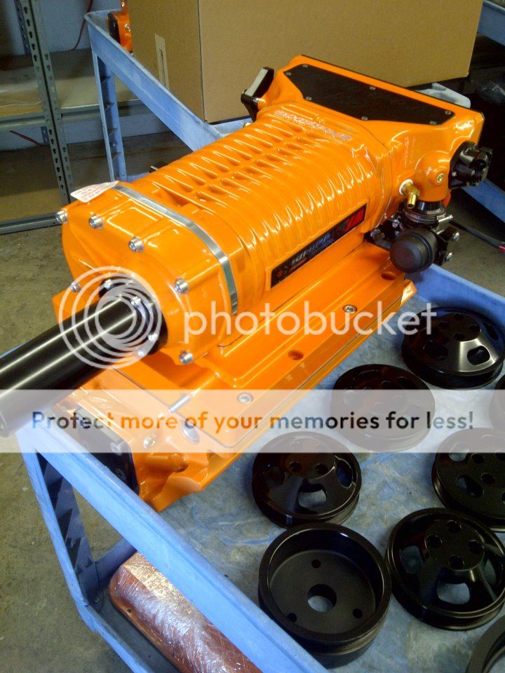

Looks like this might be the new direction. Orange Paint with the Gripp Equipped Drop Kick wheels. Should be interesting.
http://i616.photobucket.com/albums/t...revision-1.jpg

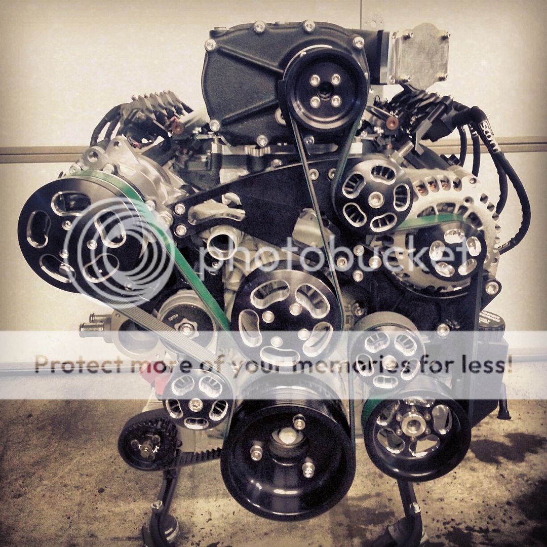

Looking at a Whipple Supercharged LSX engine with the Wegner Front drive for the billet Dailey Dry sump pan.
http://i616.photobucket.com/albums/t...ngewhipple.jpg
http://i616.photobucket.com/albums/t...lowerdrive.jpg

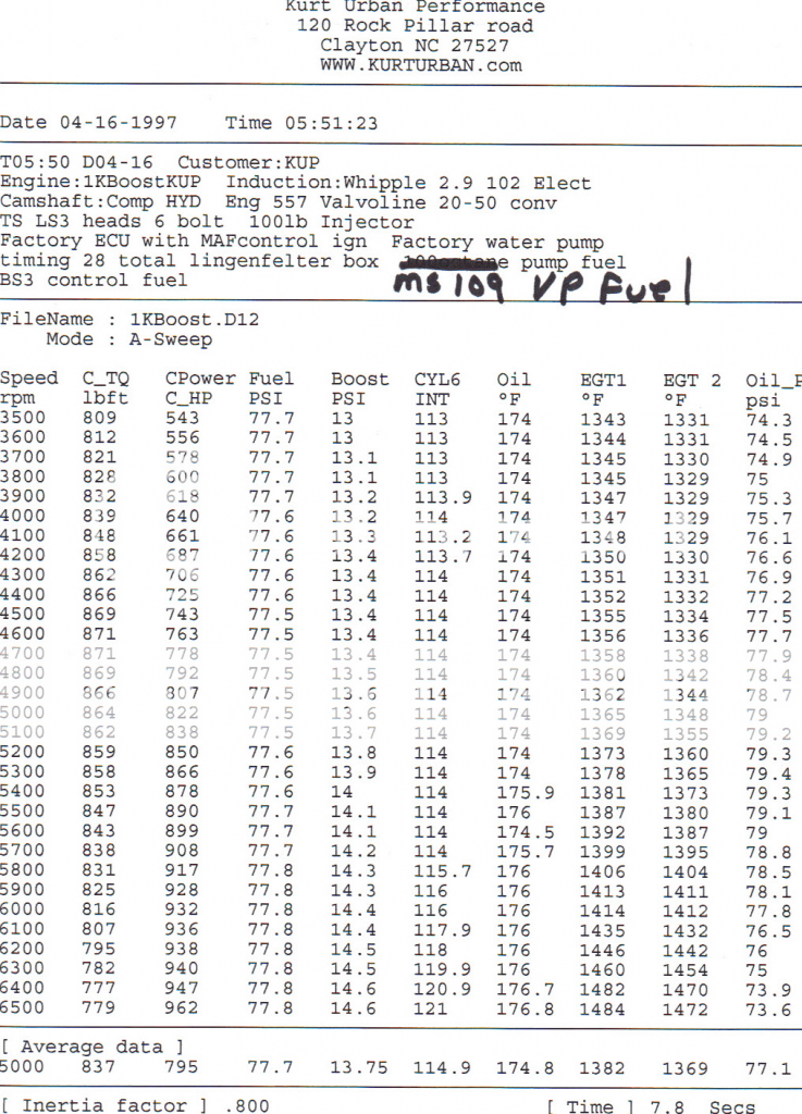

I like the orange better than the green. Those whipples make some serious power, Kurt just put our blower test mule on the dyno last week, first pull it made 962 hp and over 800 lb/ft@3,500 rpm, the timing was only 13* and it was lean, we had to stop since it pitched the water pump pulley off.
http://i1009.photobucket.com/albums/...g71/29dyno.png

ironworks 04-08-2013 03:18 PM
You will have to get me some info on the Kurt Urban Crate engine package. That sounds like it would be right up our alley. We are running the Whipple because we are have a really good connection in the fact the owner of the car know the owner and I met him a few weeks ago at a dirt race. And the owner of Whipple is looking to have us do some custom work on a big hp 57 Chevy he is building.

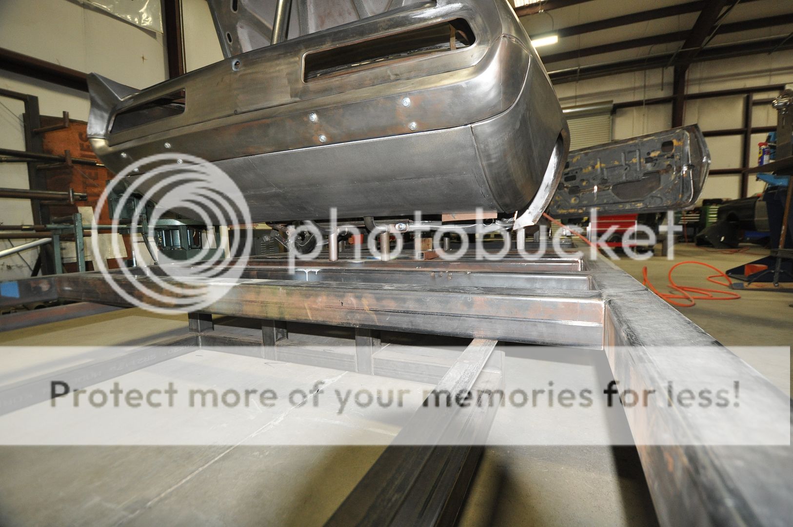

Well I'm a little behind on updating this project but let me see what I can get handled this Morning.
We did our first months worth of work for the new owner, Troy. We are working to try and get the engine as low as possible with the Dailey Dry sump pan that is on it. We have a ton of clearance under the pan but the limiting factor is the bellhousing. So we have been exploring going to a relocated starter with a triple 7.25" clutch from Tilton or QuarterMaster.

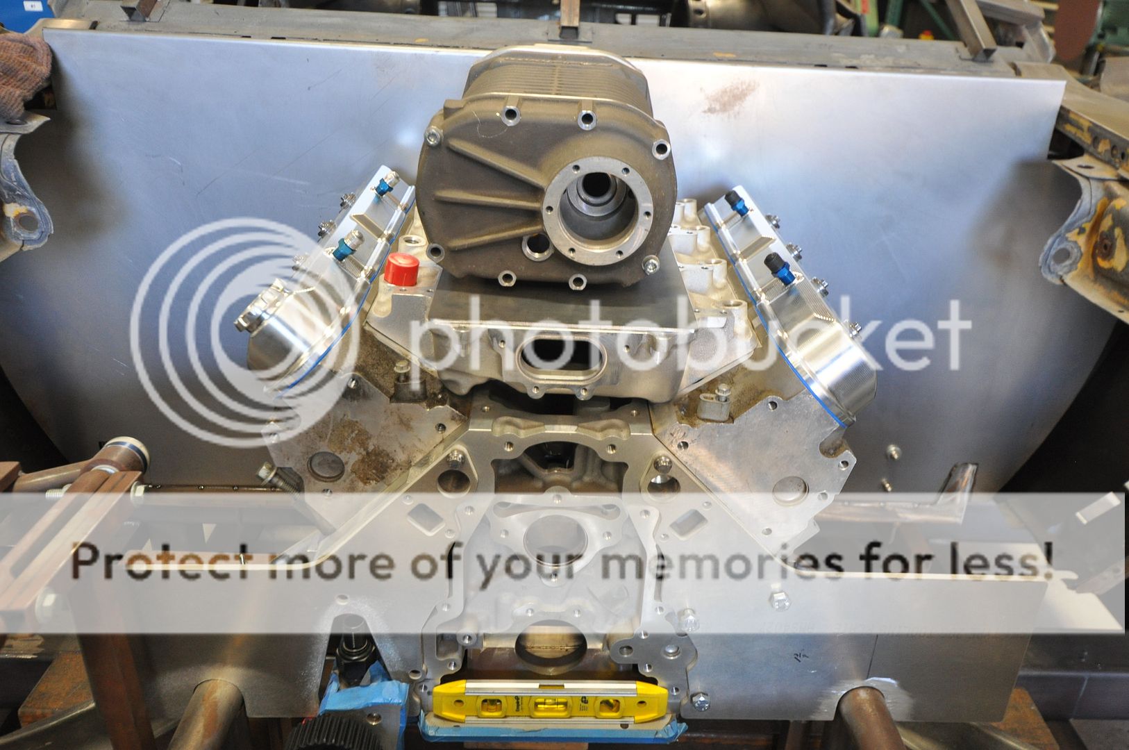

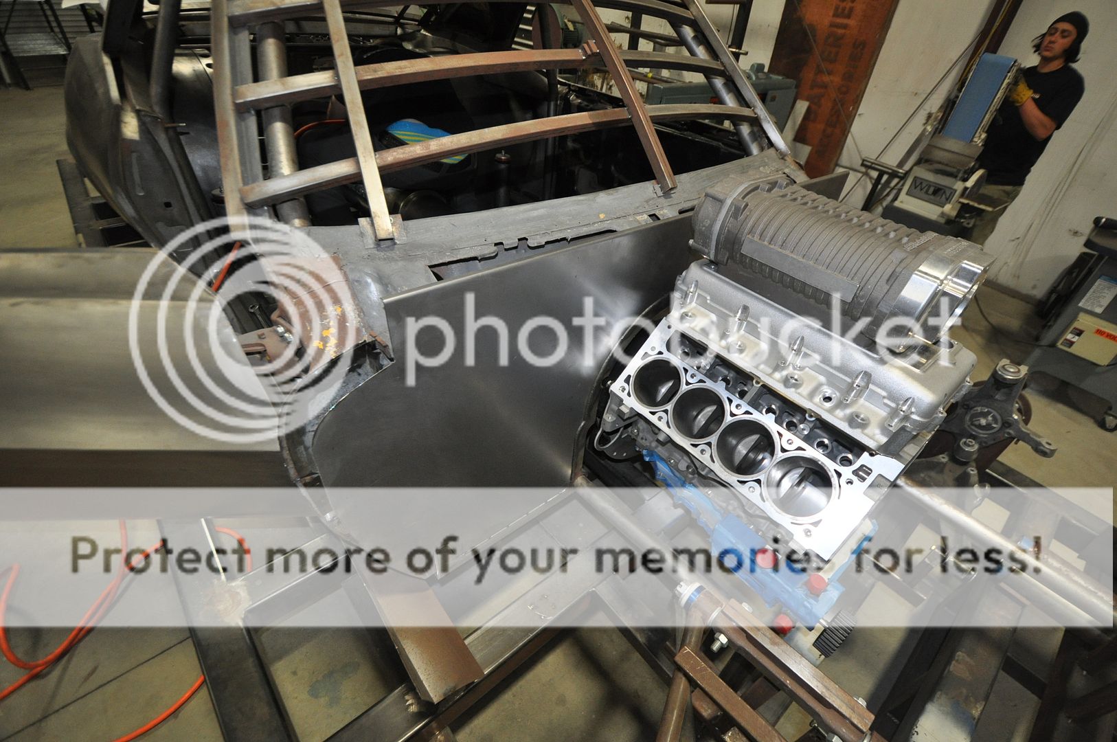

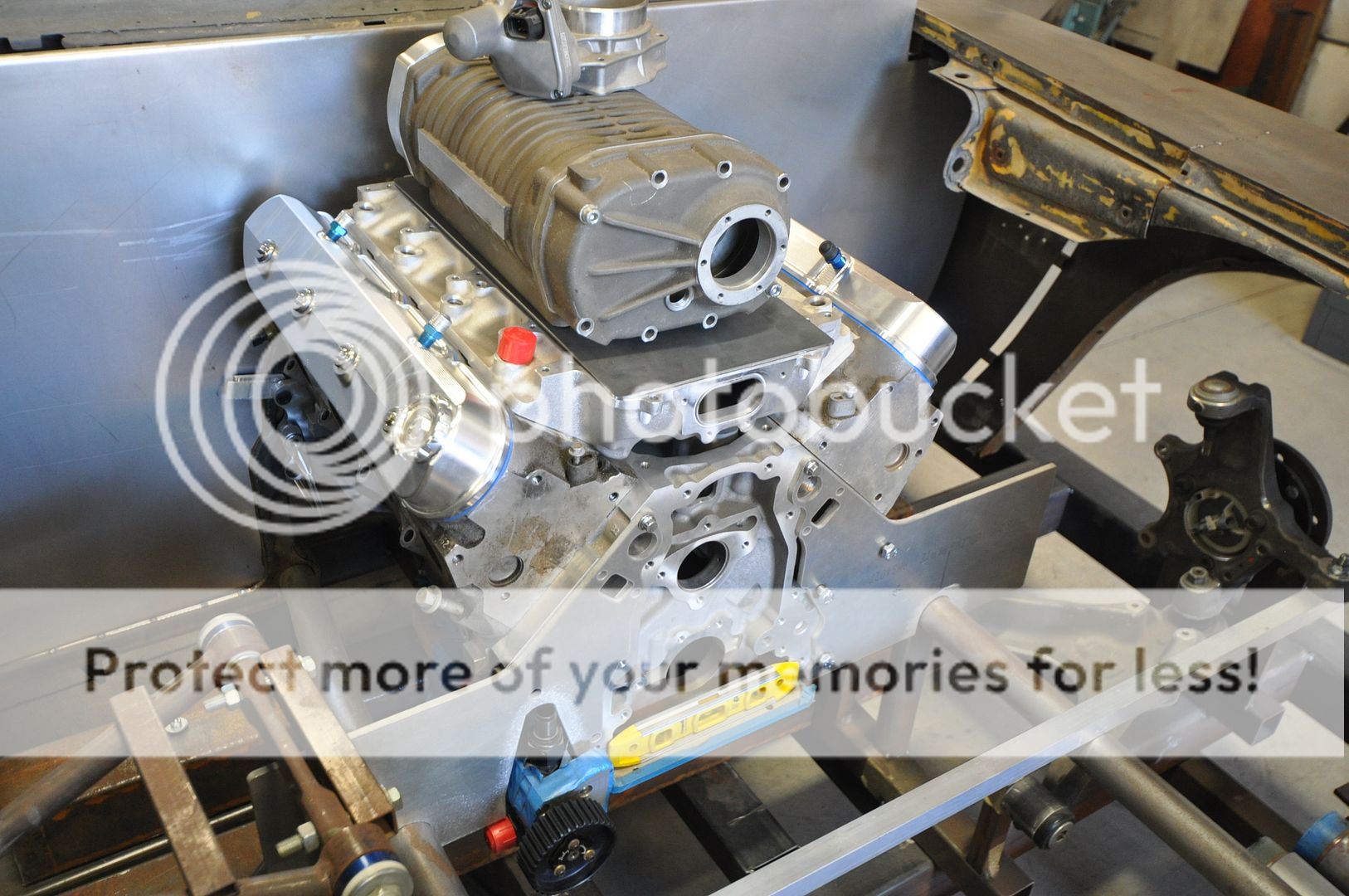

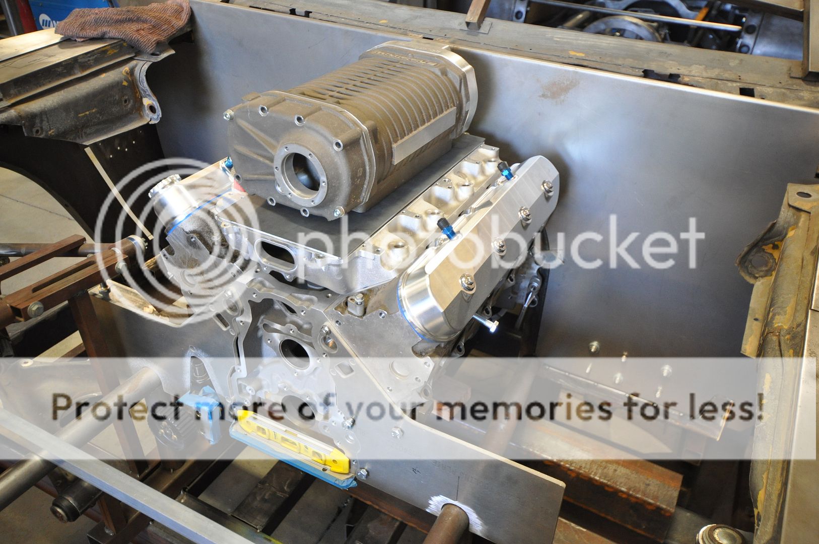

The customer really wants to run a bad ass supercharged engine and he has great contacts with the guys at Whipple. So we have been exploring how to get a 2.9 - 4.0L super charger on this car with out having it look like a prostreet car. We have been playing with different ideas to try and make it really slick. If you notice this blower and manifold combo has a rear entry throttle body with completely hidden injectors in the manifold. This game plan would be awesome with the rear billet aluminum firewall we are laying out to design. Plus this low profile manifold and pulley system from Wegner might keep things under the hood.

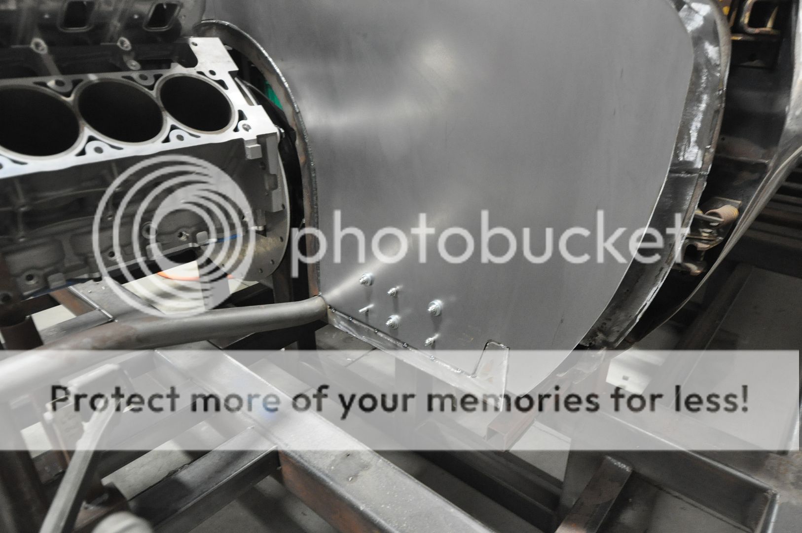

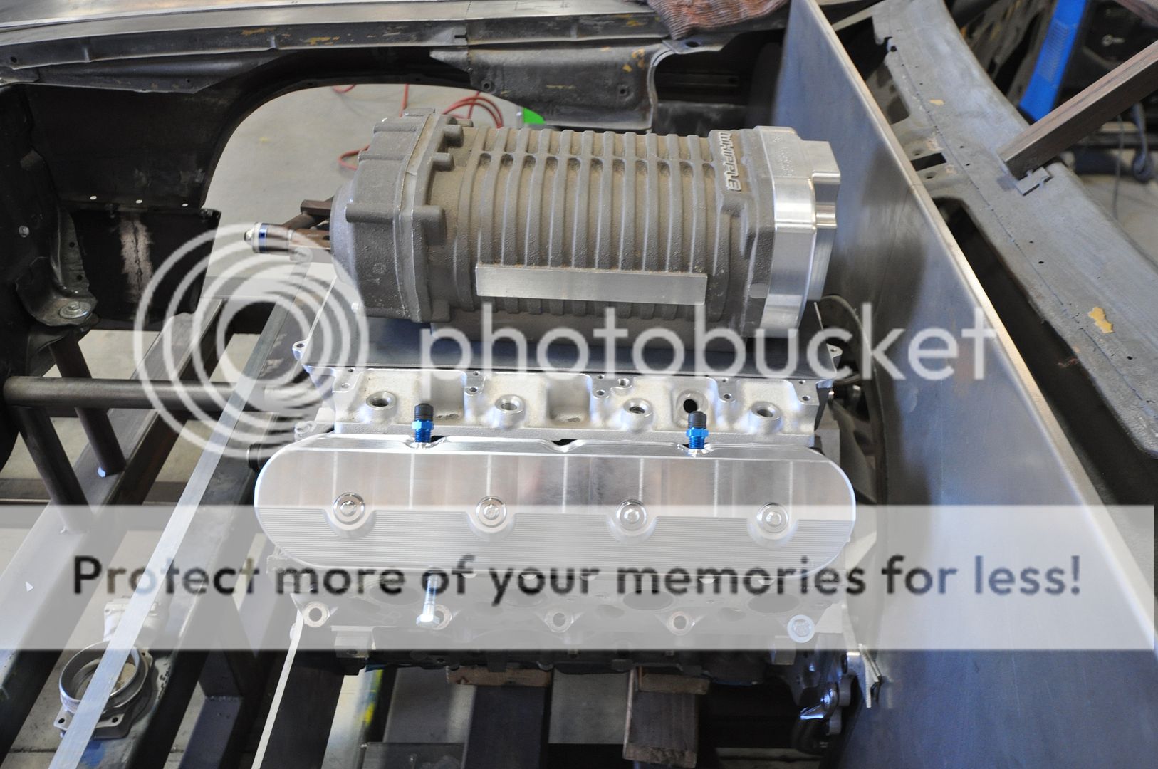

The blower manifold mock up in this picture is a little high still but, like I said we think we can drop the engine 2" still. The sheetmetal is just a mock up to begin designing a billet firewall that will be machine from 5/8 plate and become a lightened structural member of the car.
http://i616.photobucket.com/albums/t...29-2013021.jpg
http://i616.photobucket.com/albums/t...29-2013022.jpg
You can see it still looks a little "Prostreet" with the full intercooler and such.
http://i616.photobucket.com/albums/t...29-2013023.jpg

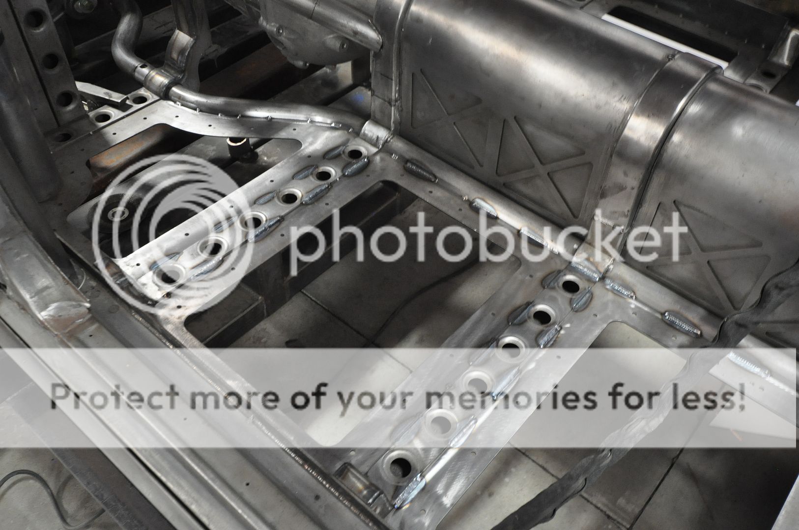

You can see the way the aluminum firewall will set in the car around the designed frame pieces once it is built. It will go in from the front and bolt in from the interior.
http://i616.photobucket.com/albums/t...29-2013024.jpg
In this picture you can see how we have brought the upper tube crossmembers back to the reinforcement plate that goes inside the tailpanel.
http://i616.photobucket.com/albums/t...29-2013004.jpg

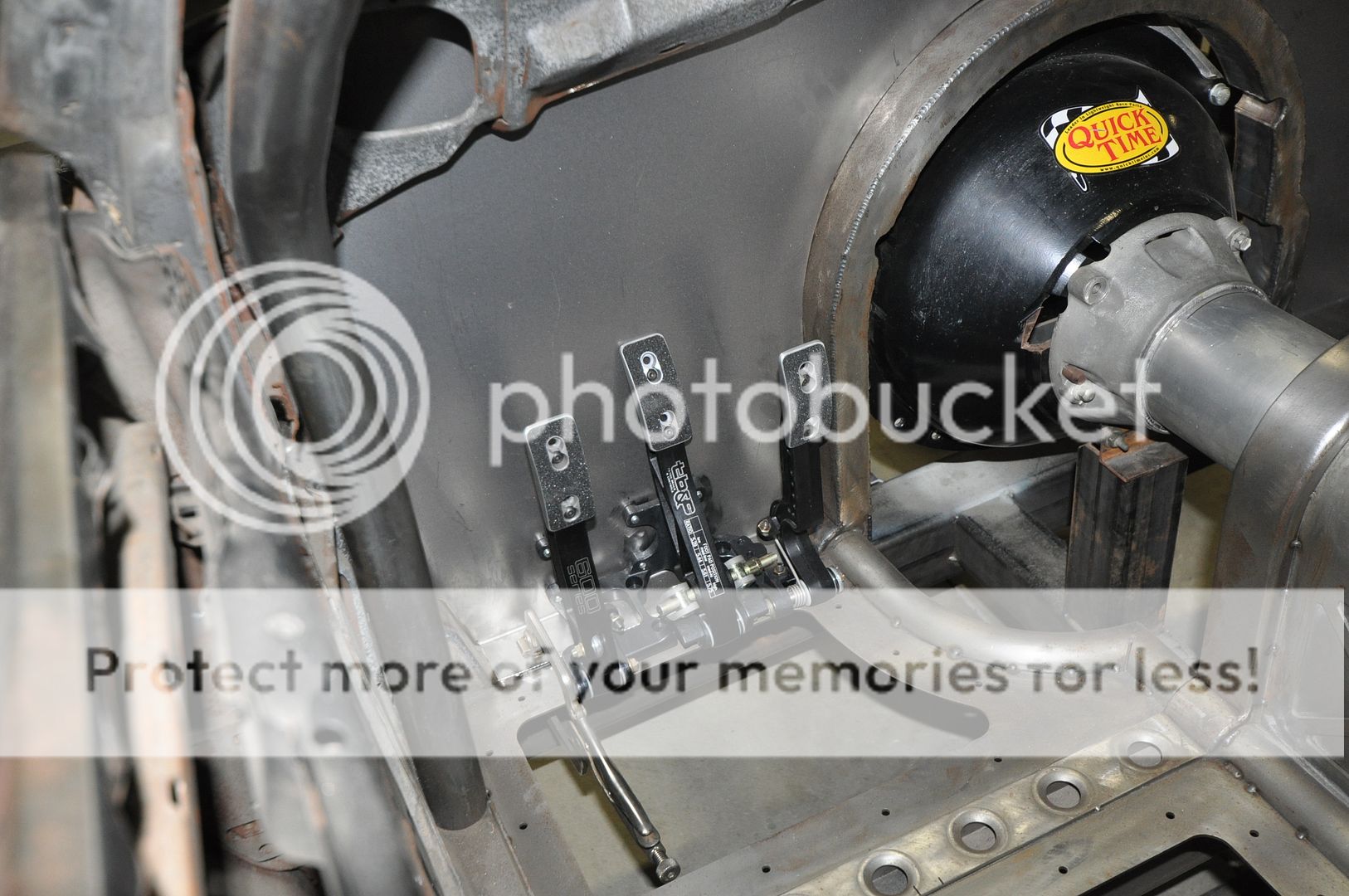

Finally here is the mock up of the pedal system that will allow us to make custom pedals that we can machine and give us a really nice steering column angle. Hanging pedals would be tough in this car as the reservoirs would be really tight to the hood and tough to fill and the hanging pedals would limit the angle of the column and require more angle to send it through the firewall below the master cylinders and inbetween the brake and gas pedal usually.
http://i616.photobucket.com/albums/t...29-2013025.jpg

I know Troy has a line with Whipple and they do make great power, but Maggie has a couple of new models that fit under the hood.
http://www.magnacharger.com/p-113-co...arger-kit.aspx
Not sure if you're running a 6.2 or 7.0 and I'm sure you know their line up, but I thought I'd throw it out there.

I've never heard of anyone that was happy with a mini-clutch on anything street driven. Something for the owner to think about if this is going to be a driven car. I've seen a lot of people start down that road thinking "I will live with it" and invariably about 6 months later I see them going back to a 10.5" clutch or turning it into a track car. It might work with some of the newer CF bad assery out there, after all some of the exotics get away with it but I'd definitely do some testing on a mule somewhere.
I may be out on a limb here but with all the slick pro-tour cars we've seen I almost wonder if a hint of pro-street bad assery might not work, although, given the direction of this particular car, probably not. Would look cool on something though.

Carbon triple discs work fine with big power on the street. The owner used to race sprint cars, So anything is better then a push start direct drive race car.
The customer wants the blower under the hood. And he is willing to do all way can to achieve that.

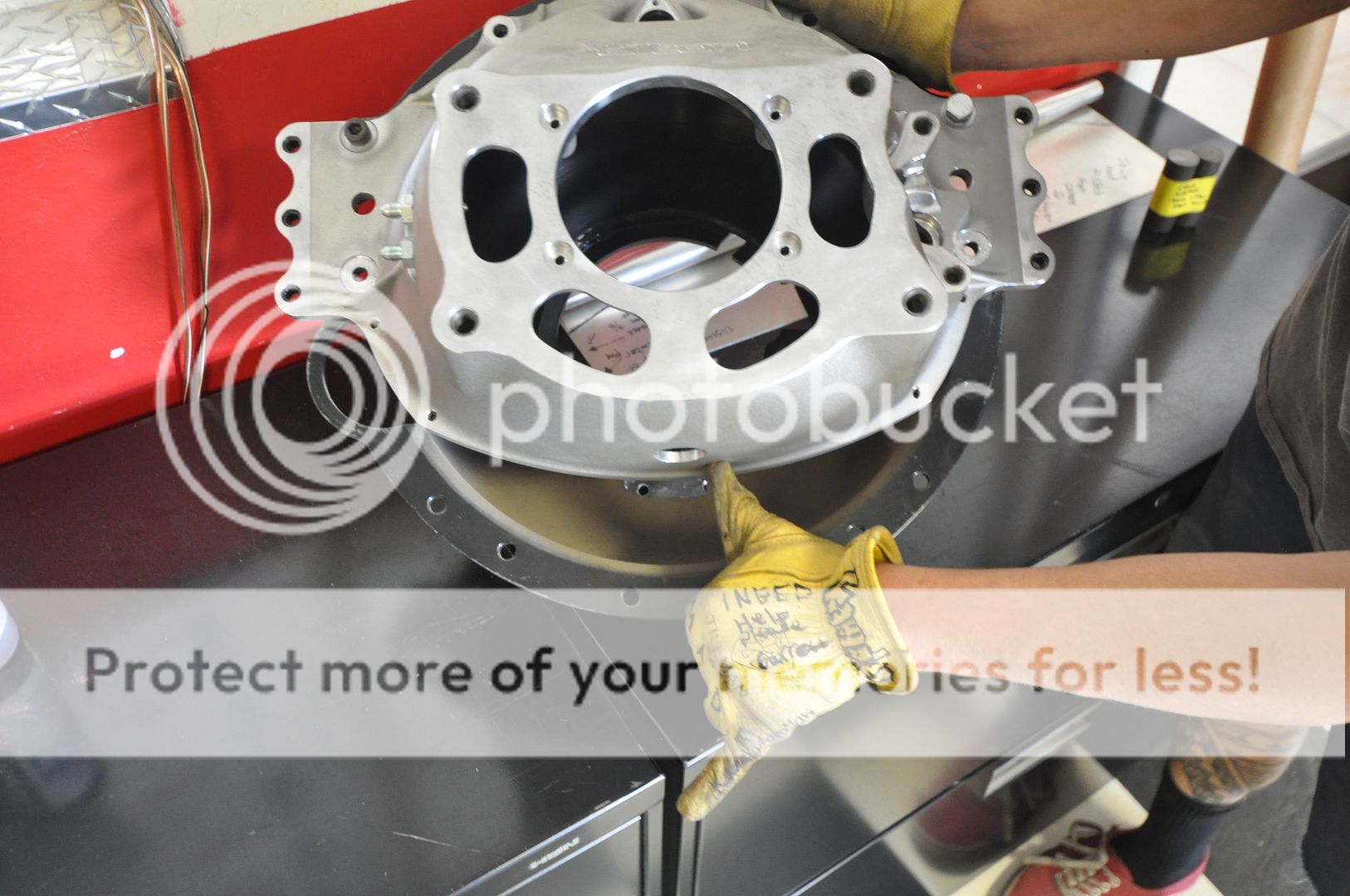

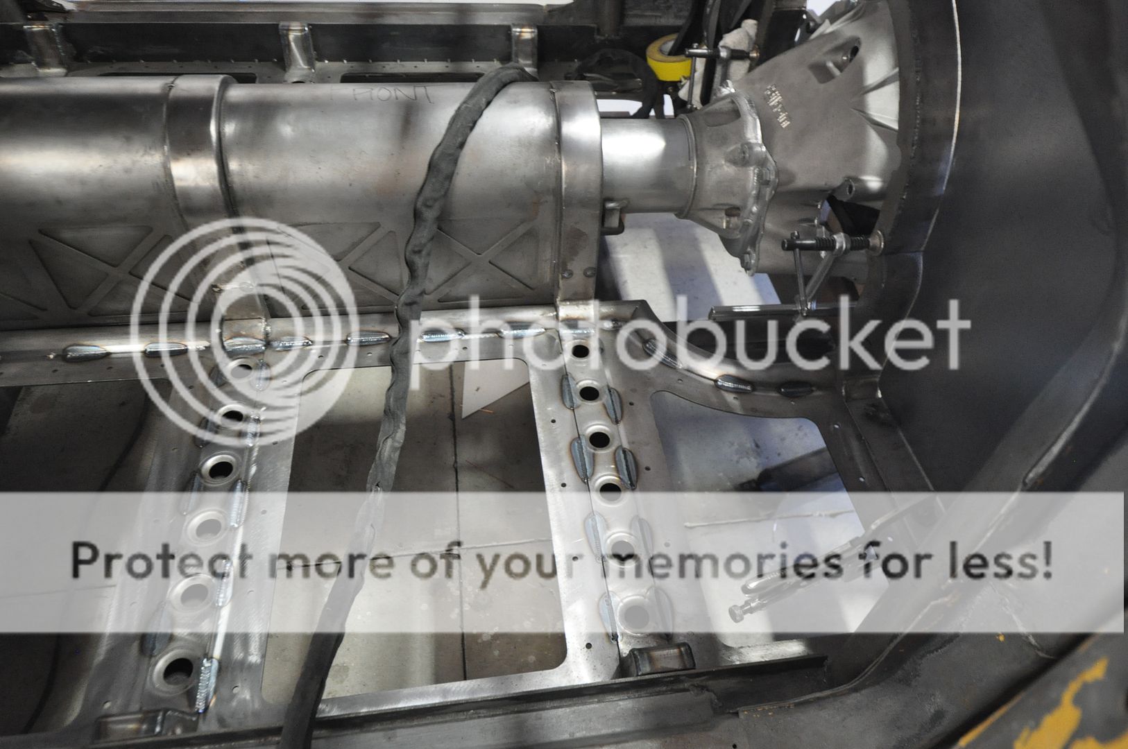

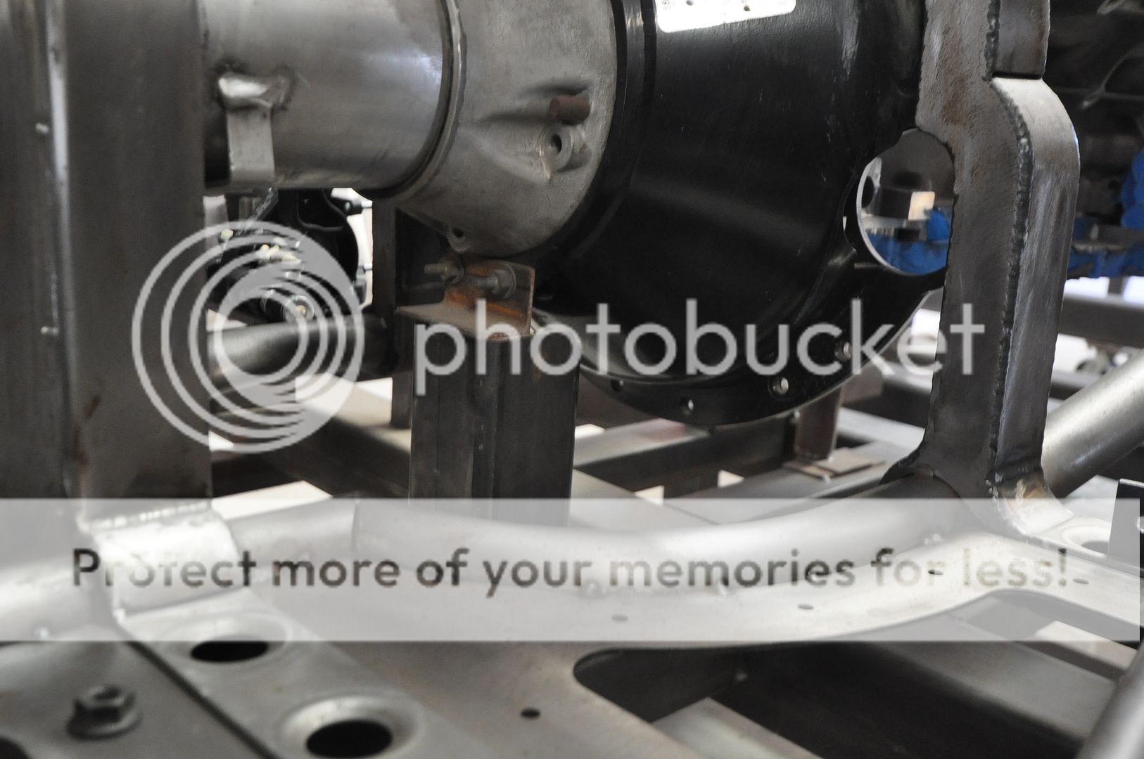

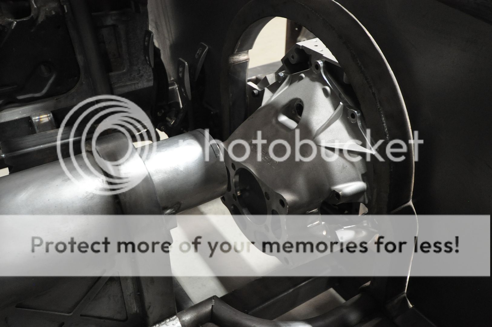

ironworks 05-14-2013 04:49 PM
Kamaka says we should gain about a half a SHAKA with this new bellhousing.
http://i616.photobucket.com/albums/t...14-2013022.jpg
:mock: :mock: :mock:
Rick D 05-14-2013 05:46 PM
WOW that's very nice :king: Rodger who makes that bell housing? Or is it a Iron Works skunk works item :hello:
andrewb70 05-14-2013 07:20 PM
Looks like a Tilton bellhousing.
Andrew

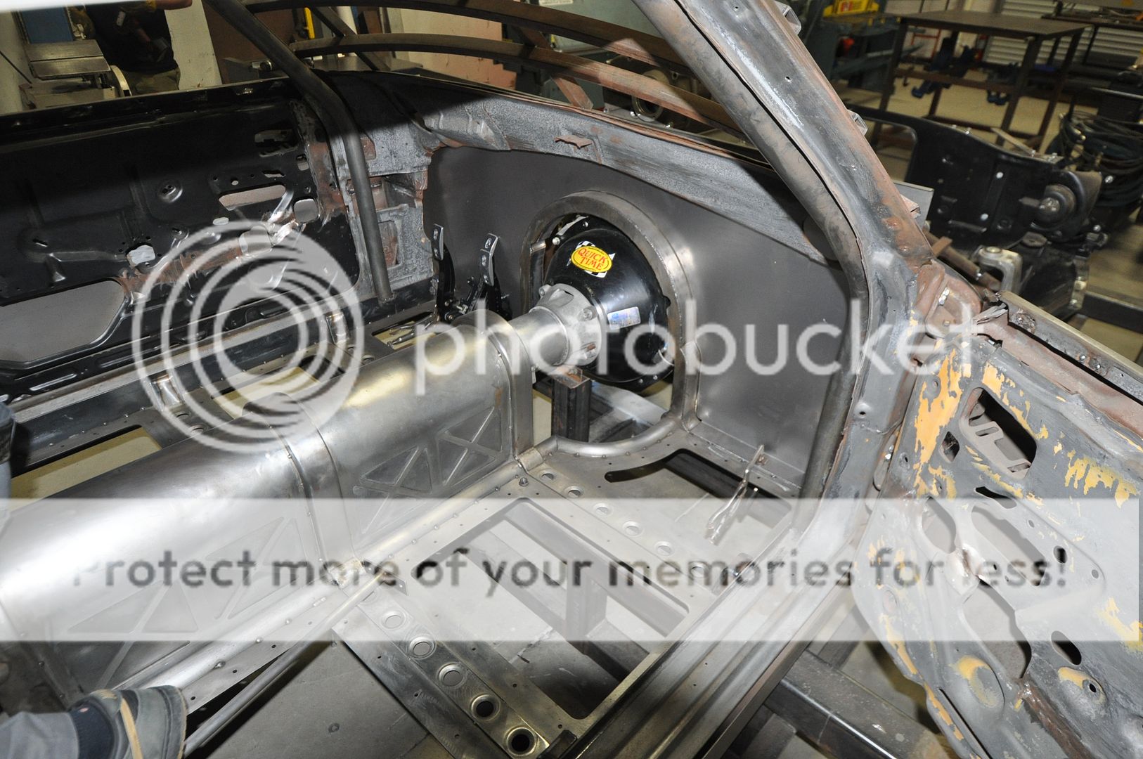

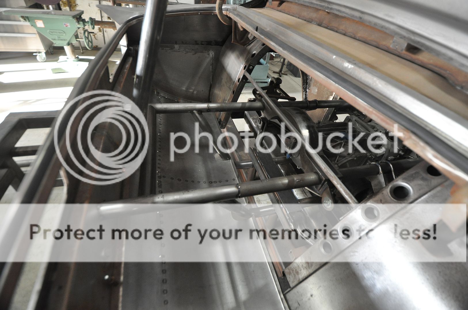

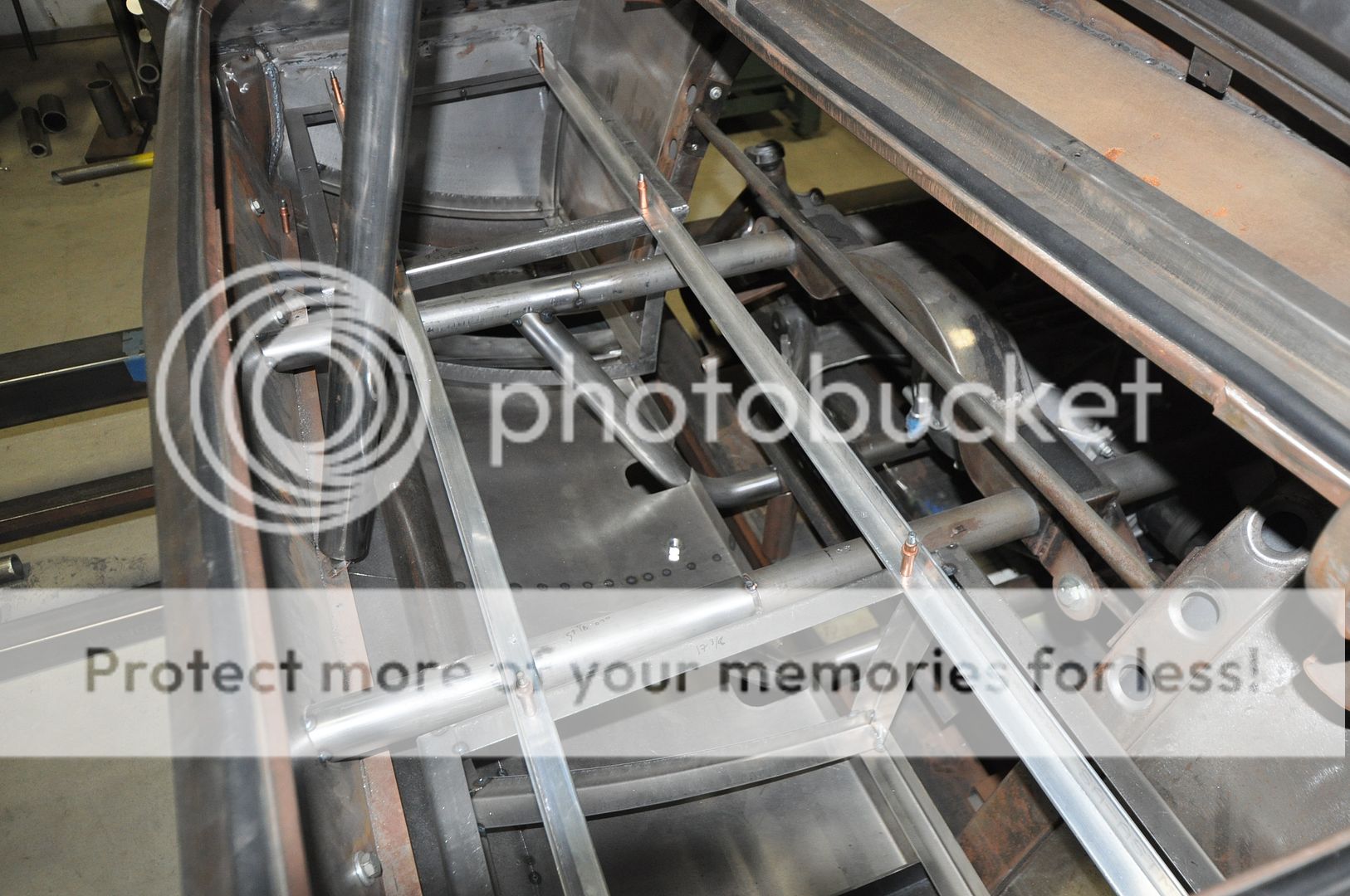

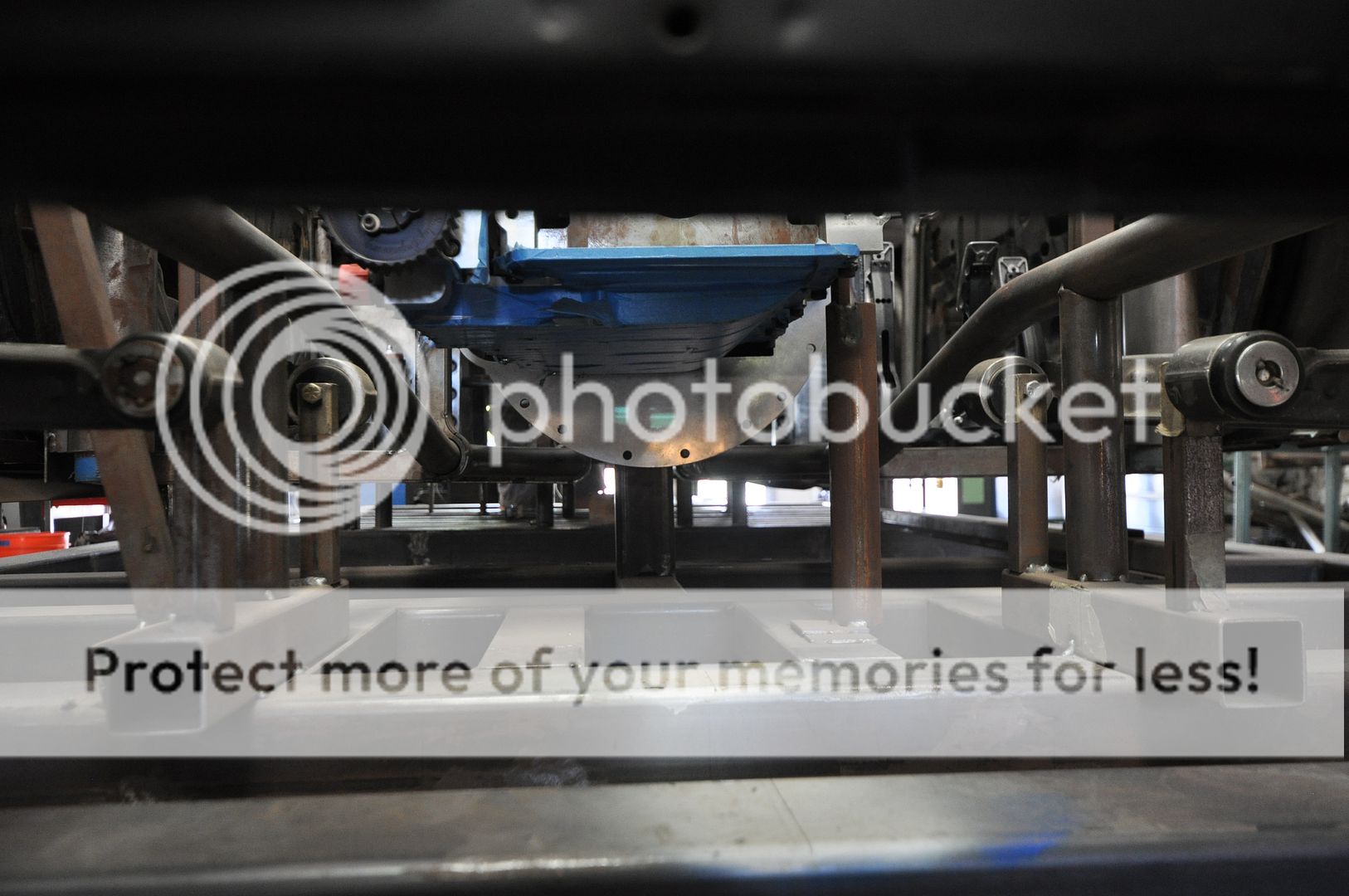

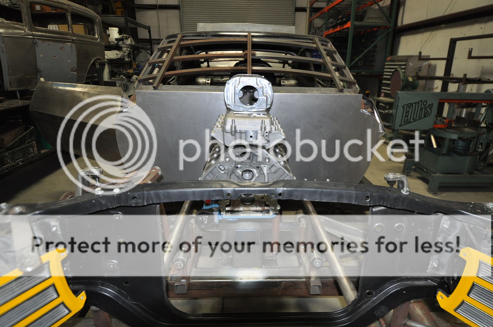

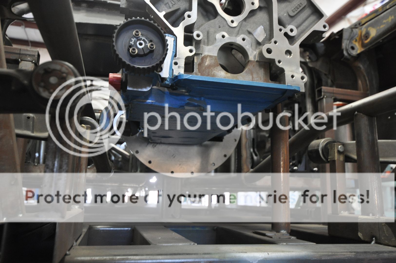

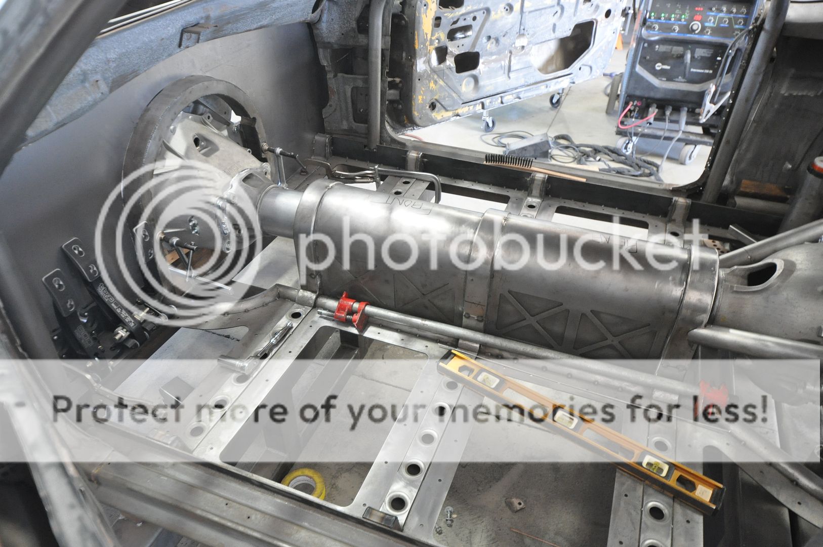

ironworks 06-02-2013 05:01 PM
So we got the Tilton bellhousing mocked up. We are going to machine a custom end for the torque tube to make attaching the torque tube to a standard bellhousing a solution. We are setting up the engine plate for the car. I THINK....... We have the engine front drive system figured out. Not quite sure I can put it into words, but I know what I'm supposed to do to make it clean like the customer wants. Now we just have to make it a reality, should be pretty awesome when complete.
We have continued some work on the the middle of the car. We are waiting on the ZR1 hubs for the car to begin to mock up wheels. We lowered the torque tube tunnel to go with the lowered engine position that we achiveved with the smaller bellhousing. We are still working with Whipple to get the blower manifold and drive system finalized to move to the front of the car.
Enough Blah Blah Blah. Here are some pics.
http://i616.photobucket.com/albums/t...-2013002-1.jpg
http://i616.photobucket.com/albums/t...21-2013015.jpg
http://i616.photobucket.com/albums/t...31-2013003.jpg
http://i616.photobucket.com/albums/t...31-2013004.jpg
http://i616.photobucket.com/albums/t...31-2013005.jpg
http://i616.photobucket.com/albums/t...31-2013006.jpg
We also began welding out the floor sections. Time to design floor insert panels.
http://i616.photobucket.com/albums/t...31-2013009.jpg
http://i616.photobucket.com/albums/t...31-2013010.jpg
