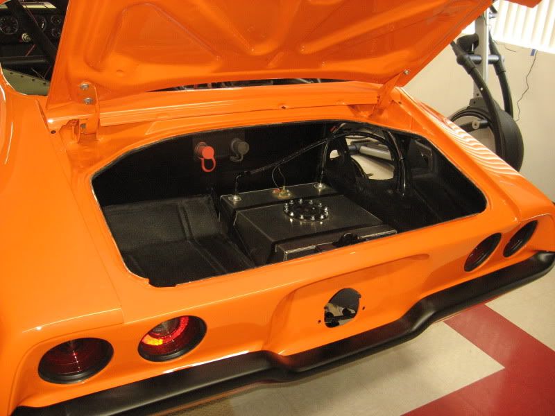

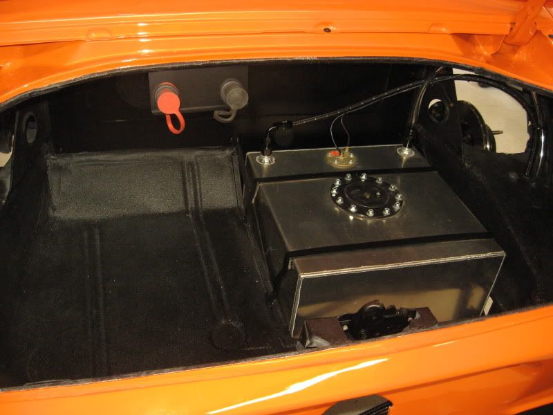

Here are a few photos of some of the progress made this past week.
The fuel cell and line to the motor are done.

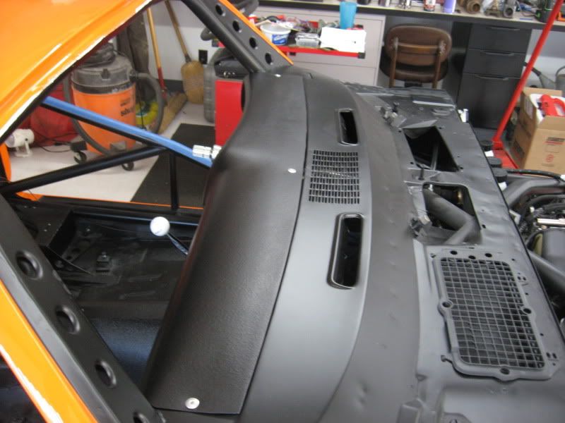

The wiper motor was relocated to the far end of the firewall. Custom linkage was made to hook up to the original wipers. The brake and clutch reservoirs were also installed on the firewall.
http://i80.photobucket.com/albums/j1...b/IMG_3706.jpg

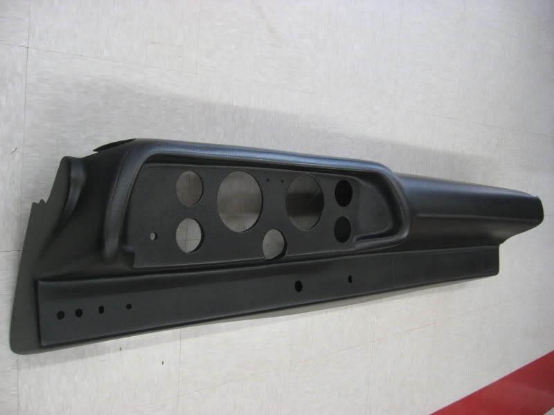

The holes for the gauges were cut. Next are the switches in the next couple days. After that, the dash will get textured and painted.

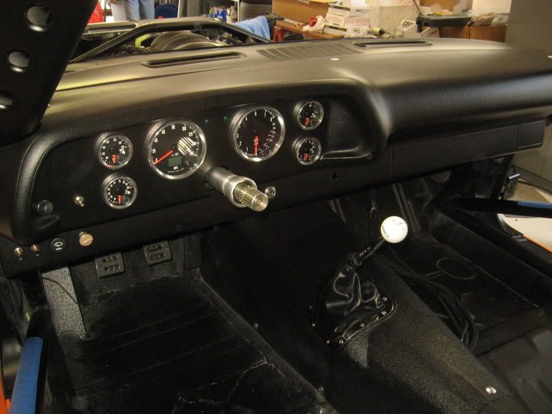

The dash was textured, painted, and installed this weekend. I am very happy with the results. I tried to duplicate the factory look with the fiberglass dash and gauges.
http://i80.photobucket.com/albums/j1...b/IMG_3722.jpg
http://i80.photobucket.com/albums/j1...b/IMG_3729.jpg
http://i80.photobucket.com/albums/j1...b/IMG_3725.jpg

On the dash, I used a 3M light gravel guard and sanded it down. After that, SEM trim black. The trunk floor and interior floor has bed liner. I wanted a durable floor that cleans easily. I don't have cup holders, so I may spill.
The gauges are Speed Hut.

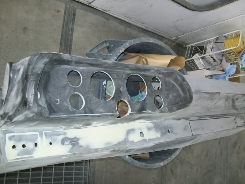

It is a VFN dash that Maier Racing customized for me. The instrument cluster was moved back to clear the roll cage. Maier Racing does a lot of custom fiberglass work, so it was easy for them.
I am using 4" large gauges and 2 1/8" small gauges.
