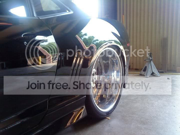

Just a thought for you. Im running the 295/35-18 and 265/35-18 and wish I would have gone with a 275 on the front. The 265 looks a little rubber-bandish from some angles. The sidewall height isnt what I am used to seeing.
https://lh6.googleusercontent.com/-I...-00-57_608.jpg
syborg tt 09-24-2012 08:42 AM
Hi Chris,
I may end up swapping to the 275 up front like you've done. I really like that tire combo. Plus the 26" tall profile might help me not bottom out so much
ps - your car looks awesome and I love the front spoiler and we need more pics of it !!!!!!

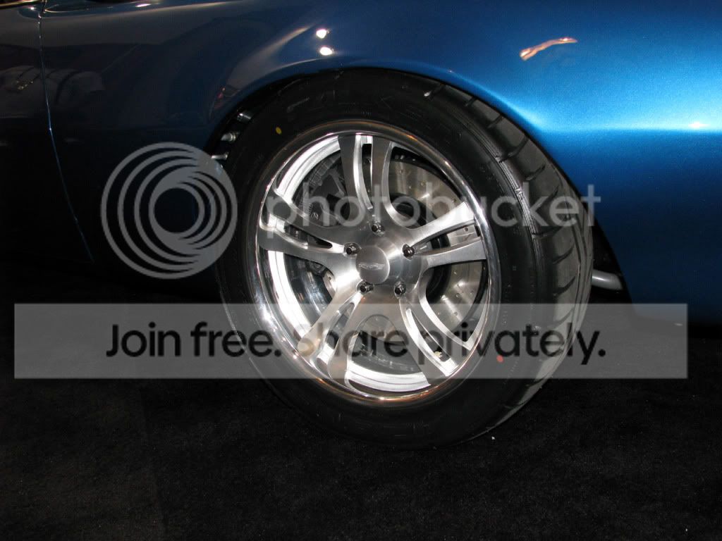

http://i691.photobucket.com/albums/v..._897834534.jpg
And I like the taller sidewall, but I guess I'm a little more old school than some... 255/45/18s front and 295/40/18s rear.
http://i691.photobucket.com/albums/v...-05Sema821.jpg

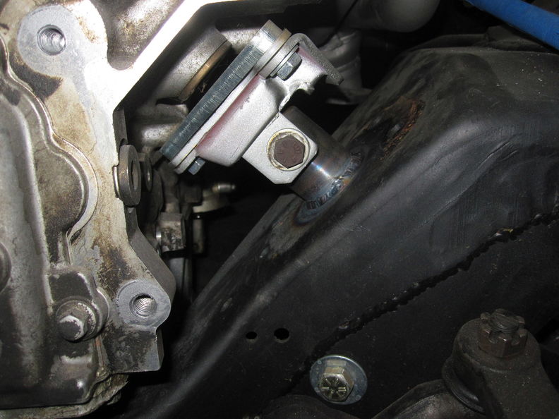

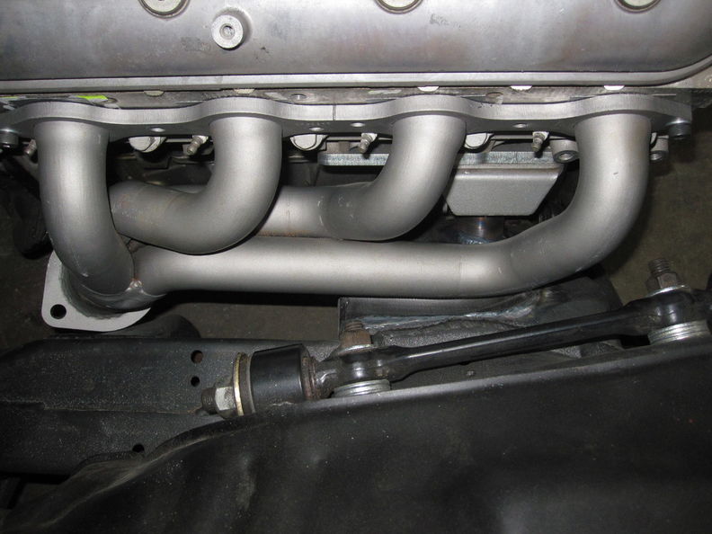

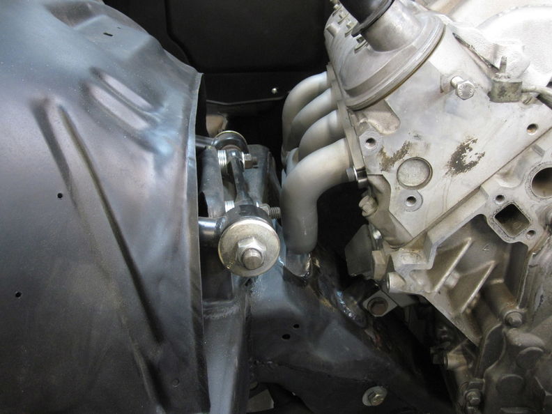

To keep things simple I wanted off the shelf headers so I ordered up a set of Edlebrock shorty headers for a 2010 Camaro. Very nice
piece I may order a set for my 2010 Bumble Bee.
http://garagescene.net/_data/i/uploa...d218ee2-me.jpg

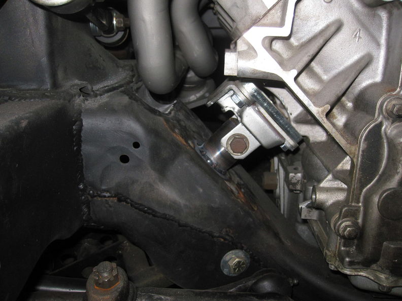

We needed to add a little extra clearance so the guys at High Speed Welding notched the frame to clear one of the tubes on the passenger
side.The good news is the drivers side fit perfectly.
http://garagescene.net/_data/i/uploa...47d2e5d-me.jpg
A close up of the motor mount stands welded to the stock subframe. I also used the Edelbrock set back plates so I could use the stock style
motor mounts.
http://garagescene.net/_data/i/uploa...dd4dc1b-me.jpg

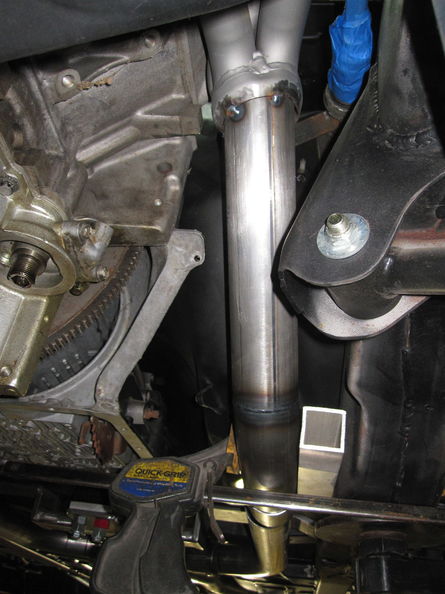

Looking down you see that the collector hits the subframe so a little more work is needed on the passenger side to make the header
work.
http://garagescene.net/_data/i/uploa...eb58d58-me.jpg
One of the reason for the shorty headers is ground clearance. Since the car will be sitting 6" off the ground the exhaust needs to tuck
up tight to the floor. There is only 4" of space between the floor and the bottom of the subframe thus there is no true way to hide
the exhaust unless you run a down-pipe style exhaust.
http://garagescene.net/_data/i/uploa...4c1c4f4-me.jpg

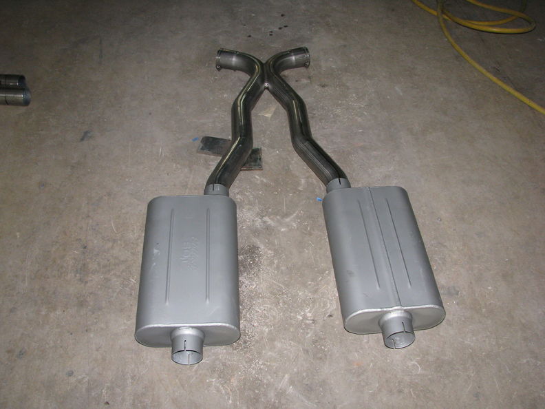

2nd Chance Camaro - High Speed Welding Edelbrock Exhaust Mod Post 1
2012 10-22 Update - High Speed Welding Edelbrock Exhaust Mod Post 1
www.2ndchancecamaro.com
Afternoon All,
The guys at High Speed Welding are finishing up the exhaust and it should be done by the end of the week.
http://garagescene.net/_data/i/uploa...29f7523-me.jpg
The goal is to tuck the exhaust up tight to the stock floor pan.
http://garagescene.net/_data/i/uploa...97ea122-me.jpg
Close up of the new downpipes on the shorty headers
http://garagescene.net/_data/i/uploa...c46ea29-me.jpg
You can see that nothing is hanging below the Stock Sub-Frame as the car will be 5 1/2" off the ground.

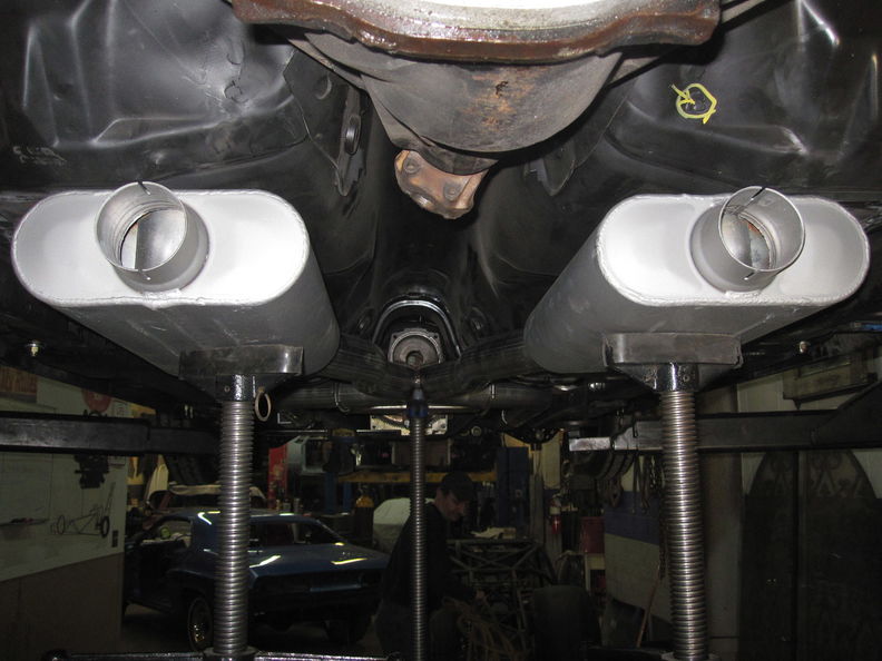

http://garagescene.net/_data/i/uploa...ee5ac64-me.jpg
In order to tuck the muffler tight to the floor they had to raise a section of the stock floor pan.
http://garagescene.net/_data/i/uploa...befc6e0-me.jpg
http://garagescene.net/_data/i/uploa...bad4128-me.jpg
It was very important to keep the factory rear seat for my girls to ride in.
