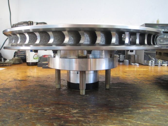

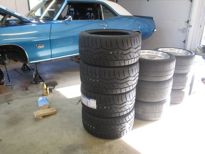

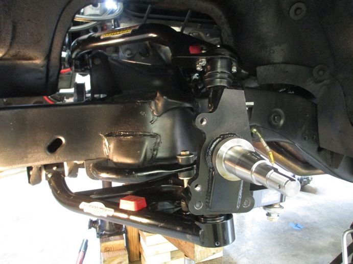

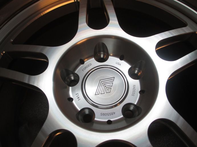

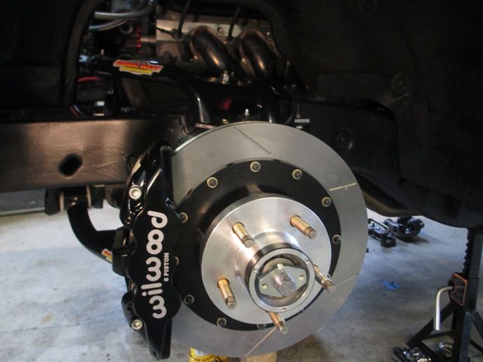

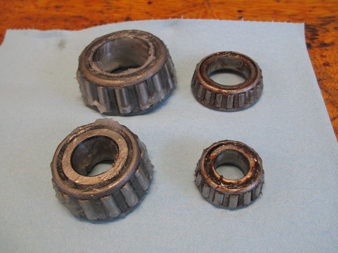

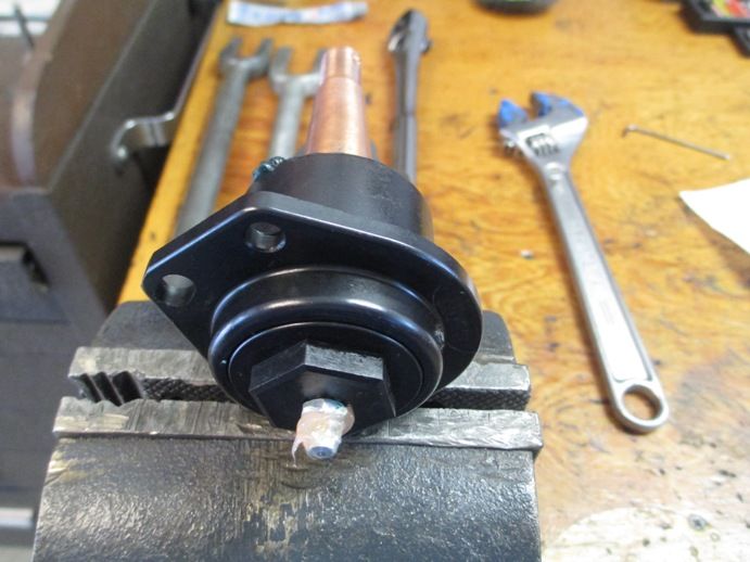

Over the past several months I have been working towards getting the car back together. Two weeks ago I finished all the updates... one week ago I took the car out to PIR to test the new set up with the new parts from Ron Sutton Racing (new spindles with optimized geometry, new hubs with heavy duty bearings, spec 37 rotors, six piston calipers, custom caliper mounts; adjustable steering arms; custom bump steer spacers; and custom height ball joints).

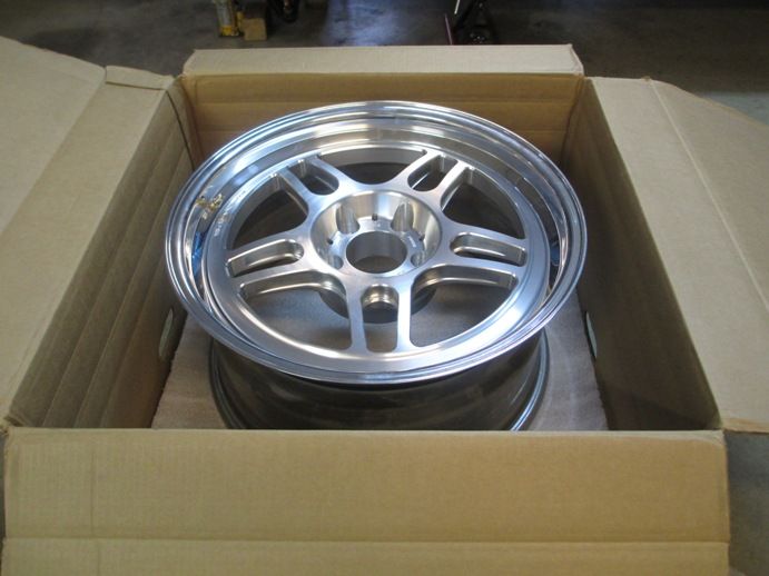

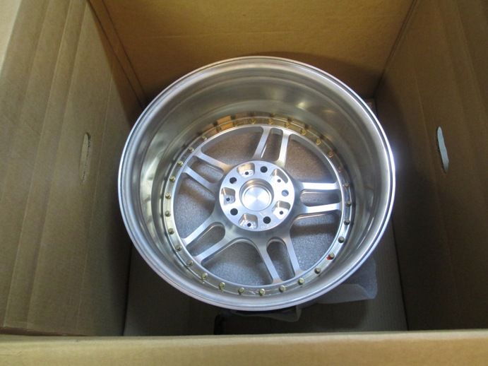

In addition I bought a new set of Formula 43 18" forged 3 piece wheels and Falken 615K 200 treadwear tires... and for added driver safety I purchased a G-Force Nomex fireproof driving suit, and a Hans Sport II head restraint.
Here is a few pics of the new parts.
http://i1048.photobucket.com/albums/...ps5b2ac5f1.jpg
http://i1048.photobucket.com/albums/...ps8d2701ff.jpg
http://i1048.photobucket.com/albums/...psa21c44d9.jpg
New track star spindle bearings on the left... stock bearings on the right

I documented the process of doing all the updates to the front end... including relocating the pivot points on the frame, dialing in the bump steer, and some other stuff I learned along the way. Also I will share new design I did for adjusting the coil spring pre-load (ride height) in less than one minute.
I have been fine tuning the handling on my car for several years now and thought it was pretty good. With the new optimized front end geometry, roll center, and the new parts... the grip in the corners is night and day difference! I couldn't be happier... well worth all the work and expense.

Fantastic updates. Those new bearings are massive compared to the stockers. Your attention to detail and well thought out upgrades are top notch. Not sure if I missed it somewhere but anything new on the rear?
fleet 08-21-2014 12:53 AM
X2!
Hope all is well with your son, Dale. :thumbsup:
rickpaw 08-21-2014 03:37 AM
Thanks for the update Dale. The new wheels will look great on the car.

SSLance 08-21-2014 07:28 AM
More updates coming.
(Thanks Ron)
:cheers:
So it handles much better even with the less sticky tires huh? Sounds familiar... :whistling:
That spindle pin is MASSIVE!!
Can't wait to see the pics and details of the pivot point relocating...along with everything else.
tubbed69 08-21-2014 07:54 AM
X2 nice wheels
Vince@Meanstreets 08-21-2014 10:14 AM
looking good dale.
what did you end up with as far as alignment specs? curious to see your static camber number.
DaleTx 08-21-2014 10:05 PM
Thanks! The new bearings provide a nice factor of safety whereas the stock bearings were pushed to the limit of the load rating when tracking the car.
No changes on the rear yet... I'm planning to go with a 3 link set up for a future project.
Thanks Lance... I was impressed with the Falken tires.
The new spindles will have very little deflection compared to the stock spindles.
Originally Posted by tubbed69 (Post 566728)
X2 nice wheels
Thanks!
Originally Posted by Vince@MSperfab (Post 566736)
looking good dale.
Thanks Vince... The static camber was set at negative 1 degree, and the toe was set at 1/8" toe out (total) at ride height. With the new geometry and increased camber gain the set up worked out great. On the previous set up I had the camber set at negative 2 degrees.
The bump steer was set to increase toe out to 1/4" (total) when the suspension is compressed to the lower bump stop, and 0 when the suspension is extended to the upper bump stop.
Ron walked me through the process for setting the bump steer using a laser beam on a target 5 feet out in front of the car. Once I got it dialed in then he made the correct size spacers to connect the tie rod to the steering arm. I'll post more details on that later.
