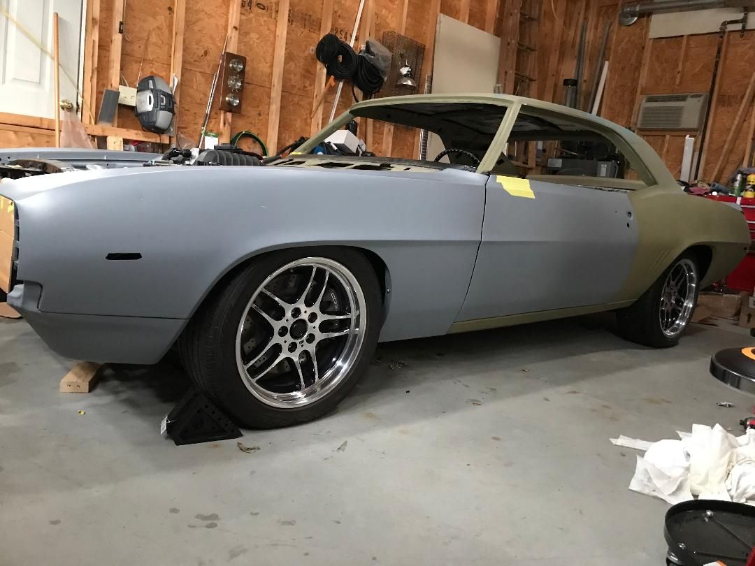

OK so it's been tough getting to work on the car for quit a while ( Need new hip). So I caved and looked for someone to get under the dash and take care of the wiring for me. As expected it's a long waiting list to get in. Then I talked to a guy and he had just finished a job and could take it as soon as I could get it there. BUT lots to still get done, steering column, finish brakes, fuel line and other small stuff. My son in law came home from work and came right over ( my daughter got lucky with this guy! ) stayed till 11-12 and got up to go to work. So we were set to send the car today at 8 AM , but of course Rodney snuck up and bit me in the BUTT! Last nights snow storm stopped that in it's tracks. There are no windows in or hood on it. I just couldn't see it going with all that salt, so it's now a Monday 8 AM pick up. The Rodney part is no snow for two months and it happens when I need it not to snow.
OK enough crying.

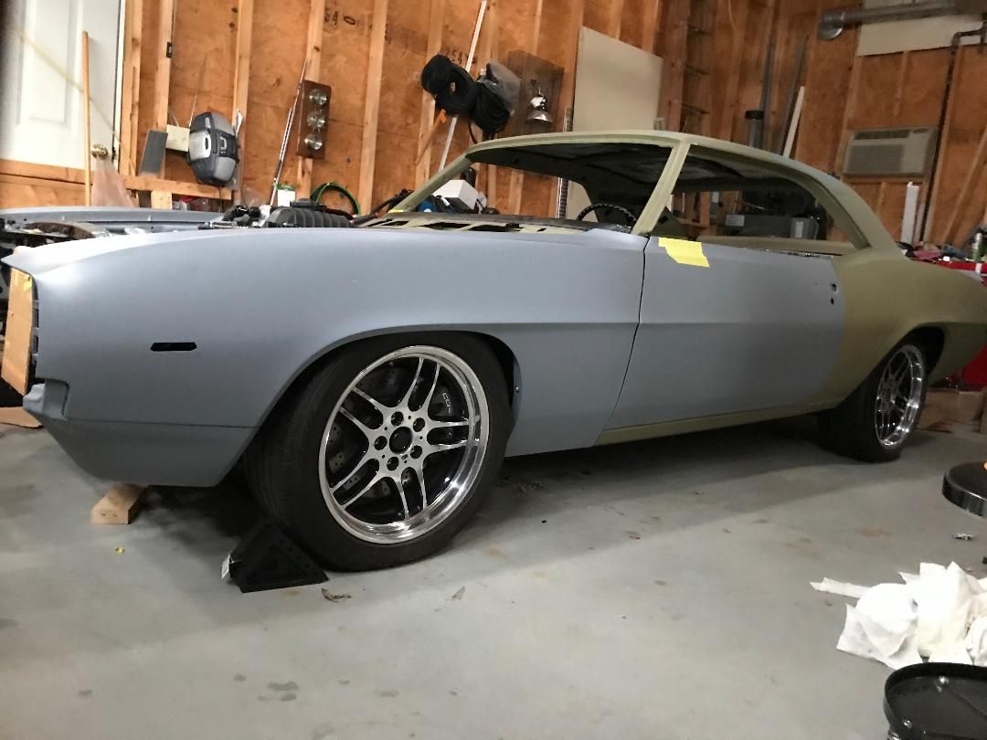

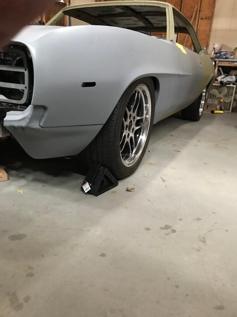

Here are the first pictures of the car on it's Temporary wheels in at least 4 years and with the drive train in it.
https://i172.photobucket.com/albums/...psi7dfx8o3.jpg
https://i172.photobucket.com/albums/...pssmfdvauc.jpg
https://i172.photobucket.com/albums/...psn0nbbiig.jpg

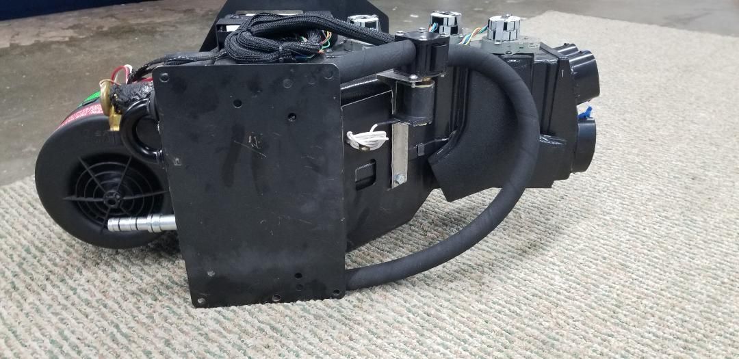

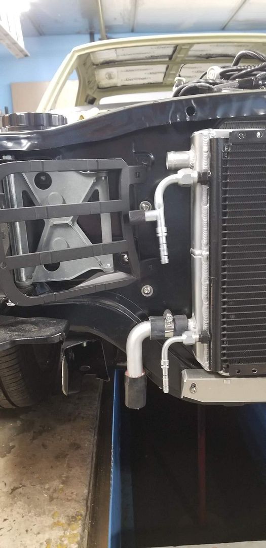

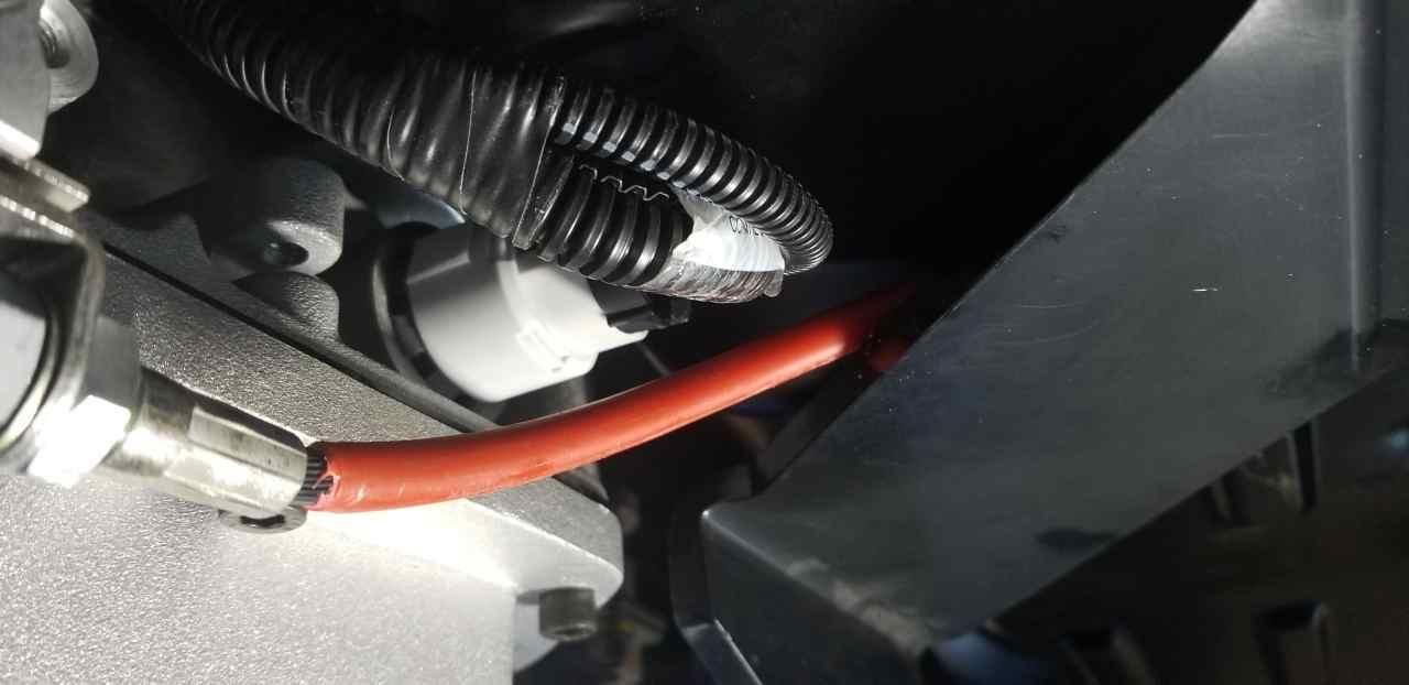

I've got a small update on the car. The car is out getting wiring and the A/C installed. The wiring for the tail light section ha been neatened up, No picture of that. The A/C has been mocked up and some of the hoses for the heat have been changed to the -10 AN and run to the heat control valve. I needed a lot on different A/C fittings because of all the changes with inter cooler and pumps. But it's just wait for the fittings to be delivered.
https://i172.photobucket.com/albums/...psnug1h08t.jpg

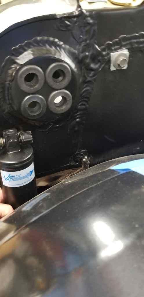

Here's the challenges you run into when you run out of room. That RS headlight door has stung me a few time./
https://i172.photobucket.com/albums/...psovuif3pc.jpg
Here's where the dryer is going.
https://i172.photobucket.com/albums/...pseskzosrt.jpg

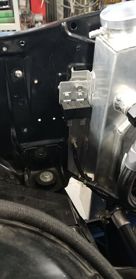

Here are the relays for the cooling fans
https://i172.photobucket.com/albums/...psy3zmg8vp.jpg

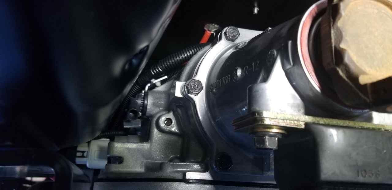

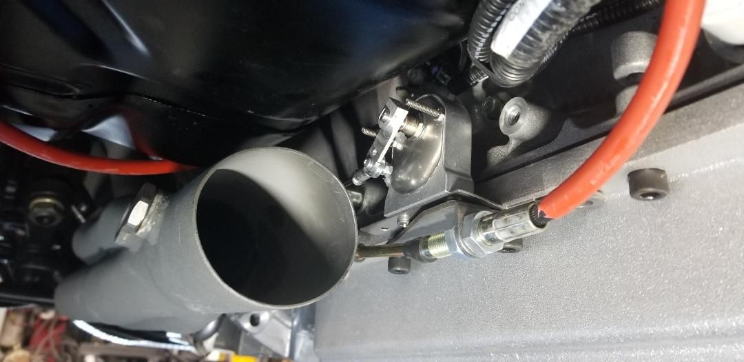

The trans was tight for connecting the controller wiring, the connector was too close to the floor. Brian dropped the spacer I had to get my drive train angle and took about 1/2" off the spacer and now the plug fits by 1/4". He tigged it back together and painted it up, and now were done with that.
trans wiring plug
https://i172.photobucket.com/albums/...ps8nh50zji.jpg
https://i172.photobucket.com/albums/...pslchtqf4c.jpg
