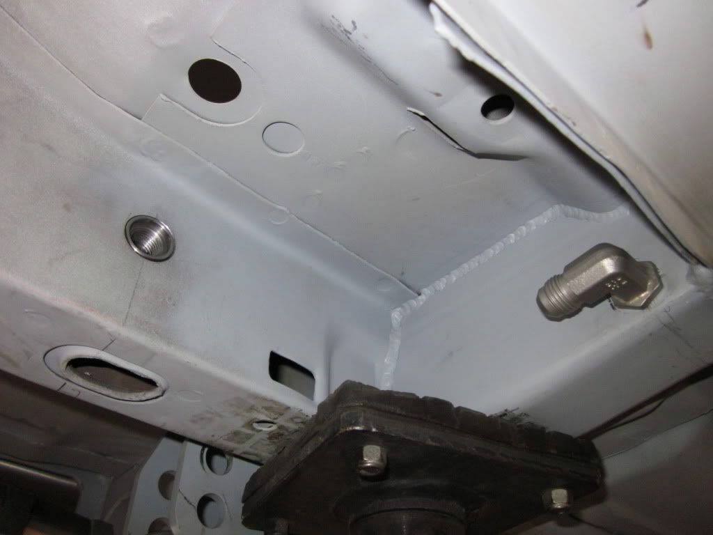

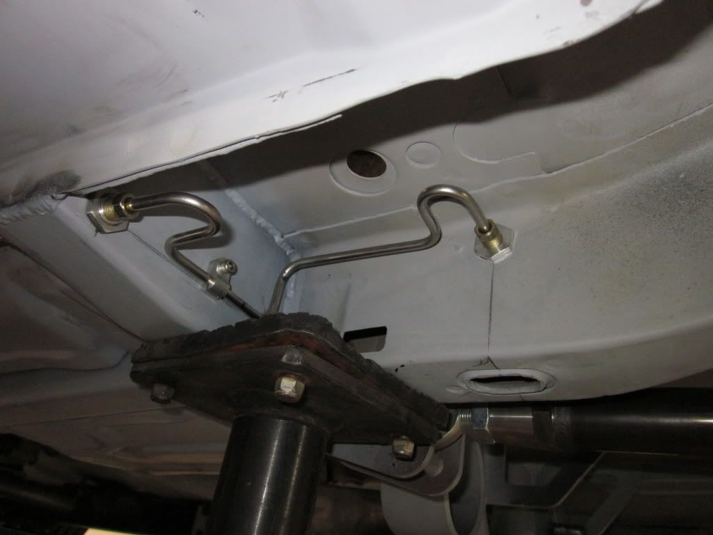

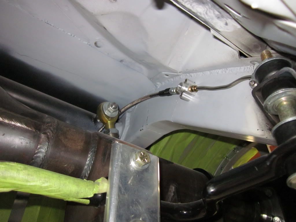

More plumbing pics!
Got some more pics on the plumbing! have been machining more custom fittings & tools for this Bird!!
http://i1015.photobucket.com/albums/...n/IMG_0302.jpg
http://i1015.photobucket.com/albums/...n/IMG_0301.jpg
http://i1015.photobucket.com/albums/...n/IMG_0299.jpg

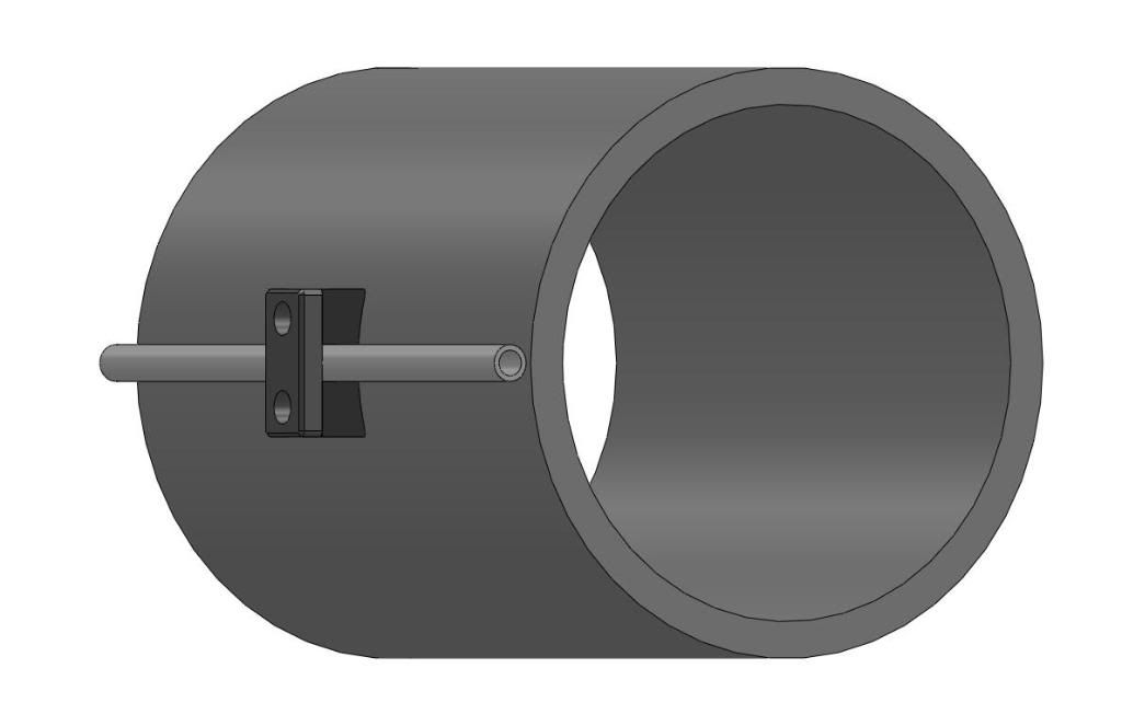

This what we will machine this week.. Axle brake line retainers.. Steel base will be spot welded on axle tube & billet clamp will bolt on to retain it..
http://i1015.photobucket.com/albums/...eldClamp-1.jpg

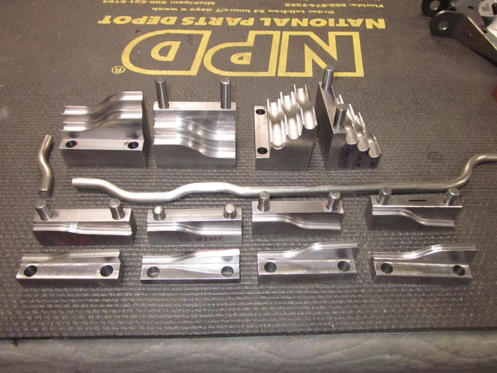

Tools!!! Here we have some benders in different radius that can make some nice transitions..
http://i1015.photobucket.com/albums/...n/IMG_0307.jpg
