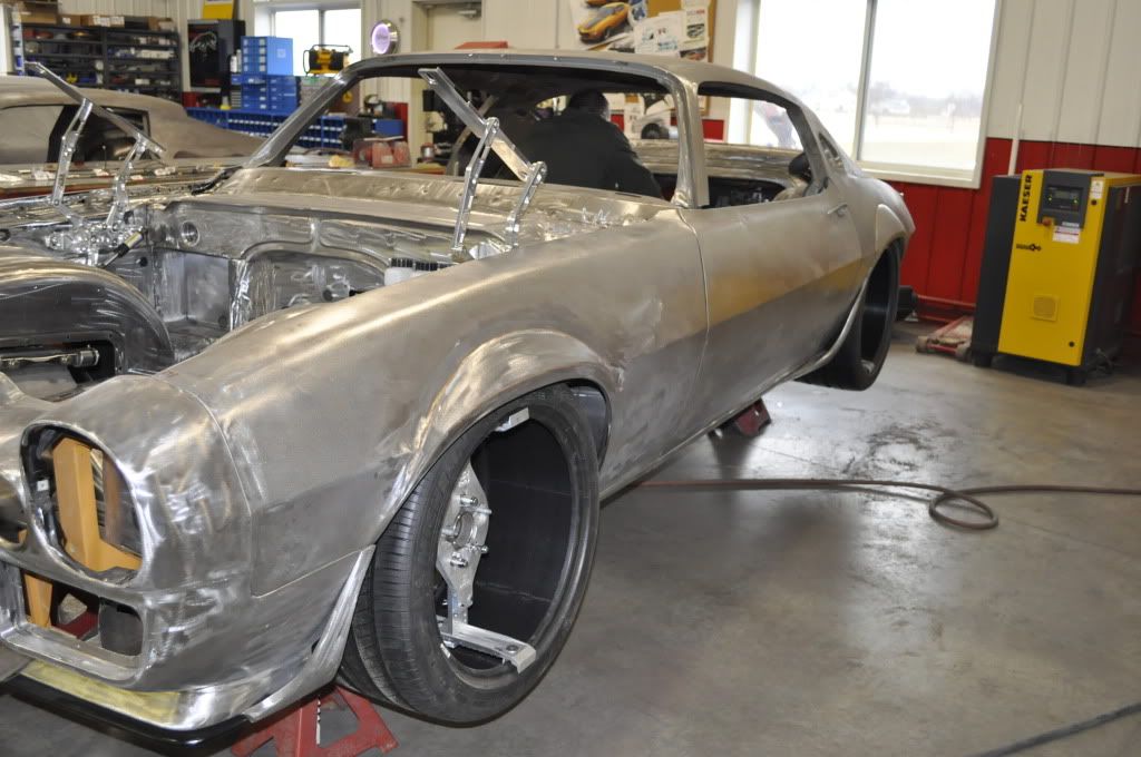

This car is going to be beautiful. I just have one silly question. What is that tool inside the tire?
camcojb 03-25-2011 09:09 AM
wheel backspace tool. You can set it for the width wheel you're going to run, mount a tire on it and install it on the car. The backspacing is adjustable so you can adjust it to get the clearance needed for turning, ride height, etc. Takes all the guesswork out of ordering wheels, you get to test any number of widths and backspaces to make sure they'll clear under all conditions.
Mark S. 03-25-2011 11:31 AM
Thanks Jody. Any idea who makes them?
