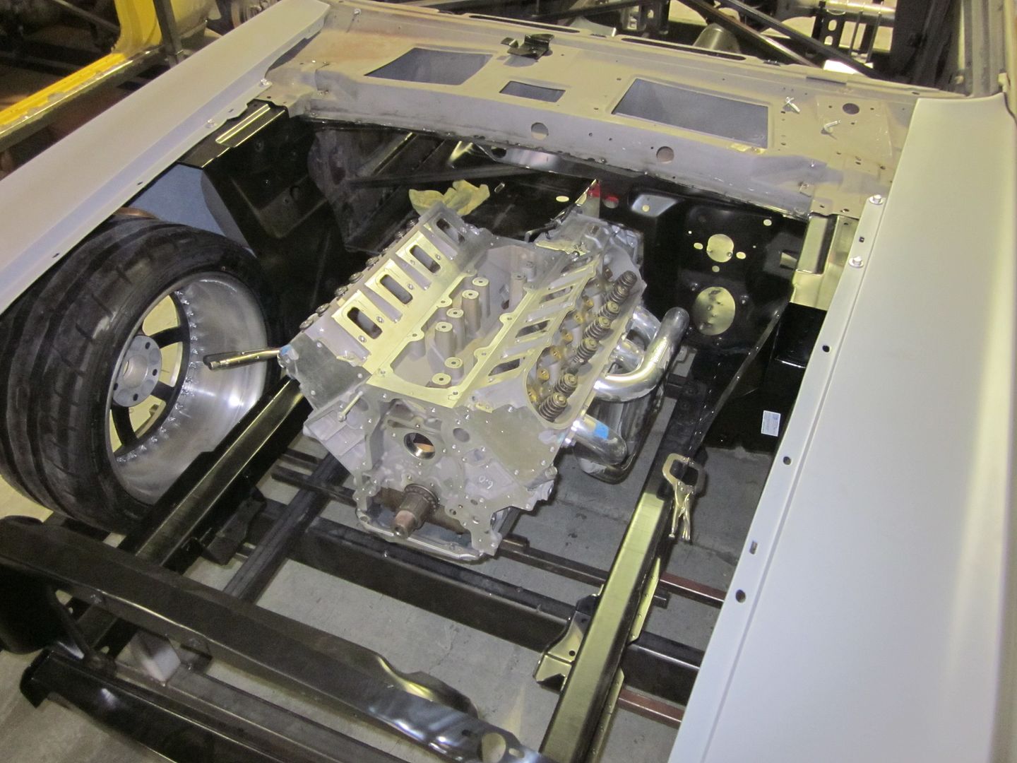

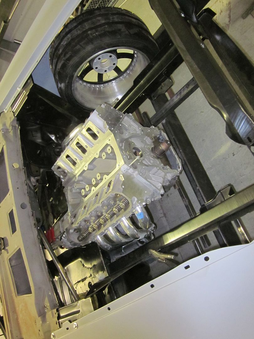

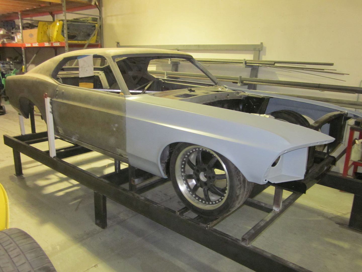

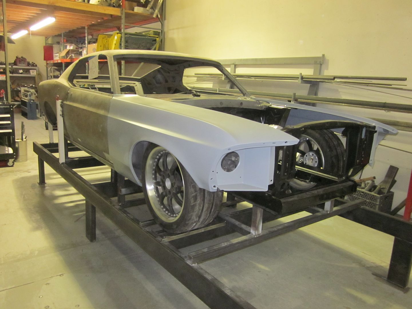

With all the changes going on this Mustang.. I feel like we got something done this week on her! We got most of the main floor structure back in place with Firewall.. though we cut a part of it out.. Got the doors back on the car with the front Anvil 1.5 stretched fenders.. Got the LS with T56 staged between the frame rails.. got plenty of room now.. Looks like the 1st gen Camaro LS headers from Dynatech will work.. We moved the motor as far back as we could.. Some progress :_paranoid
http://i1015.photobucket.com/albums/...n/IMG_1824.jpg
http://i1015.photobucket.com/albums/...n/IMG_1825.jpg
http://i1015.photobucket.com/albums/...n/IMG_1826.jpg
http://i1015.photobucket.com/albums/...n/IMG_1827.jpg

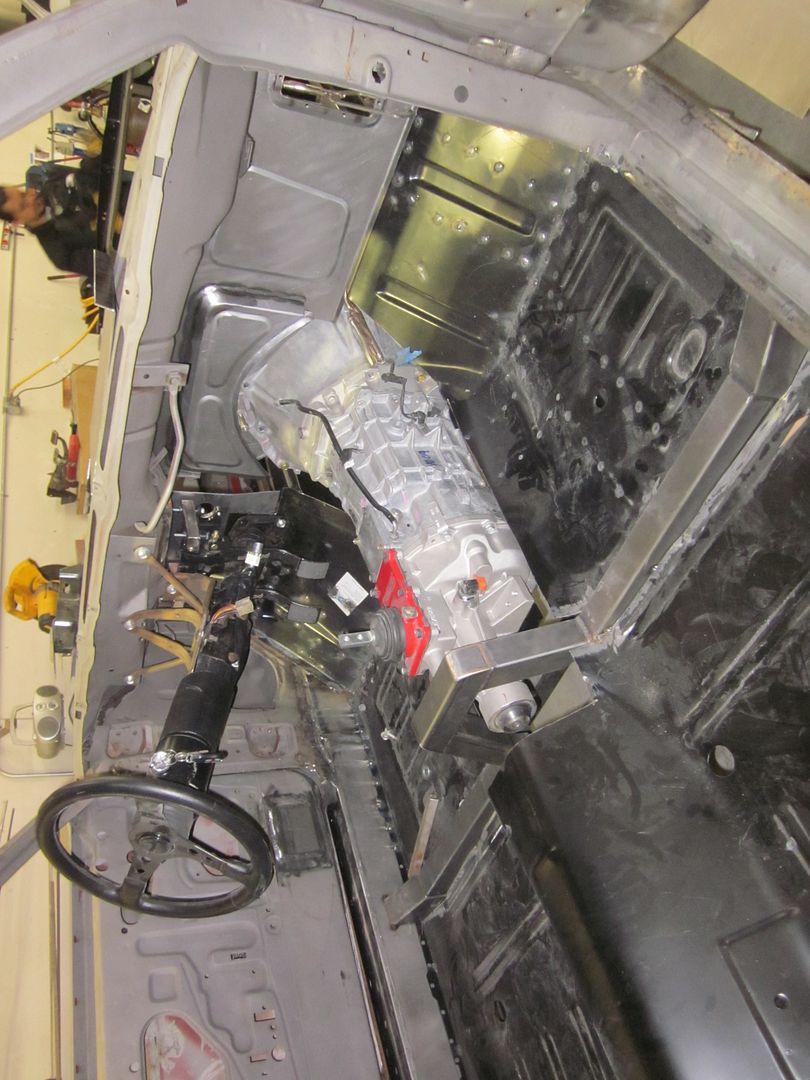

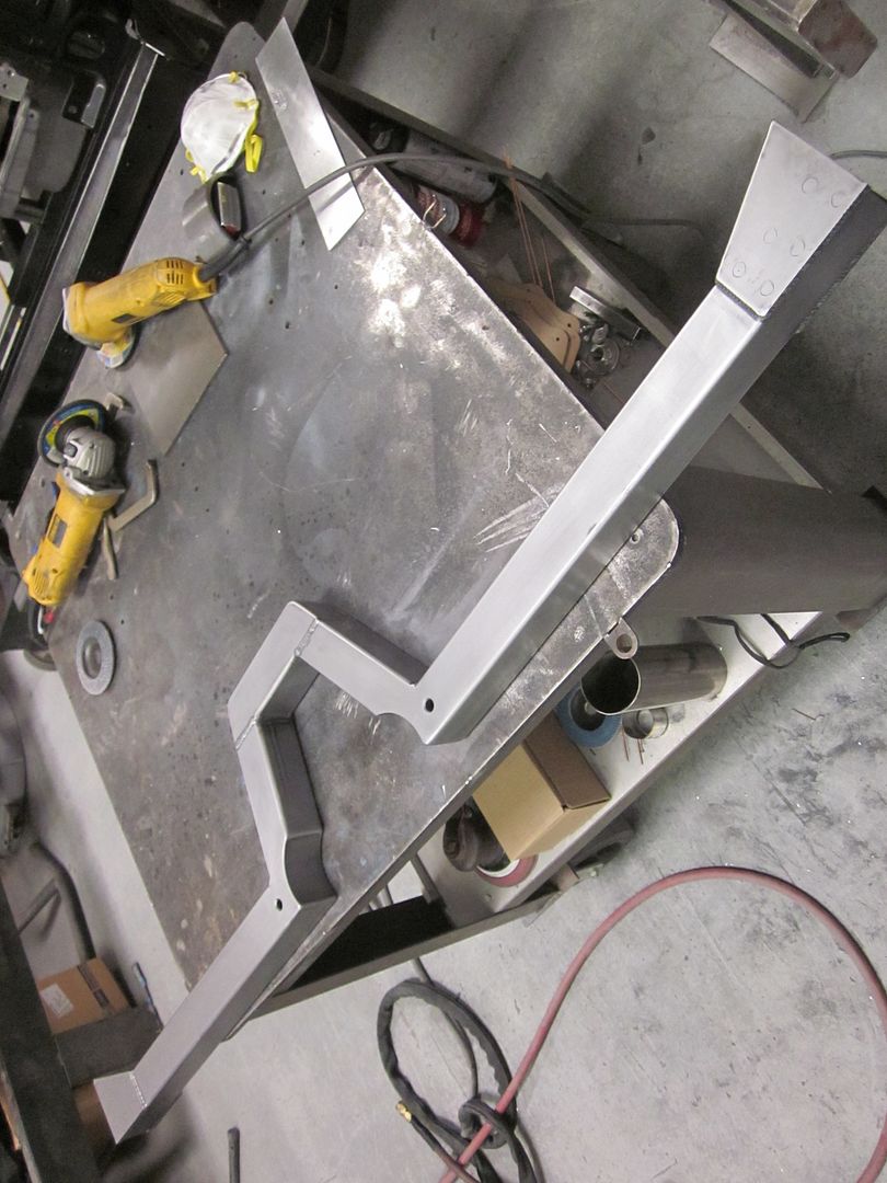

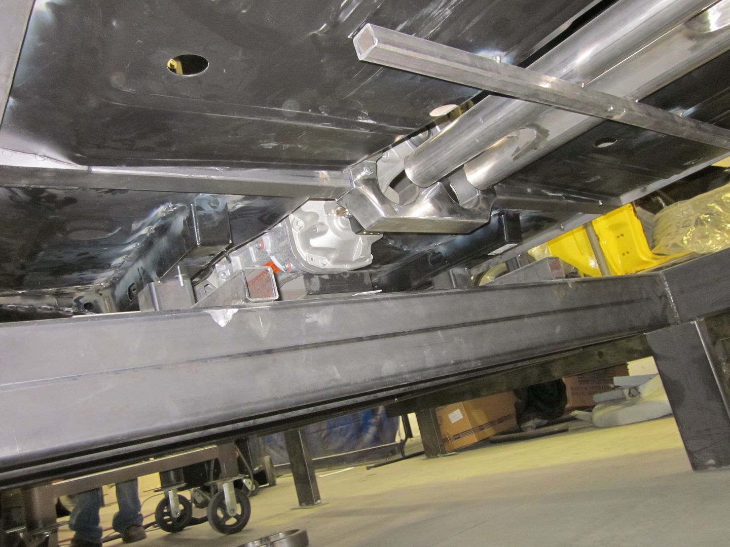

Thanks Bryce! This is where we finished off today.. Their is a 1.5 x 1.5 x .120 square tubing built into the frame of the firewall that ties into the new rockers we built & the torque boxes.. I got some cool ideas for the down bars.. got to get some parts machined for that..
http://i1015.photobucket.com/albums/...n/IMG_1936.jpg

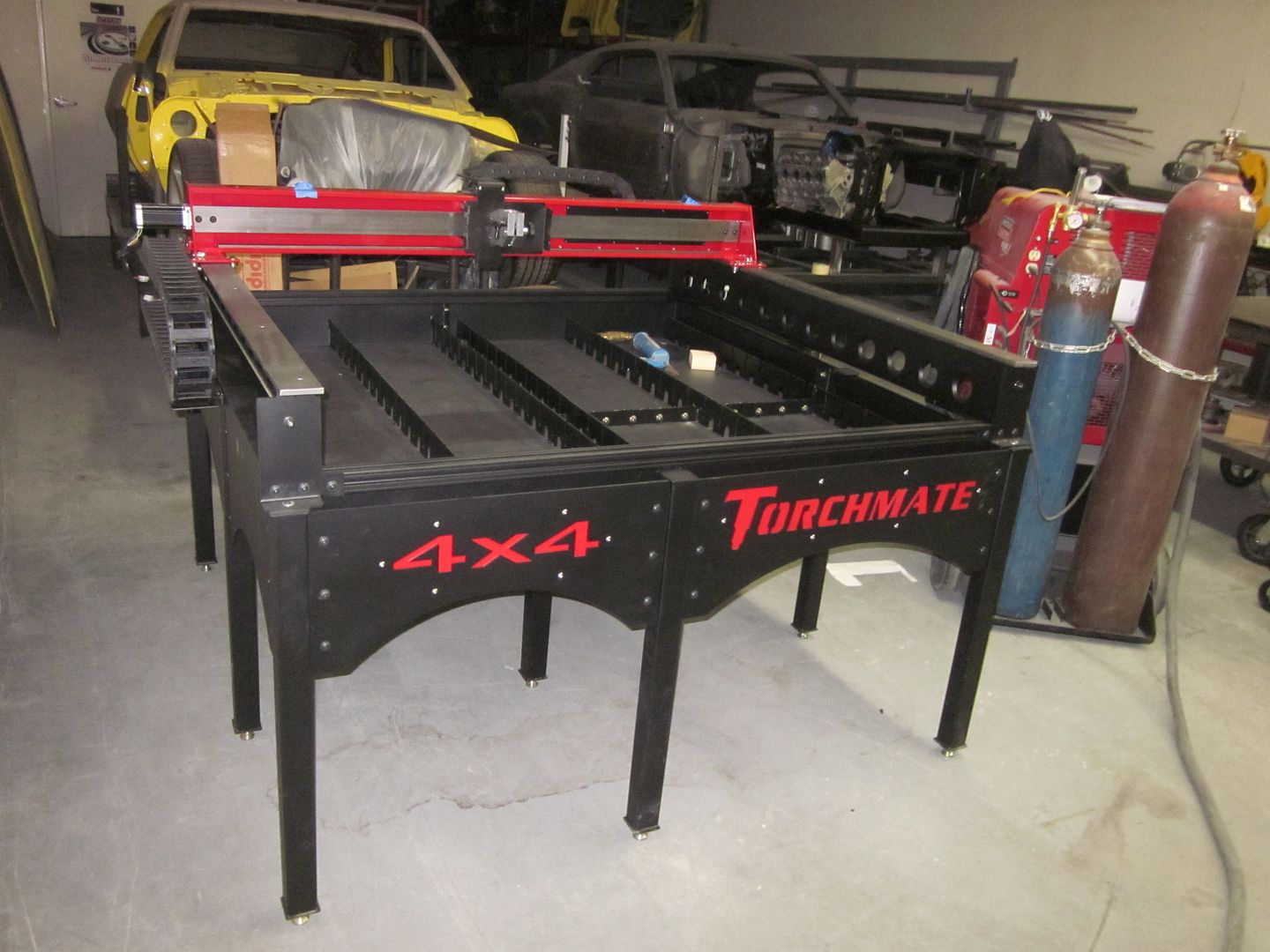

Next week I fire up my new toy! Looking forward to the pcs we will be fabricating soon!
http://i1015.photobucket.com/albums/...n/IMG_1934.jpg
