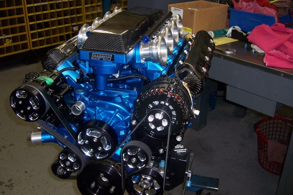

Originally Posted by garickman (Post 501680)
Harrop posted this picture to their facebook page and it got 1100 likes and 96 comments in just 5 hours. Mad props to the guys at Wegner Motorsports.
https://www.facebook.com/harropperformance
http://i1126.photobucket.com/albums/.../WEGNER030.jpg
Looks like a piece if jewelry,,, congrats to all involved.....
