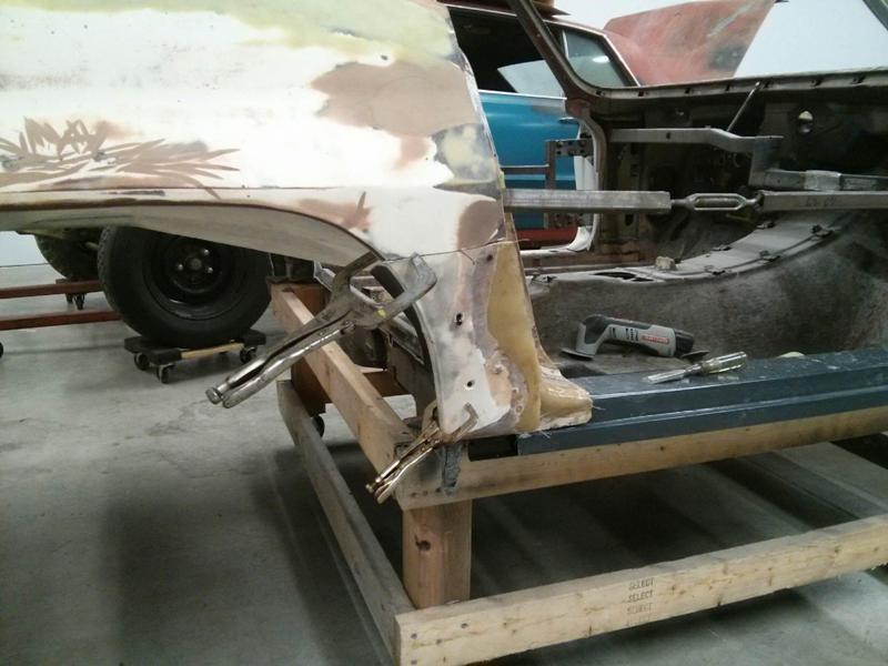

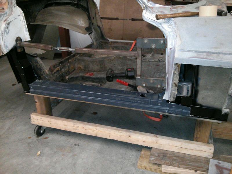

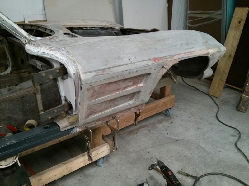

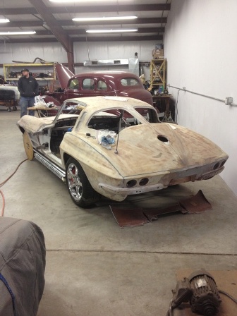

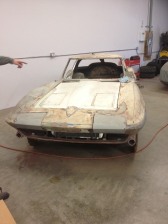

Mike repaired the lower section of the birdcage and added the fiberglass over the top
Attachment 47561
Fiberglass reattached
Attachment 47562

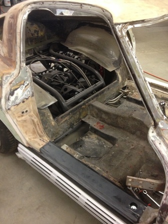

Original rotted piece against rear
Attachment 47563
Attachment 47564
Attachment 47565

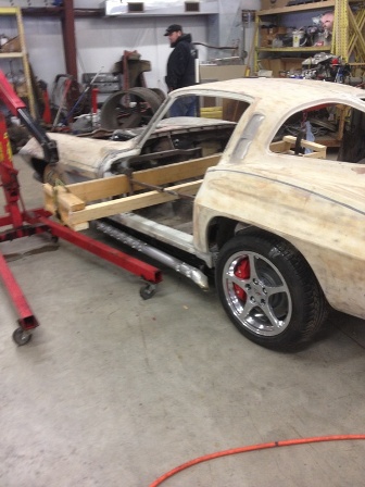

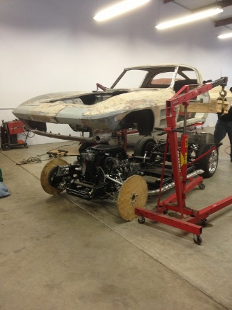

Semel1 04-22-2014 09:33 AM

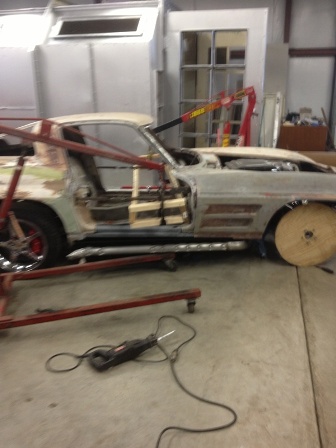

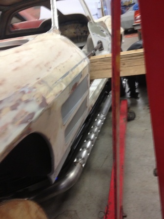

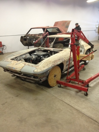

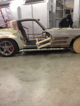

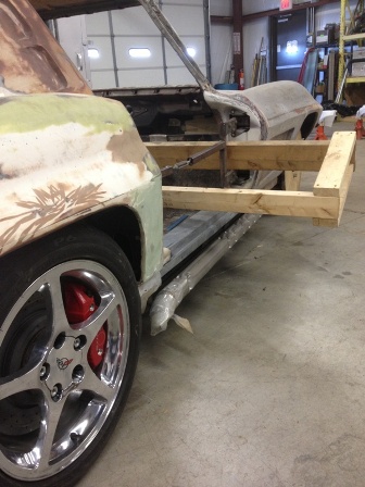

10 Attachment(s)

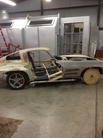

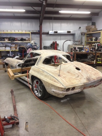

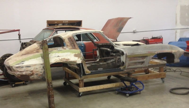

Didnt have access to lift, so a jig was made that fit thru metal attachments made for door opening and utilized 2 engine host to lower body on new chassis
Attachment 47566
Attachment 47567
Attachment 47568
Attachment 47569
Attachment 47570
Attachment 47571
Attachment 47572
Attachment 47573
Attachment 47574
Attachment 47575

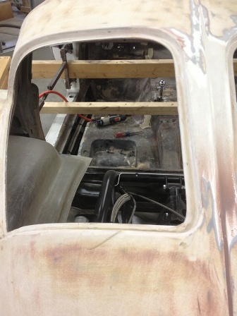

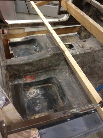

Semel1 04-22-2014 09:42 AM

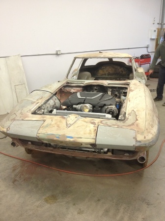

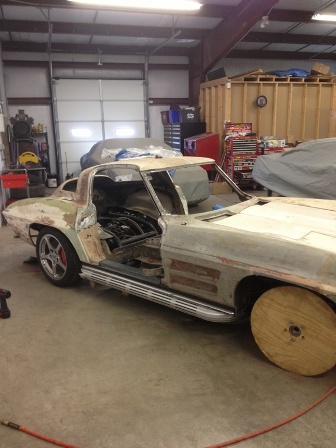

10 Attachment(s)

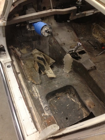

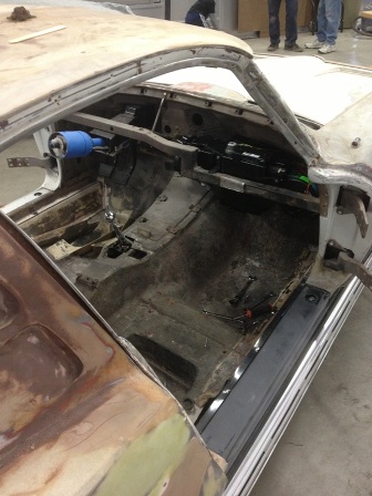

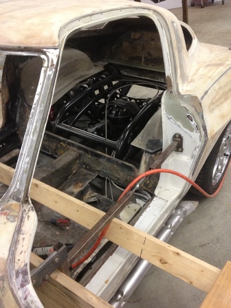

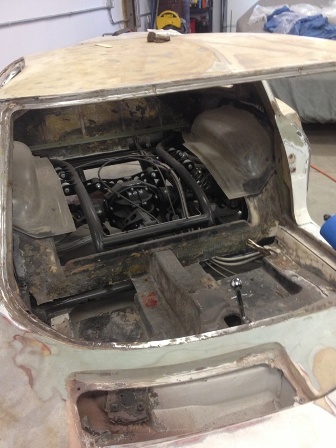

Cuts to rear floor in order to get chassis to fit to body. Wheel wells already in place
Attachment 47576
Attachment 47577
Attachment 47578
Attachment 47579
Attachment 47580
Attachment 47581

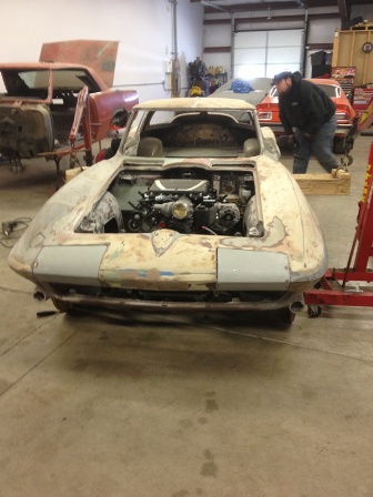

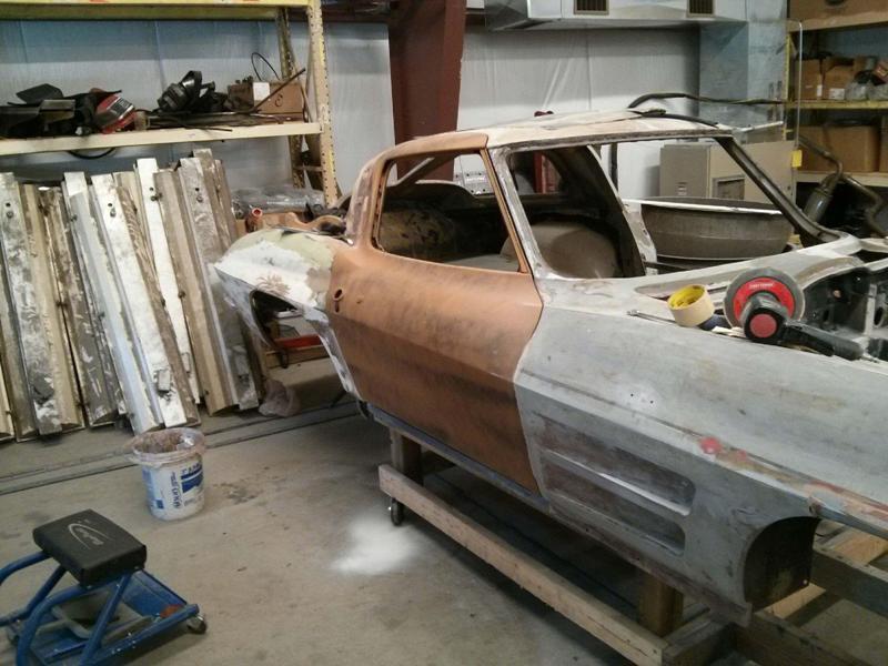

After making somemore cuts to the floor area body is sitting correctly
Attachment 47582
Added the SS Ididit steering column and Vintage A/C system
Attachment 47583
Attachment 47584
Dewitt LS conversion radiator
Attachment 47585

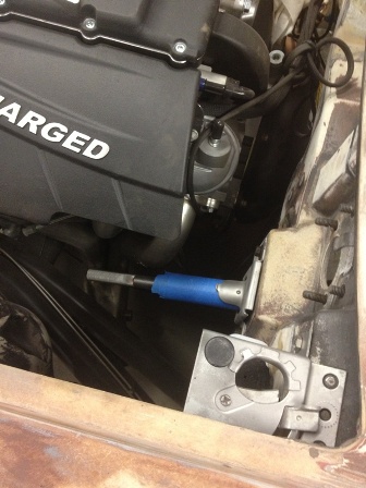

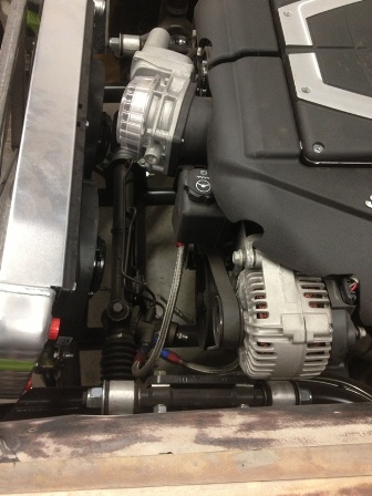

Semel1 04-22-2014 09:51 AM
4 Attachment(s)
Attachment 47586
Attachment 47587
fans hooked up
Attachment 47588

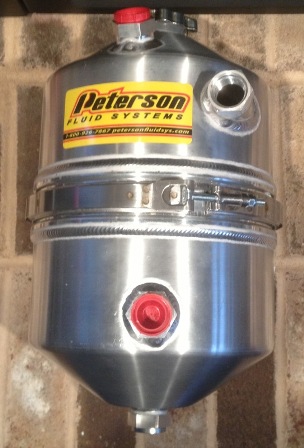

Peterson 3gal dry sump oil tank
Attachment 47589
