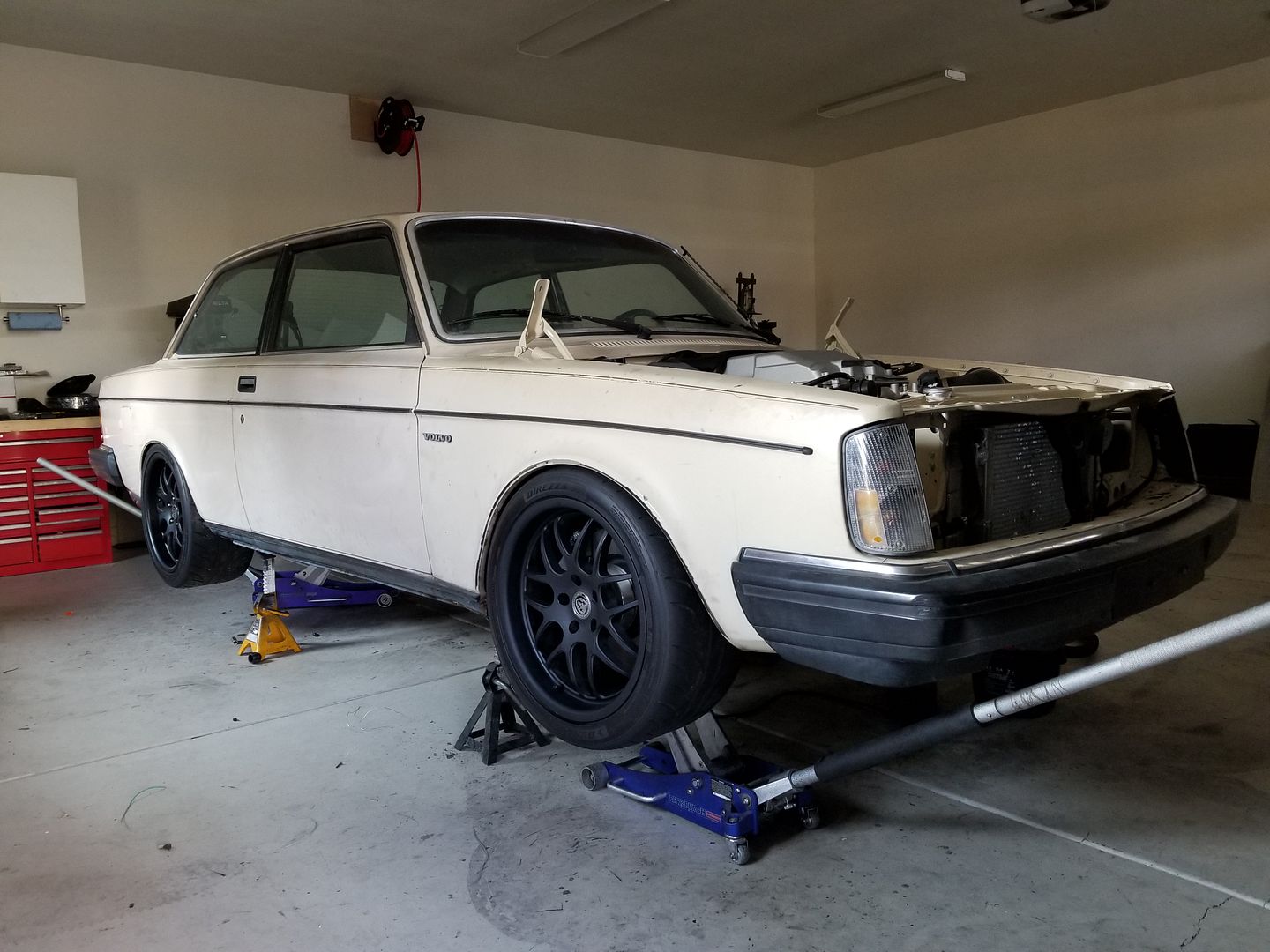

http://i1133.photobucket.com/albums/...ps7tfatqlk.jpg http://i1133.photobucket.com/albums/...psdvynrazj.jpg It is just mocked up because some idiot put the wrong wheel studs in front and back, 12x1.5 front and 1/2-20 rear..... I had a question about the rear brakes and called the wilwood guy to discuss, he said that they have no application for my rear axle.......even though its the fourth call to him and the 3rd kit and I have everything bolted on..... My question was that this is a c clip axle and the kit came with bearing retainers that I dont need to use. Can I just omit them from the kit? Then he asked the application. I told him 83 volvo =) with an LS and an 8.8 from a 1997 ford explorer. The phone started to smoke he was so confused. Happy Thursday all!! Sean |
I have gotten that response so much I thought it was normal when building a custom vehicle. Hahaha! |
YES!!! Thanks.... And for what it's worth, I've had Metric studs up front and SAE studs out back for probably 8 years now, you get used to it after a while... :poke: |

Been seriously lacking motivation but gotta get this POS done before spring so here we go again!! When I got it buttoned up to move, it was just to get it to roll so there is a lot of stuff left to do that nobody would ever see. I started at the back of it and am working my way forward. I needed to create an access panel in the trunk to get to the new fuel pump location, I started with the stock location and worked my way over to the new pump location, hole saw and some tin snips and we have a nice clean opening, some riv nuts in the body and a nice aluminum plate to cover it all up and make it a little more safe. I also tightened all the fuel connections and buttoned up the wiring and weatherpack connectors for the fuel pump. http://i1133.photobucket.com/albums/...pszujpebr0.jpg http://i1133.photobucket.com/albums/...psyreywuua.jpg With that buttoned up I got to doing all the safety wire on the rotors, believe it or not this is a very nice task and once I got it down I enjoyed doing it. http://i1133.photobucket.com/albums/...psfj9q69t1.jpg I had not gotten around to rear brake lines, so that was next, I had some brake lines made locally as the first ones I got were too long at the caliper and ran into the spring. Drilled and tapped the axle housing for some tabs and got those on, hard lines bent up and tightened and the flex lines on. Torqued the calipers, loaded up the pads and the aside from fluids the rearend is done!! http://i1133.photobucket.com/albums/...pscgbb7i6s.jpg http://i1133.photobucket.com/albums/...psrfdoaplq.jpg One other item to note, my terminals I had originally ordered and installed were just too bulky and got too close to the battery mount, I was worried about wear over time or something moving around and shorting so I picked up another set that are smaller but use lugs to connect instead of allen head screws in the terminal. This meant undoing everything and crimping the new ends on the wire in the car. My Hydraulic crimper worked great for the smaller stuff but had to borrow my neighbors big crimper for the 1/0 guage, its total overkill but never have to worry about it not having big enough wire.......I got it all for free too. I like how this has turned out. http://i1133.photobucket.com/albums/...psgqoiaeek.jpg So guages should show up today, Racepak IQ3 Street Dash, I have a new battery on order, going to try and start getting fluids in this week, heat up the electrical so we can pull the factory tun out of it and start working on a new tune. |
