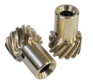

Appreciate it:cheers: I am posting this more in an attempt to help someone else not get stranded on the side of the road. As I posted on the last page I sheared my distributor gear last weekend at about the 1600 mile mark. The engine was built and dyno tuned by a Nascar engine builder. The performance has always been excellent. I did start to notice a little drop off in power the last few times I drove it before the failure(including the video footage) I had needed to turn up the idle due to low idle not long ago as well. It all ads up now. I hadn't timed the car in quite some time. With the distributor gear wear I bet I lost 5-10 degrees of timing. Anyway....after doing my research and reviewing my engine file I determined that my billet hydraulic roller cam had a pressed on cast iron distributor gear. That is a great thing, but the engine builder used a bronze gear.
http://i200.photobucket.com/albums/a...9/121-8471.jpg
It's basically an aluminized brass gear made for billet steel cams without a pressed on cast gear. It's also used frequently by the drag guys. It's absolutely not meant for the street especially on a cast gear.

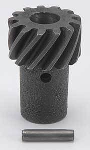

This is the correct gear for my application. It's a GM melonized cast iron distributor gear. It should give me the reliability we all need for the street. It comes on most GM hei's and so forth.

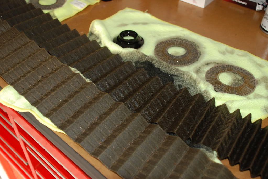

I cut open my last two oil filters and strangly enough the last one had very little debris where the one before had a decent amount of brass. It looks like the oil filter did a great job of catching the wear. I had changed it 4 times in the 1600 miles.

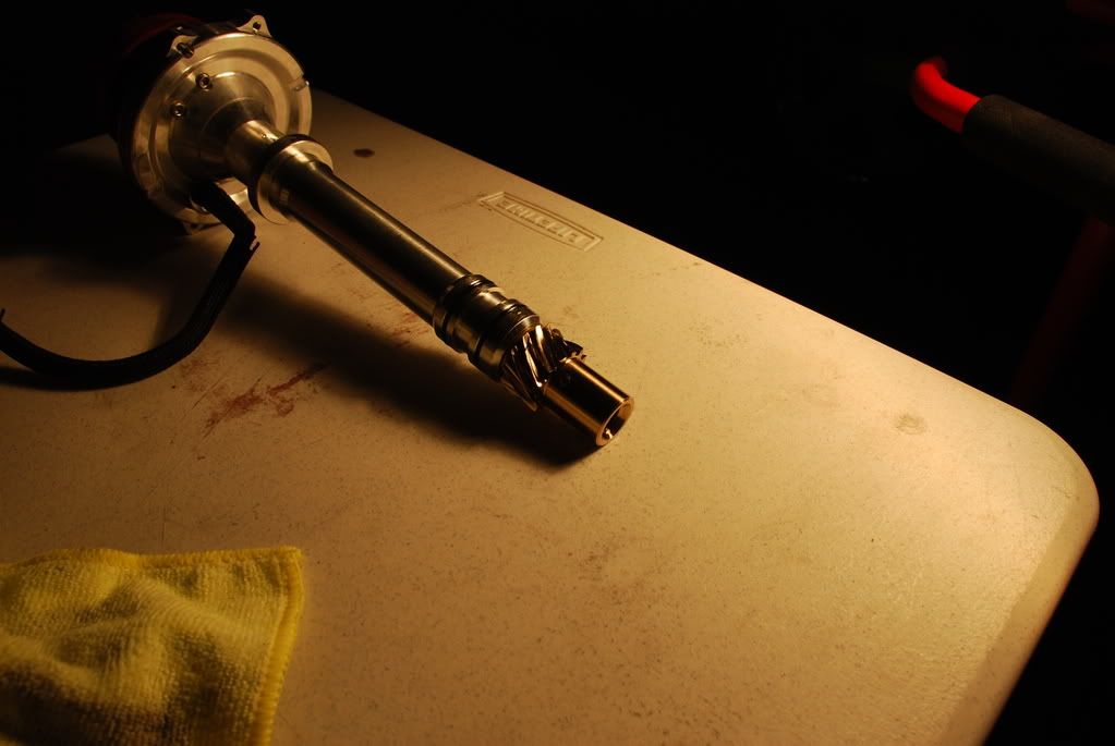

Vegas69 03-10-2009 08:08 PM
I was a little pissed that the builder put in the wrong gear. Of course there is a possibility of some bearing damage. After many calls and an email he finally called me. He swore my engine had a steel gear and needed the bronze gear. Until I told him which camshaft it had. He admitted they let it get past them and it was there fault. He also said he thought I would be fine but he would stand behind the motor if I have a failure. I changed the oil again and dumped a couple quarts to flush out any debris.

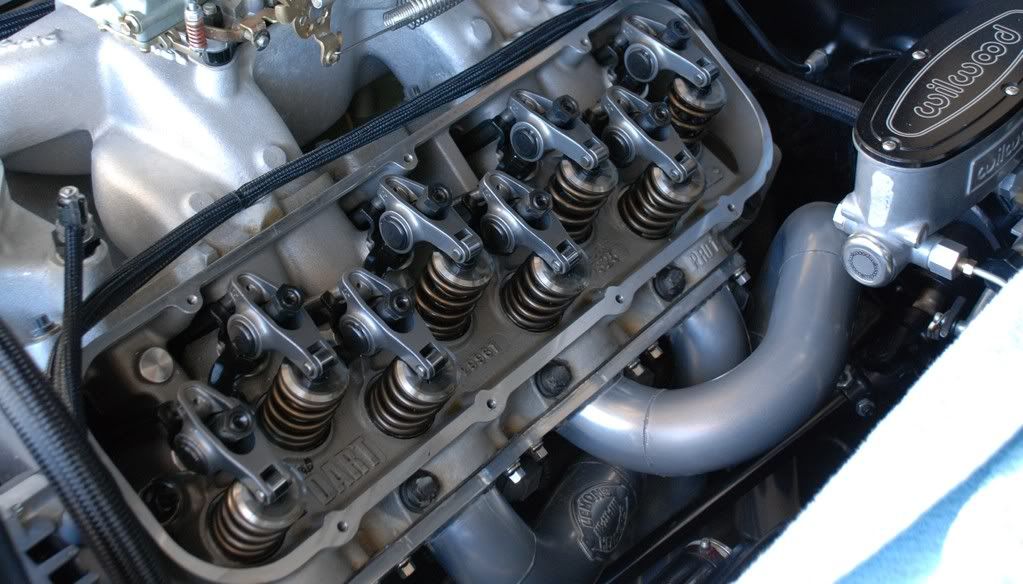

While I was messing around changing the distributor gear and retiming the engine, I decided to fix a seap around the crancase ventilation fitting that started in the last 200 miles.
http://i200.photobucket.com/albums/a...1969/001-2.jpg
Gotta love a big block with the valve covers off with a set of dart pro 1 heads and comp rollers.
http://i200.photobucket.com/albums/a...9/IMG_0524.jpg
Hear is the fitting that dribbled. I used a dab of blue loctite on the threads.(Suck it the inside fell onto the rockers at 6k) and used some silcone on the washer. Should do it.
Timed her at 36 total and 18 degree intial and went for a 80 mile road test.:D :D Never run better! Car is ****** sick.
