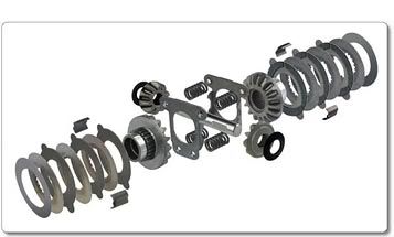

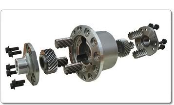

Cris@JCG 07-12-2010 09:17 PM
http://i1015.photobucket.com/albums/.../ct_125986.jpg
http://i1015.photobucket.com/albums/.../ct_126000.jpg
Originally Posted by Gonzo (Post 295907)
I just got off the phone with Larry C from Pro-Touring.com.. He was having serious issues with piston knock back on his rear brakes & took his car over to Wilwood to see if the issue could be fixed.. He has a 12 bolt with Torino ends & using a Detroit Truetrac.. Wilwood did eveything they could do to work out the end play out of the axles.. but was still having piston knock back.. One thing that was discovered was that when the car was put up in the air & the load was taken off the wheels, it would hang the tires as if something was lose.. Put the rear on load & it would tilt the wheels in..
I just looked up on how a Detroit TrueTrac unit works.. worm gears is how this unit works.. They do not machine a bore to locate the gears that go into the splined portion of the axle.. If the axle is not located on the splined portion of the posi unit it is going to create alot of movement that can hurt the outer bearing & seals on the axle end..
Now take a look @ a Detroit Locker with spider gears & clutch pack.. the spider gears that go on the splinded portion of the axle is bore machined & located on the posi unit that keeps the axle cented on the axle tube..

Cris, I'm not following you. From the exploded view the ture trac does have a smooth bore for the axles to slide into then the splines.

Todd, After I posted the pic on the TrueTrac I noticed the it has a shaft that located on the out board of posit unit, but look @ the inboard towards the center of the unit.. flat surface which can create movement & transfer it to the axle bearing on housing end.. If you have a shaft that measures about 30 inches long & want it to run concentric.. It needs to be supported frim on both ends..
I am just looking & reseaching right now.. not saying that TrueTrac is problem..
Lockers do make alot of noise.. The exploded view I posted is a Limited slip not a locker..
