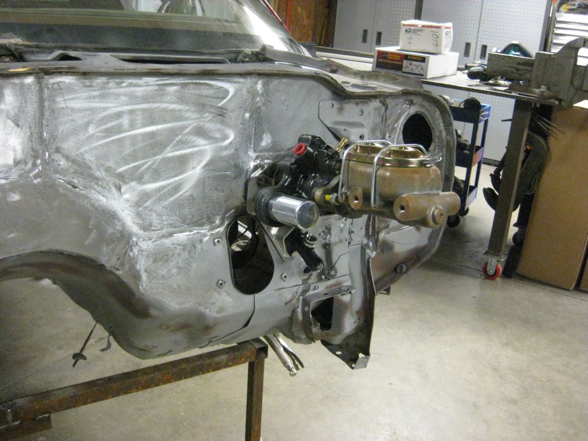

Brake master cyl, clutch cyl and steering column are in, using Mean Streets brackets. The clutch cyl reservoir will be hard plumbed.
Steering column is in, with a custom bracket that mounts the column low in the firewall.
grendel 08-09-2016 02:50 PM
Went manual brakes. Didn't have room with the down bars to fit the Baer Re-Master... now have one for power/hydro assist disk/disk since it was easier to buy a new one with smaller bore than change the bore I had.

Today's lesson is all about math. How to make a manual brake set up really work... requires leverage and drilling the brake arm to get it right.
We did that, with the help of Baer. Might do this on my black GMC.
I did find a set of Carbon Ceramic brakes I am noodling on.
waynieZ 08-11-2016 08:44 AM
How much did you end up lowering the mounting point?
grendel 08-11-2016 08:54 AM
If you mean the column? It went from the top of the opening, to the bottom.
If you mean the brakes?
We followed this:
http://www.mpbrakes.com/techtalk/how...ng-pedal-ratio
We did a 5.5:1 ratio... splitting the difference.

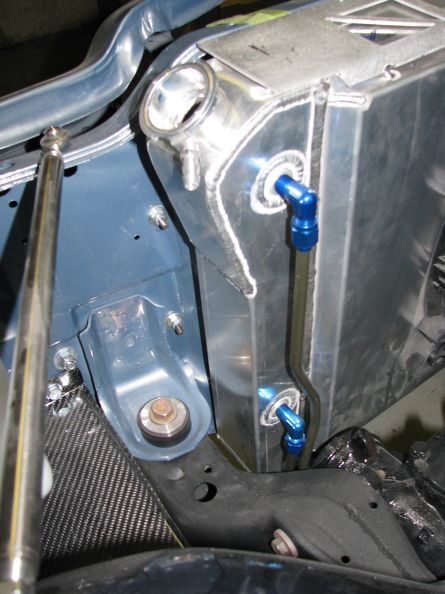

syborg tt 08-11-2016 01:09 PM
Is your radiator larger then stock ??
https://lateral-g.net/forums/atta...1&d=1469752364
grendel 08-11-2016 01:30 PM
It's an Entropy radiator for an LS in a 73 Camaro... stock sized, that I know of.
syborg tt 08-11-2016 01:51 PM
Looking at your pictures and looking at mine and my Subframe it looks like I will have to modify it similar to what you have done.

grendel 08-11-2016 02:09 PM
I think you do, too.
Not hard to figure out, with a measuring tape.

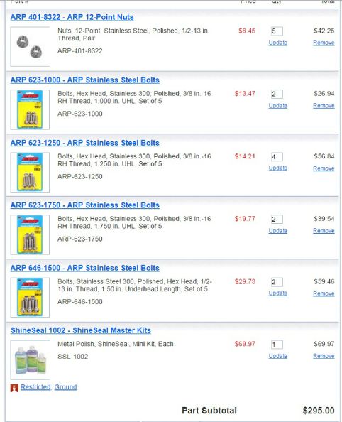

syborg tt 09-22-2016 01:02 PM
Here are the part numbers for the ARP Hardware for the Tiger Cage.
http://www.garagescene.net/_data/i/u...715f31c-me.jpg
grendel 09-24-2016 08:45 AM
Thanks.
