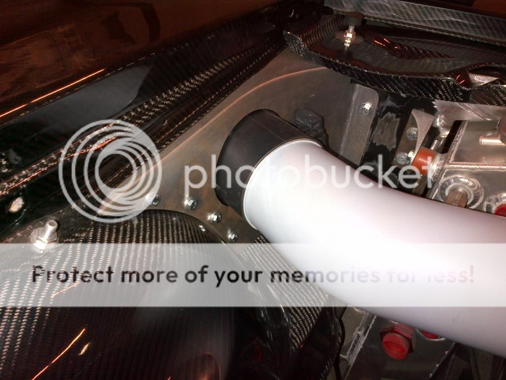

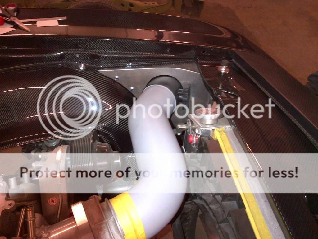

A couple more shots from my crappy Blackberry.
To package the air cleaner was a bit of a task. Having all the inlet air come from the grill and sealed from the underhood air is worth a lot in power and drivability.

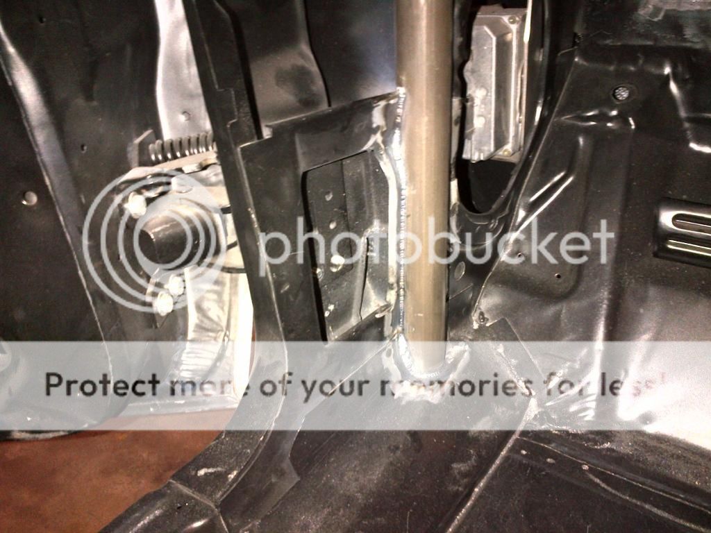

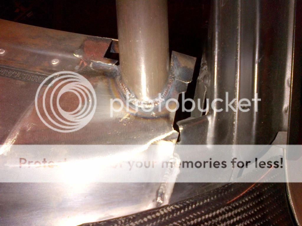

We tried something new for the front A-piler bars. We sunk them into the structure in the hinge piler to get more room for stuff under the dash and to keep them away from my ankels. Now I can have a dead pedal and keep the stock parking brake.

Matt also weled the bar to the dash on the pass through.
http://i439.photobucket.com/albums/q...psec8a74f8.jpg

Looks great Mark. Sinking it into the hinge pillars has to add big time to the rigidity.
