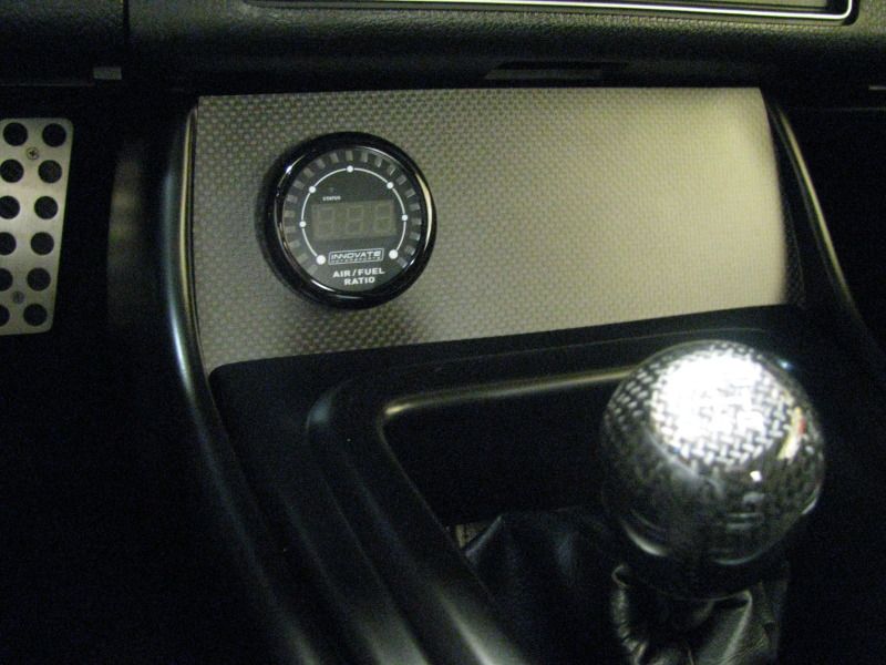

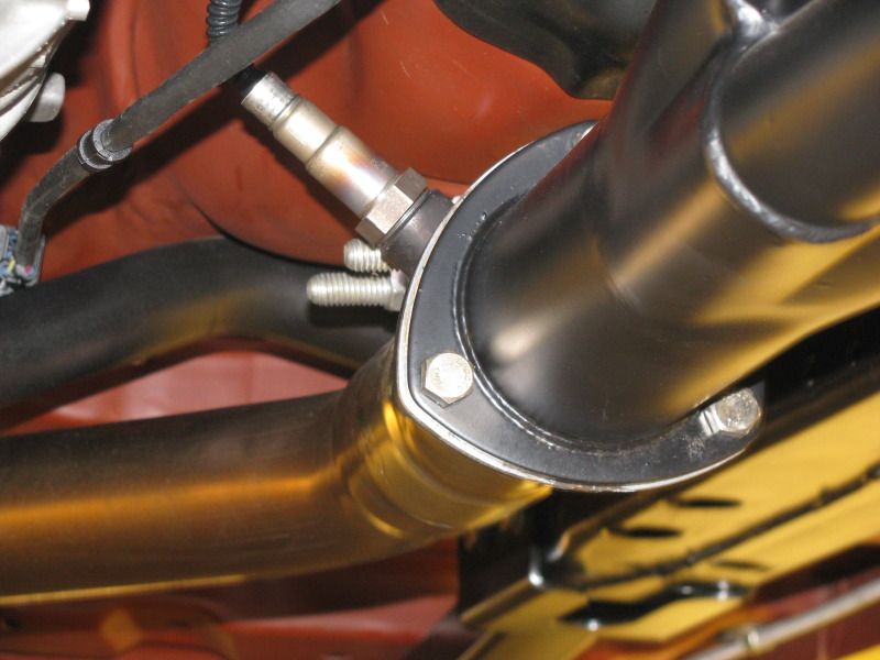

Were did you boys mount your O2 sensor and guage?
The ideal world would be both engine compartment and cockpit. :grin:

The O2 sensor goes (If running headers) in the header collector (welded bung) just after where the 4 tubes dump into the collector and put the gauage anywhere you can see it
protour73 02-24-2013 11:41 AM
Gauge location:

Sensor location:
http://i145.photobucket.com/albums/r...l/IMG_4399.jpg

Is it a major foul to mount it in the pipe behind the flange like Scott did?
I already beat the crap out of the #5 head pipe yesterday, torturing it again vs. installing the bung when the new pipes are installed would be easier. :sieg:
DaleTx 02-24-2013 07:48 PM
Mounting the bung behind the header flange is fine. On the new LS engine I put the O2 sensor for the ECM on the header side of the flange and the O2 sensor for the wideband on the exhaust side of the flange. Works fine.

Sieg, it was way easier when I picked up these new Hooker reducers with the welded flange which seal way better than the slip flange type. I brought the driver side into a locally owned muffler shop and they welded the bung on for $20!!
