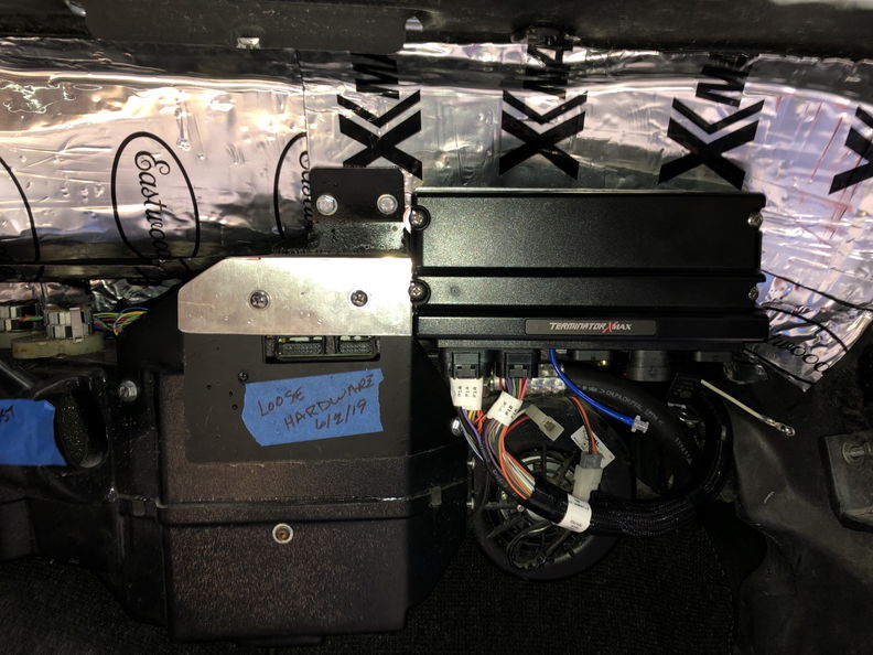

Finally and I mean finally I get to figure out where & how I am going to install the new Holley Terminator X.
The "X" is the newest box and it is significantly smaller then the last model.

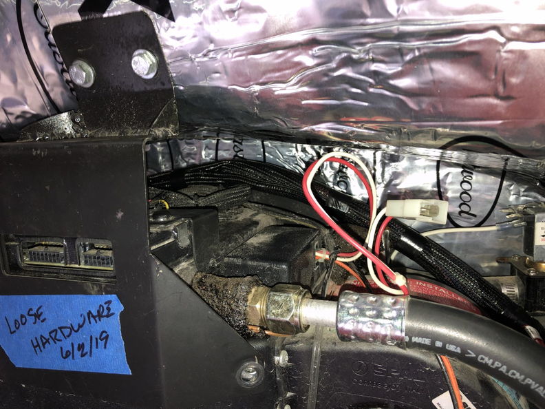

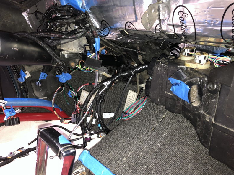

So I have been trying to figure out where the harness is going to exit & this is one possible location.
http://garagescene.net/_data/i/uploa...3263b5c-me.jpg
The plan to would be to tuck the wire behind the vintage Air unit hang them with adell clamps.
http://garagescene.net/_data/i/uploa...be8063d-me.jpg
http://garagescene.net/_data/i/uploa...6051590-me.jpg
Mounting Bracket Idea.
http://garagescene.net/_data/i/uploa...a00c03e-me.jpg

I had Dennis at High Speed Welding make me the bracket for the Holley ECI.
http://garagescene.net/_data/i/uploa...b6d6a9c-me.jpg
http://garagescene.net/_data/i/uploa...af4eba1-me.jpg
Not sure if Kenny made this bracket or Vintage air supplied. Either way I am drilling a hole in it.
http://garagescene.net/_data/i/uploa...9e578d0-me.jpg
Quick trip to Ace Hardware for the necessary hardware and yes I will be using nylock nuts on the bracket as I would have to pull the dash to get to it if it came loose.
http://garagescene.net/_data/i/uploa...ff7940d-me.jpg
Mounted on the Vintage Air Bracket
http://garagescene.net/_data/i/uploa...3ed7186-me.jpg
http://garagescene.net/_data/i/uploa...229558e-me.jpg
Started plugging things in and it appears we are good to go.
http://garagescene.net/_data/i/uploa...94b5db4-me.jpg
And of course I need to get more of these to anchor the Holley Harness
http://garagescene.net/_data/i/uploa...ccdd140-me.jpg
http://garagescene.net/_data/i/uploa...9508268-me.jpg
On a side not I plan to install the lower dash dash to make sure it is hidden.

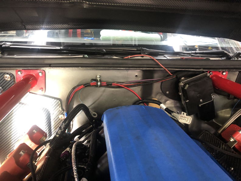

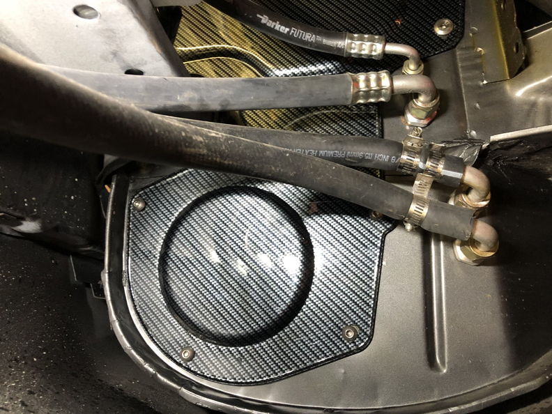

I want to keep the engine bay as original looking as possible so I am not trying to hide the wire. I need to order a new firewall wire gutter so I can route the body harness back to the factory location.
http://garagescene.net/_data/i/uploa...0fd9e0b-me.jpg

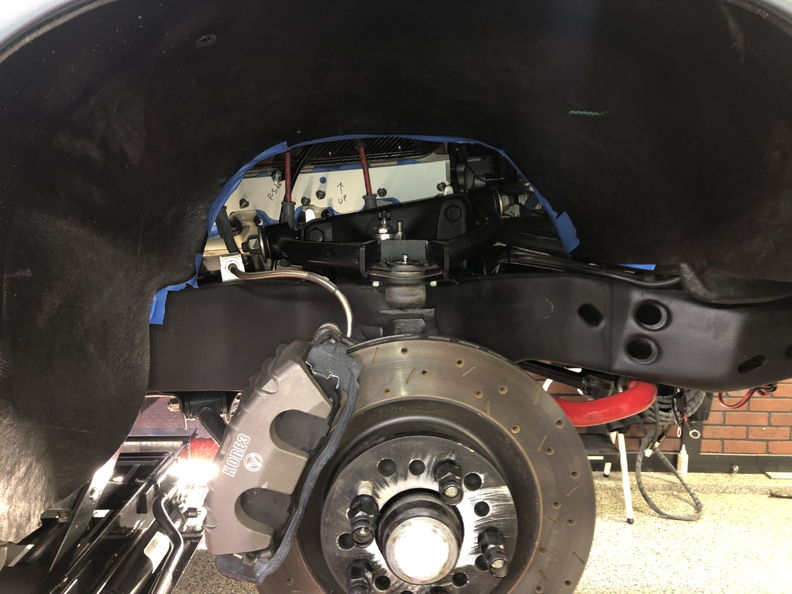

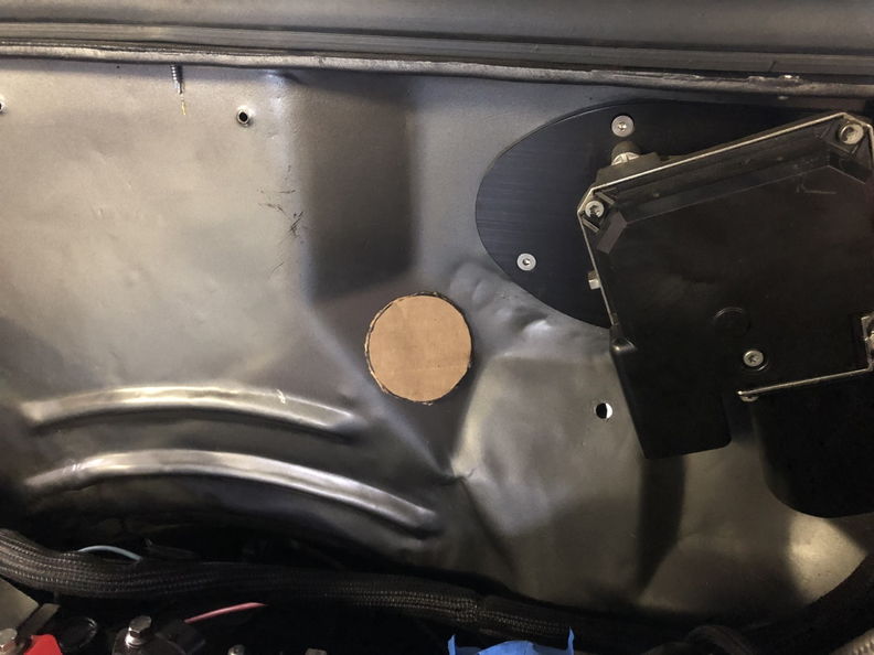

Now that I have determined the power leads for the ECU are going to exit the passenger side cowl and head directly to the battery I am going to have to remove the inner fender.

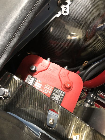

Time to take out the battery
http://garagescene.net/_data/i/uploa...79061cf-me.jpg
and here is the billet Battery Tray we made for 2nd Gen Camaro's. I think I have a few left if anyone is interested and has no desire to put there battery in the trunk.
http://garagescene.net/_data/i/uploa...70310ef-me.jpg
Good thing my inner fenders are carbon as I am certain this little bit of metal shaving would have caused them to start rusting.
http://garagescene.net/_data/i/uploa...1538543-me.jpg

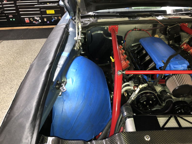

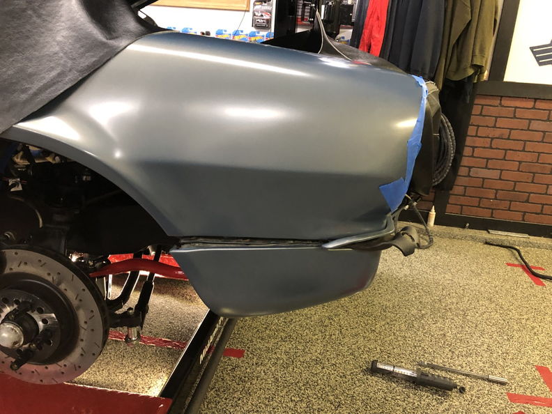

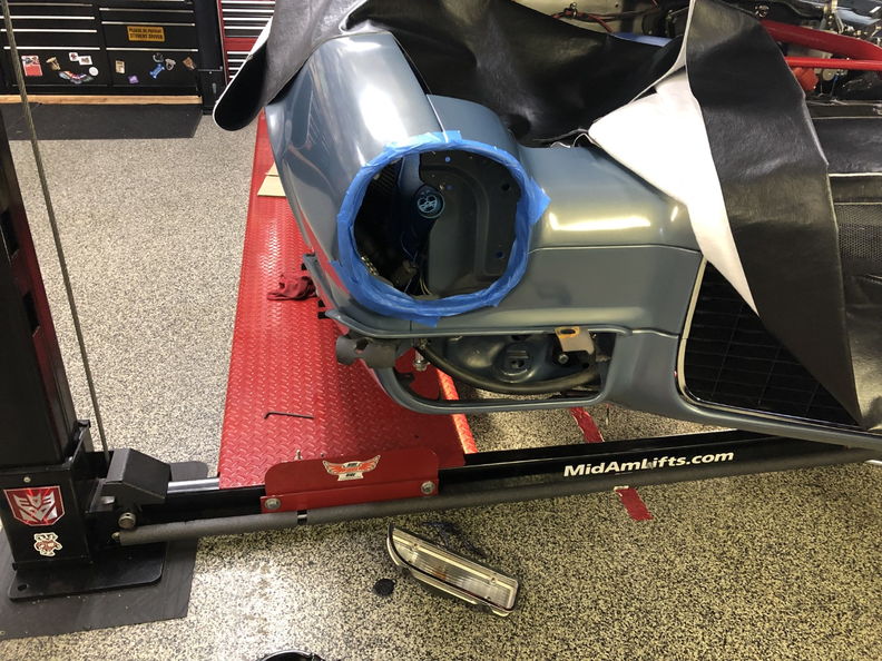

Getting ready to remove the Carbon Inner Fenders. Nervous...Yep
http://garagescene.net/_data/i/uploa...8dae4e1-me.jpg
http://garagescene.net/_data/i/uploa...7657e05-me.jpg
So do you guys think I should consider line-x the inner fender to add a little more protection from flying debris ?
http://garagescene.net/_data/i/uploa...d4978fc-me.jpg
Holy crap getting the headlight buckets out was a bitch and then getting to the fender hardware sucked even more.
http://garagescene.net/_data/i/uploa...23695b8-me.jpg
Finally the last three bolts are out and the lower valance is hanging low enough to get the inner fender out...I hope.
http://garagescene.net/_data/i/uploa...ce7ac1d-me.jpg
http://garagescene.net/_data/i/uploa...9e595b7-me.jpg
It's out and will need a safe home so I may consider bringing these to my warehouse and hiding it on a rack somewhere.

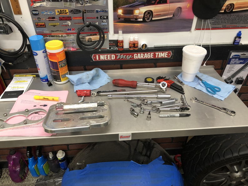

Not sure why I take pictures of the tools that I use but I do.

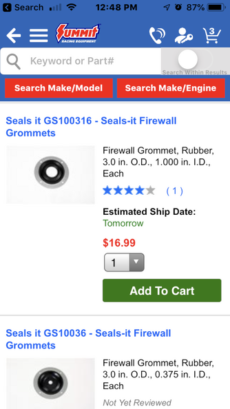

So I need to order some parts and of course I created another To Do list.
