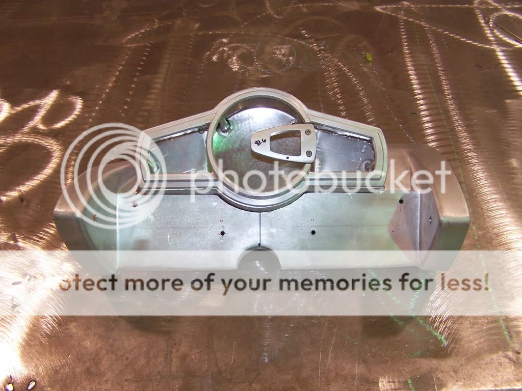

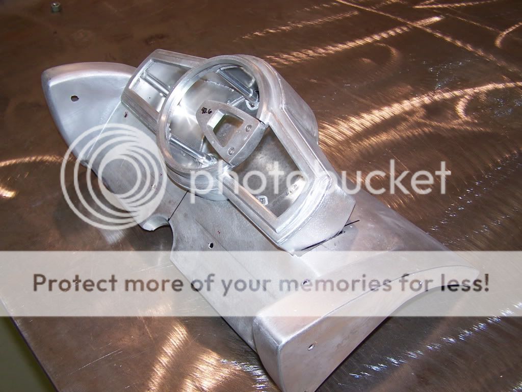

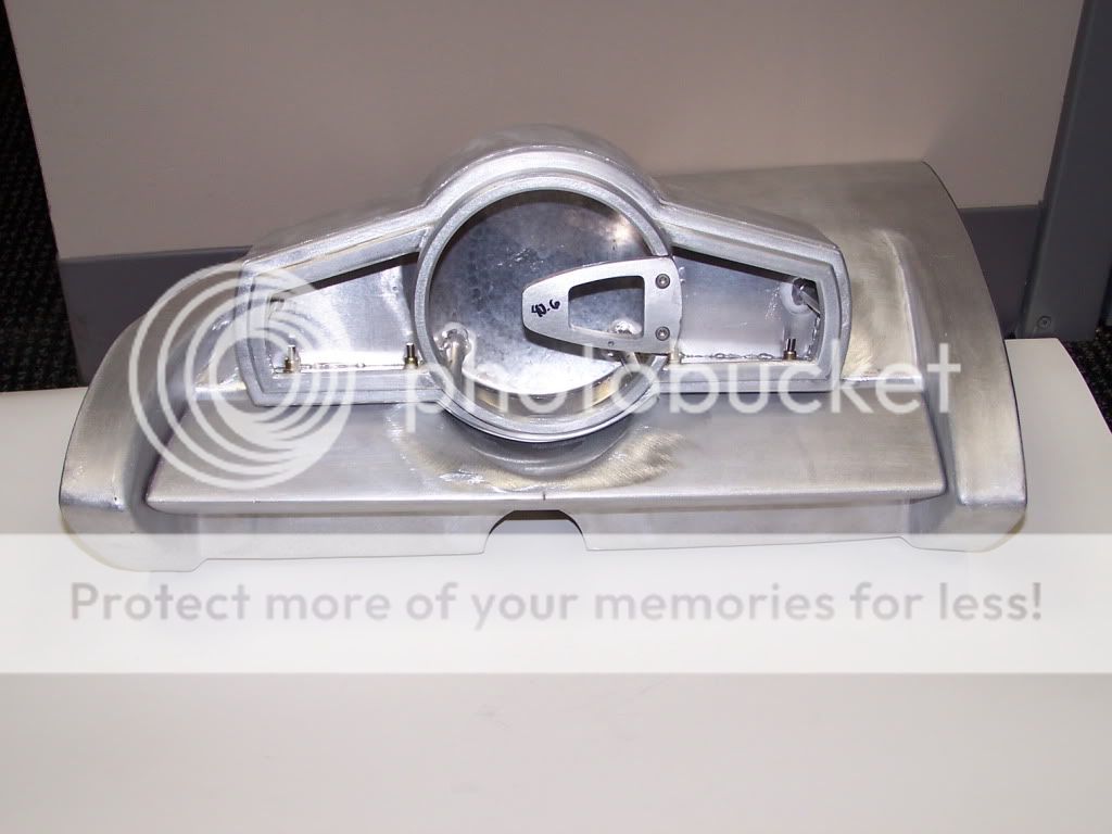

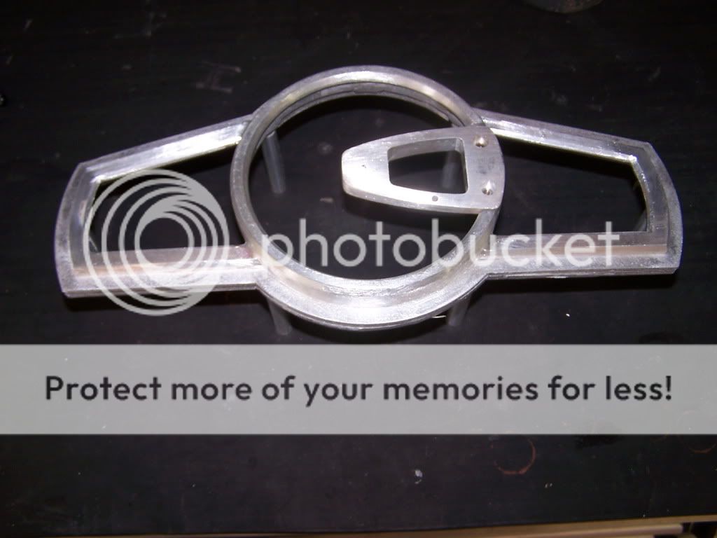

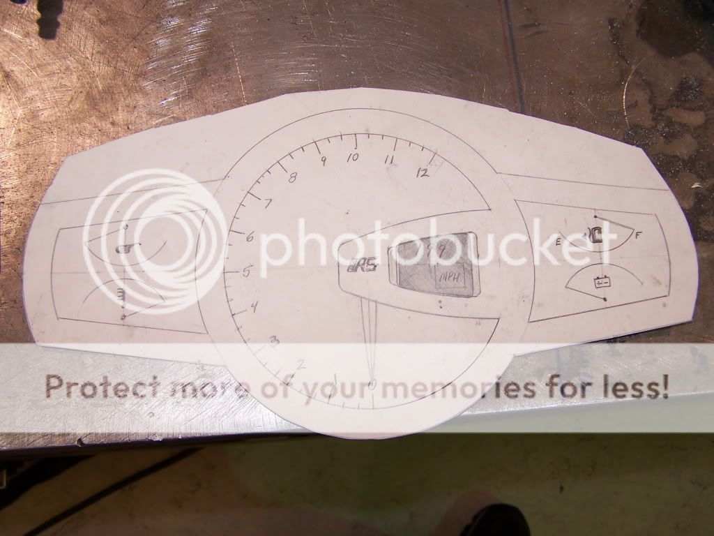

Here are a few more pictures of the gauge pod. Classic Instruments is doing a custom gauge assembly to fit in the pod. It will have a ditital Speedo with a large center mounted tach.
Quick sketch of the gauge layout
http://i563.photobucket.com/albums/ss79/RS-Perf/95.jpg
Fabricated gauge bezel.
http://i563.photobucket.com/albums/ss79/RS-Perf/96.jpg
Gauge pod installed in dash (out of car)
http://i563.photobucket.com/albums/ss79/RS-Perf/97.jpg
http://i563.photobucket.com/albums/ss79/RS-Perf/98.jpg
With lower section of dash installed.
http://i563.photobucket.com/albums/ss79/RS-Perf/99.jpg
