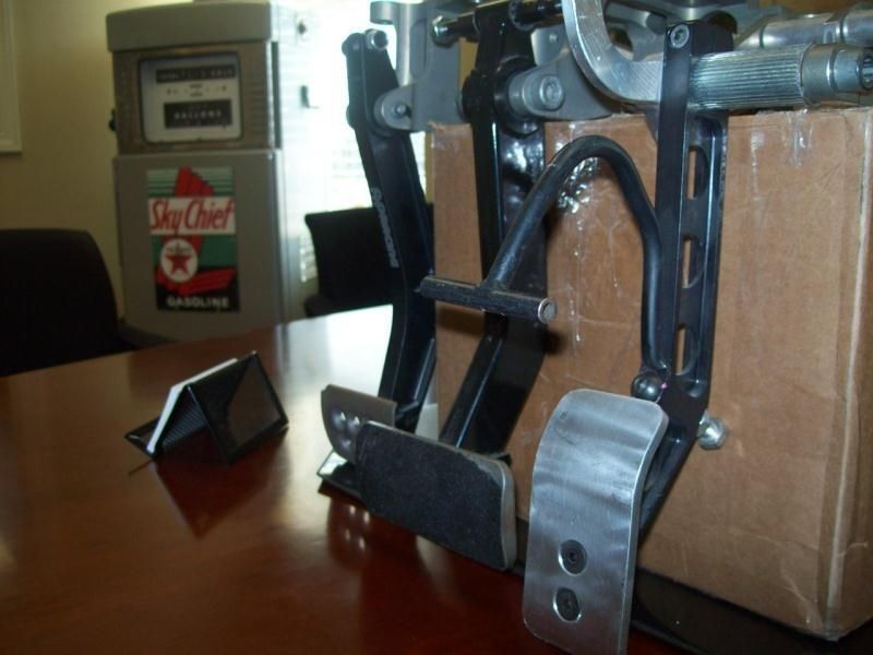

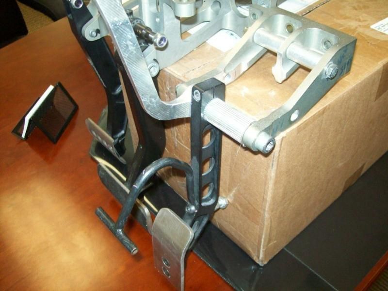

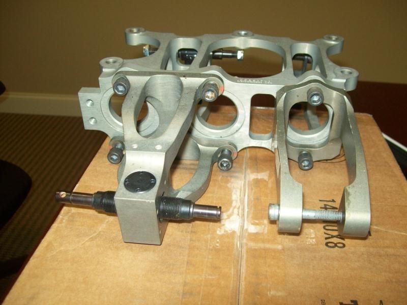

Payton King 05-07-2013 08:32 AM

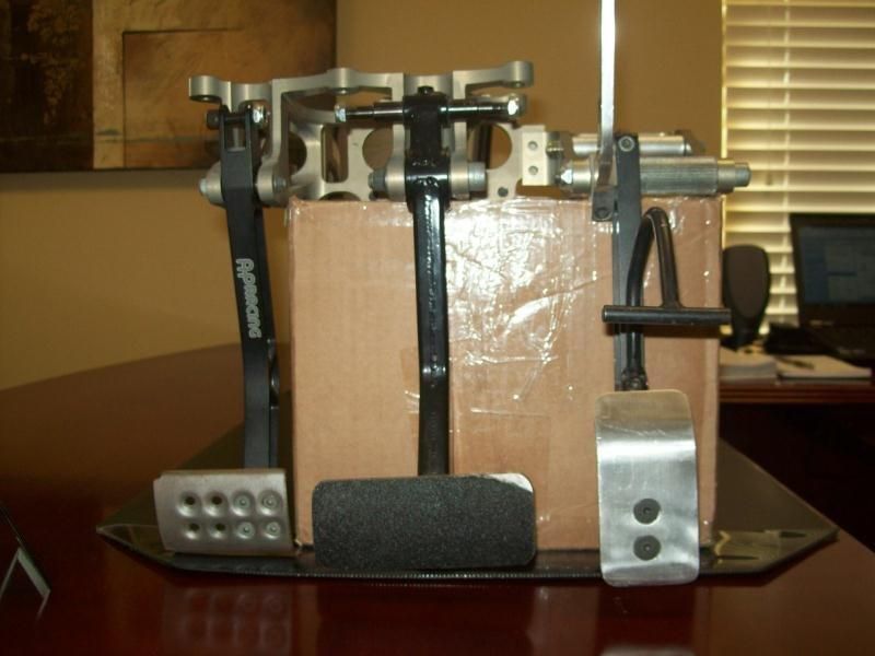

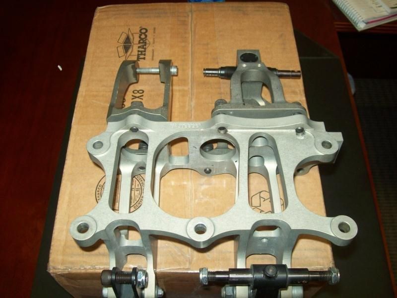

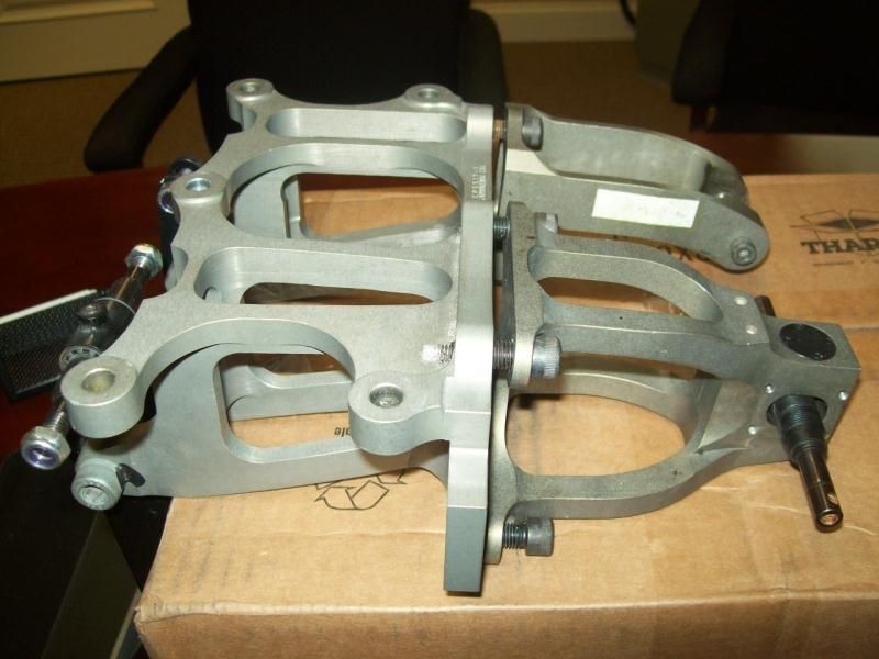

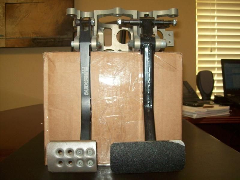

Since we are talking/writing about
the car being street legal. Here is the AP Racing NASCAR pedal box I picked up. Per NASCAR rules the masters must be on the firewall and not in the car and the brake pedal must be steel. This system is the only one I know of that takes a pull type master. The "cage" holds one end of the master and the pedal pulls the rod...No side load with this set-up that can happen with a push type master.
http://i1138.photobucket.com/albums/...ps9195279d.jpg
http://i1138.photobucket.com/albums/...pscd89fabf.jpg
http://i1138.photobucket.com/albums/...psf4543b63.jpg
http://i1138.photobucket.com/albums/...ps2058366f.jpg
http://i1138.photobucket.com/albums/...ps0fb1450d.jpg

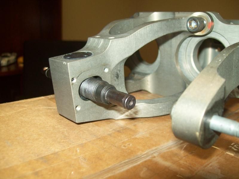

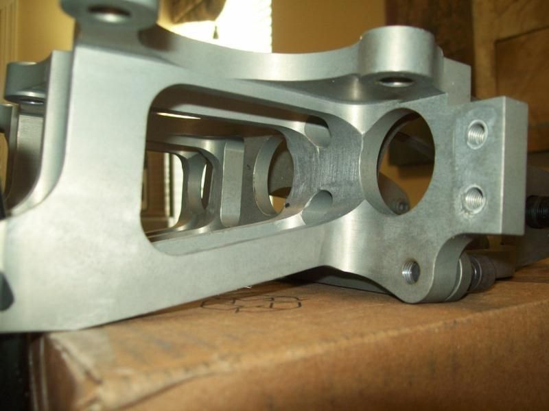

Payton King 05-07-2013 08:34 AM
More pics
http://i1138.photobucket.com/albums/...ps091ccf1b.jpg
This is the gas pedal made for the set that bolts to the pedal box
http://i1138.photobucket.com/albums/...ps2b87d389.jpg
http://i1138.photobucket.com/albums/...ps6386c826.jpg
http://i1138.photobucket.com/albums/...psf44b57bb.jpg
