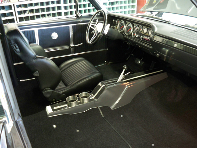

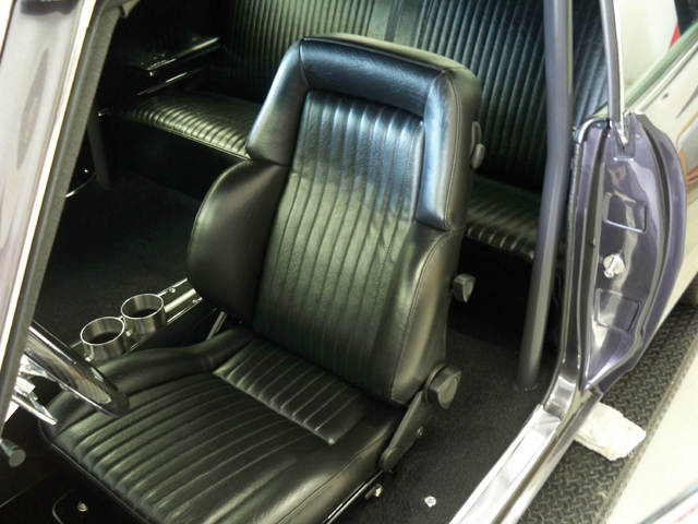

well, changed the iso setting and the camera is fine for me now. Took a couple of pics of the Recaro drivers seat; still waiting on the passenger bracket. This was the first thing in a long while that bolted on without mods, amazing. :faint:
I had Shawn Katt with Gearhead Garage recover them to match the rear seat. At the time we were doing an old-school look so I had him remove the headrests, but after Power Tour I'm going to have them put back on.
Thanks again to Terry at Griffin Motorwerke for the brackets (also where I bought the seats). Something fit............... :thumbsup:
http://www.camcojb.com/temp/malitude 680.jpg
http://www.camcojb.com/temp/malitude 681.jpg

awr68 05-15-2008 06:14 PM
Coming together nicely! Do you have a removable harness bar?
camcojb 05-15-2008 06:18 PM
why yes I do................. and it even clears the seat!!!!!!!!!! :thumbsup:

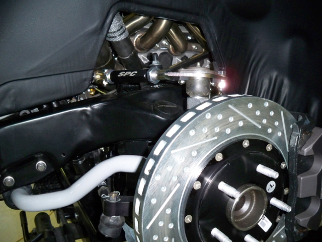

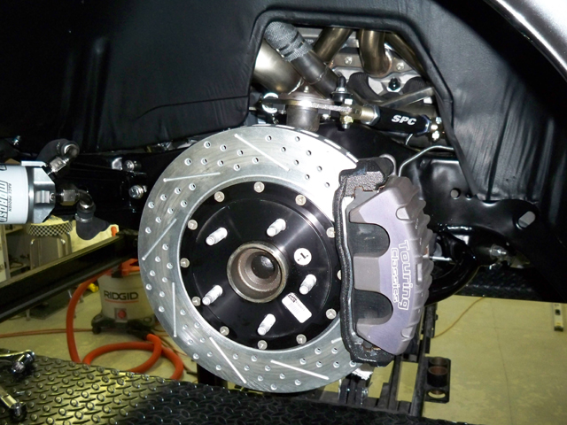

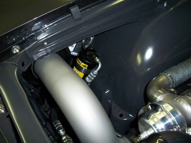

camcojb 05-18-2008 10:11 PM

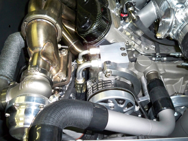

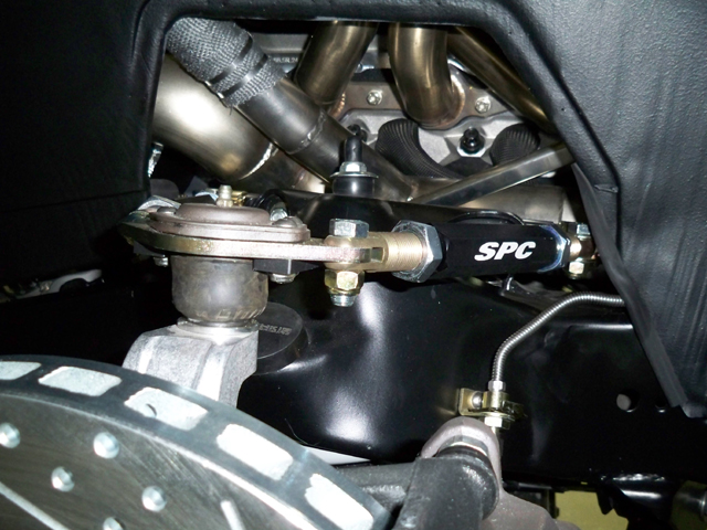

well, finished up the a/c lines the other day, and replaced my Hotchkis uca's with some from Mark at SC&C. Needed Marks as I had no room for camber adjustment with the downtubes from the turbos. Nice stuff, did a quick alignment and will finalize when the wheels and tires arrive Wednesday.
http://www.camcojb.com/temp/malitude 682.jpg
http://www.camcojb.com/temp/malitude 686.jpg
http://www.camcojb.com/temp/malitude 683.jpg
http://www.camcojb.com/temp/malitude 684.jpg
http://www.camcojb.com/temp/malitude 685.jpg
BRIAN 05-19-2008 09:29 AM
Is there a crossbrace on that upper control arm that hits the bumper at full drop? Just asking because I had a similar set on a 1st gen F and I had to relocate bumpers to work.
Car looks sharp. Put small front and rear headrests it will look stock and save your neck in rearended.

camcojb 05-19-2008 10:55 AM
no interference on this one, but I think Mark had modded the frame area for clearance before I got it.
The headrests are going back on after Power Tour.
7TSS 05-19-2008 11:22 AM
I think he's referring to the bump stop for the uca at full suspension droop.
I believe that the SPC's don't have any provisions for the bump stops.
Btw the build is simply bad@$$. Can't wait for the wheels to get there so we all can see it completed. I know alot of us are following this build closely and are just as anxious as you LOL.
camcojb 05-19-2008 12:50 PM
I used the bumpstops off the Hotchkis arms; they bolt under the ball joint, worked great.
Thanks for the nice words!
awr68 05-19-2008 04:36 PM
Congrats on getting her done in time big guy!! We were all pulling for ya!! :cheers:
Did you crimp all the a/c line ends yourself? This is something I have to do and my local parts store doesn't do it anymore.
camcojb 05-19-2008 06:51 PM
yes, I was able to borrow a tool to crimp them, so I cut them to length and crimped them myself.

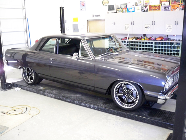

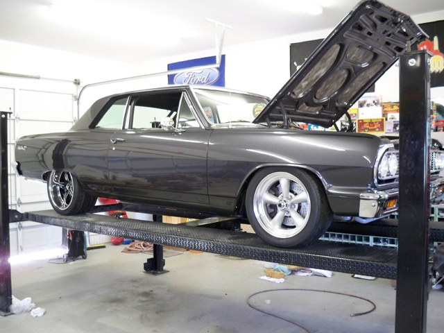

camcojb 05-20-2008 05:30 PM

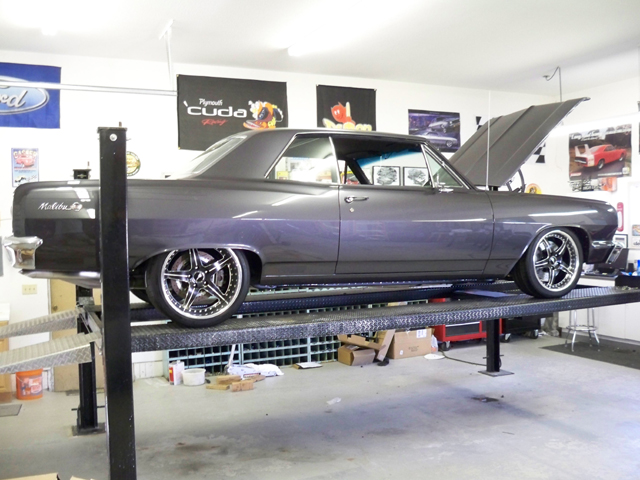

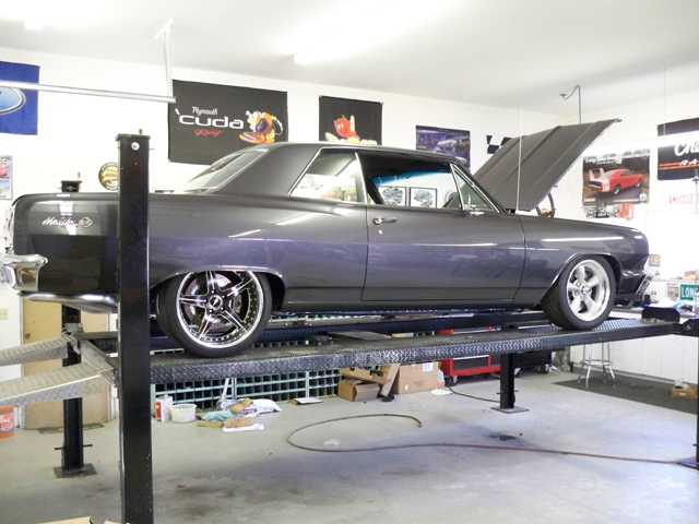

tires and wheels showed up today. Let me just publicly thank Frank from GP Superstore and Scott from Forgeline; both went out of their way to take care of me, excellent communication throughout. It was a pleasure.
Here's a couple pics. I will take some nicer outside pics probably tomorrow, I need to re-do the alignment before taking it for a spin.
Here's the first wheel/tire mounted with the original wheel/tire combo up front.
http://www.camcojb.com/temp/malitude 690.jpg
http://www.camcojb.com/temp/malitude 691.jpg
Here's all four new wheels:
http://www.camcojb.com/temp/malitude 688.jpg
http://www.camcojb.com/temp/malitude 689.jpg
Majority of you wanted a more modern wheel, what do you think?
badmatt 05-20-2008 05:32 PM
very slick jody. I do like the new ones but the oldies wore into me
Autokraft 05-20-2008 05:41 PM
Jody, those wheels have Badass written all over them. Excellent choice:thumbsup:
Rybar 05-20-2008 05:52 PM
WOW Jody, those wheels are badass! Nice score :thumbsup:
c.schulz 05-20-2008 06:01 PM
Jody,
For a guy thats been thrashing putting a car together thats one clean garage!
The wheels look killer by the way. Hey, and good luck on the Tour. Hope that all is smooth.:thumbsup:
Chris
Ummgawa 05-20-2008 06:04 PM
I just sharted. That is beyond Bad Ass.:thumbsup:
96z28ss 05-20-2008 06:14 PM
I think the more modern version makes the car mor badass.
I don't like that they are black. I think a more gunmetal color would look much better.
Time was an issue and you got a set of wheels in record time.
After power tour you should play with photoshop and try a gunmetal color on them.
